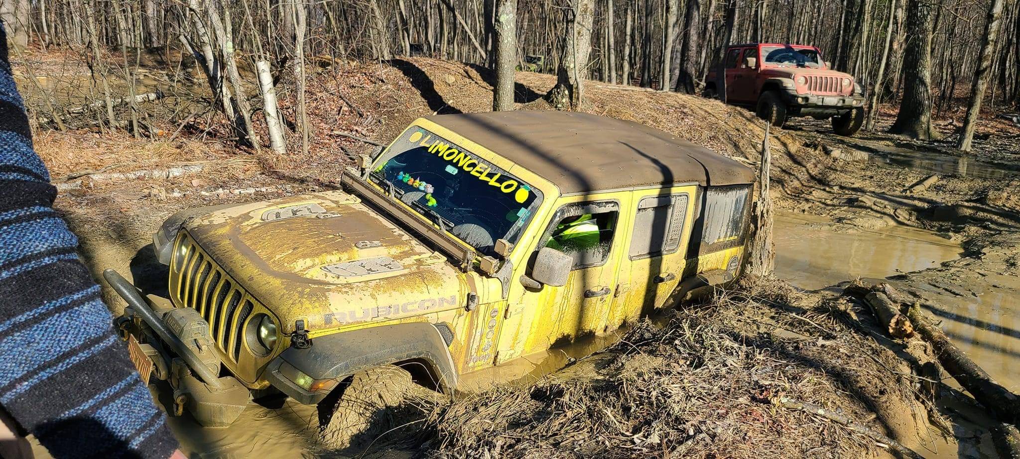

Good morning everyone. Wanted to share my yellow brick. Mid life crisis and wonderful pleasure.
9.1.22 went into the local dealer and ordered a 2023 JLU Rubicon the way I wanted, knowing she wouldn’t stay stock for long. She was delivered 49 days later. I won’t bore you with all the bad that followed for the length of ownership.
But, I will share with you all the positive to her build.
She sits on 4.5” Core 4x4 Tier 3 rock crawler adjustable suspension. Including the aluminum steering. She sits on 37” MT Baja Boss A/T, Tom Woods front and rear driveshafts, and the newest to the build is my MetalCloak UnderCloak skid plate system that I’m dying to get some use out of.
Regeared to 4.88 with Revolution gears.
She has OPT7 rock lights, my speakers are RGB to match the inner lights that change color.
went with Alea leather. Front and rear seats, center arm rest all match. Including the seat pull straps and shift boots are also stitch matched. Even installed rear heated seats. All the interior has also been HV paint matched myself.
And then lastly is my 4800 watt upgraded stereo. Running at just over 2500 watts RMS. Hertz Audio and kicker combo stereo.
3” dash, 6.5” knee panel and sound bar and the 8” full range pods firing outward. (2) 12” kicker Solobaric L7S running each at 900 watts RMS.
Have a great day everyone.

How do you like the Mickey Thompson ATs. I currently have the MT but thinking going AT they have much better siping. And nice jeep you have put a ton of work into it.
They are wonderfully quiet. On the road or the highway.
offroading those sidewall grips are incredible also. I run at 31 psi. Just an awesome tire.

Love the ride.
two of the things that standout to me are the matching paint underneath and the stitching pattern on the seats. Really impressive work.

Love the ride.
Thank you. The suspension had an option of 10 colors. But the MetalCloak diff covers, I taped and painted with matching code spray paint myself.
I tried to be different with the leather seats.
