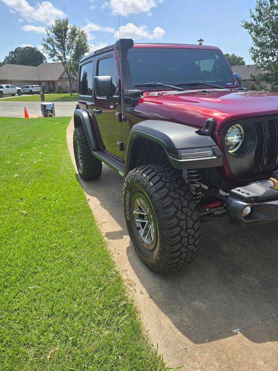

I just added Rubicon led fenders to my 2021 sport S. I am having trouble figuring out the setting on the tazer.
DRL type Canada
DRL loc Dedica
LED front turn
When I see other jeeps in town the white DRL are alot brighter than mine. Is there a setting I am missing?

Can you post a picture of the Jeep with thew new LED fenders?
