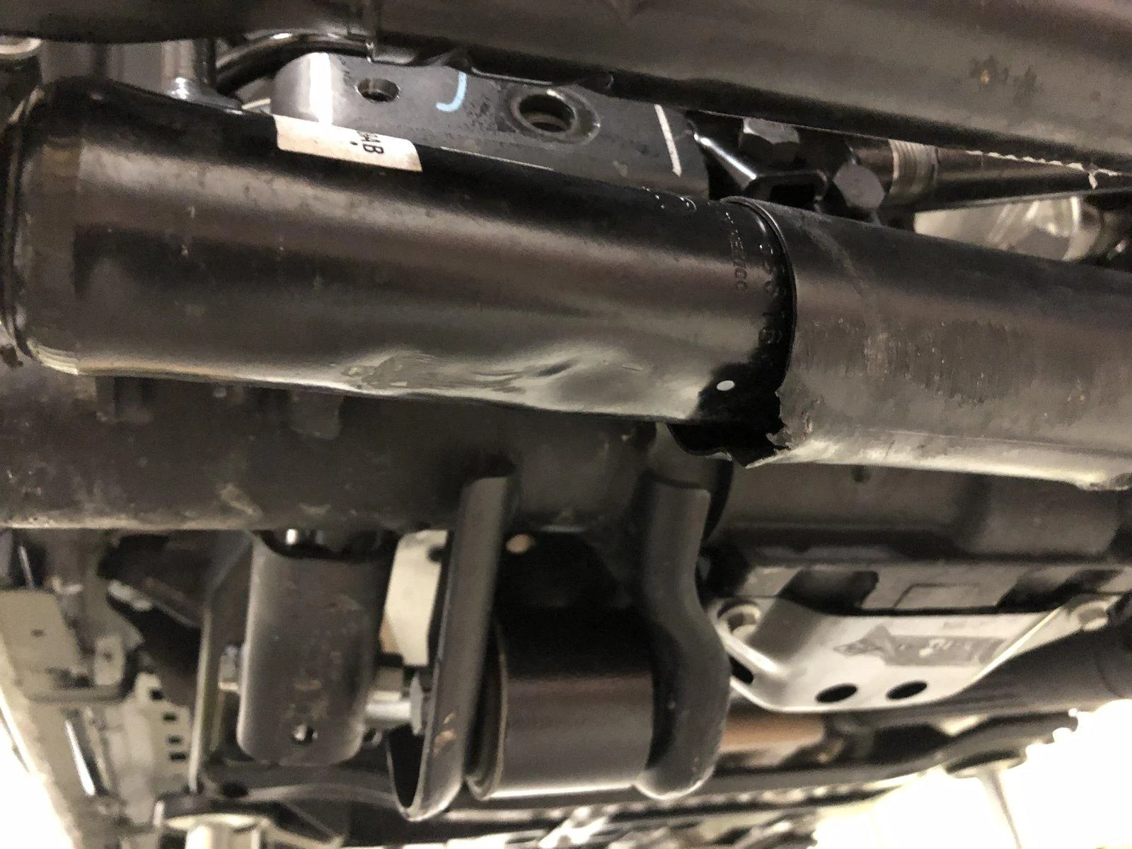

I wasn't happy with how low the stock steering stabilizer was placed, as it was extremely susceptible to trail damage and mine had the scars to prove it:

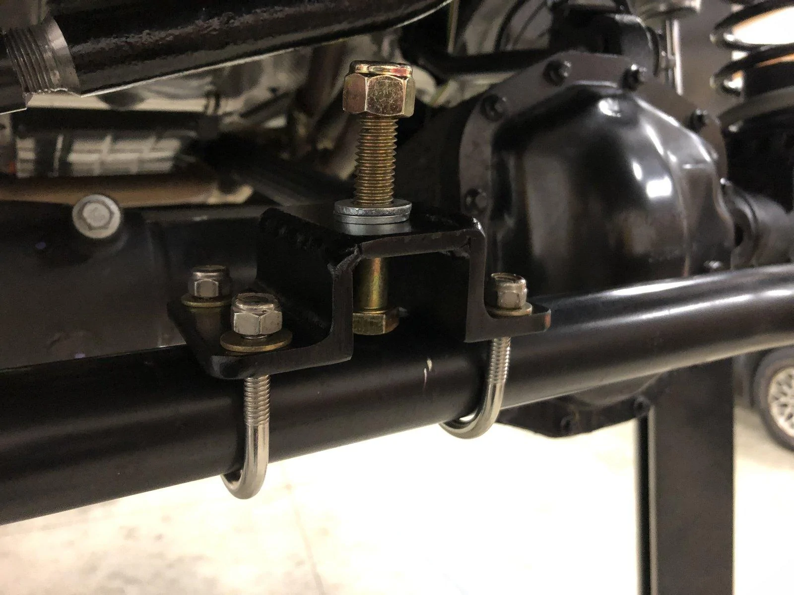

So, having done something similar on a couple of our JK's over the years, I spent a few minutes and fabricated a couple of relocation brackets to get the stabilizer up and out of the way:

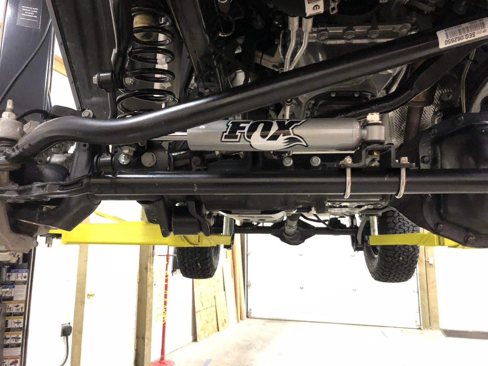

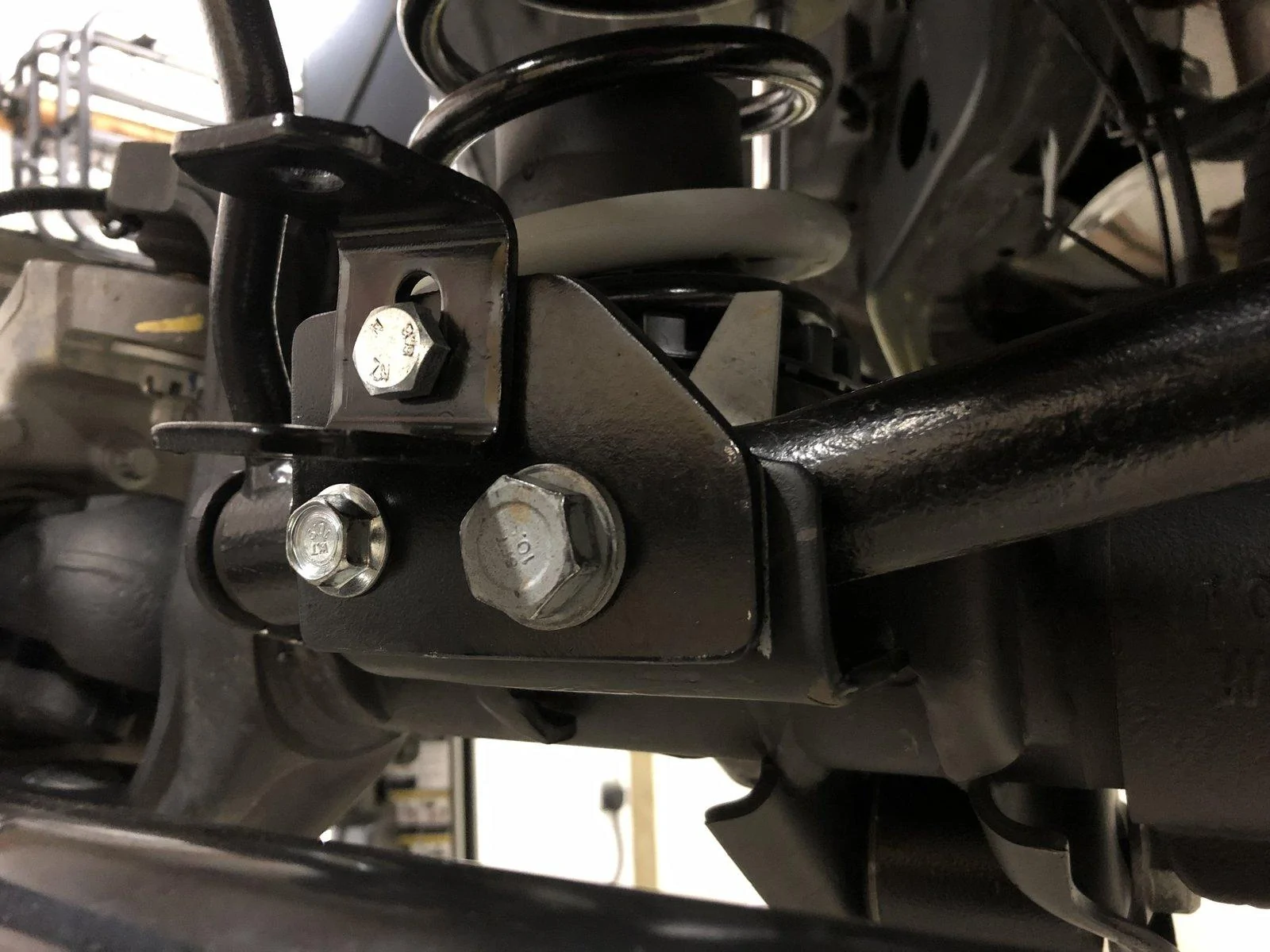

And here is the finished product:
