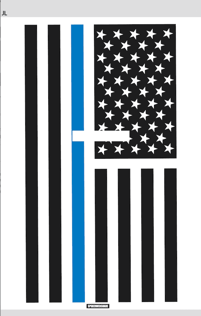

Just ordered a custom printed top and they are extremely helpful and make it super easy! :clap:

Still debating on getting their Texas flag design this summer or just waiting for next spring.
Just do it! I've been running their shades on my JK for years and really love them! And now that you can get just about anything printed on them, they are even more cool! :like:

How much more did u pay if u dont mind sharing?
They quoted “JL4D = $299.99, plus $11.99 shipping.” For Custom printed tops. They also said they’re currently doing $30 off for JL custom prints.
