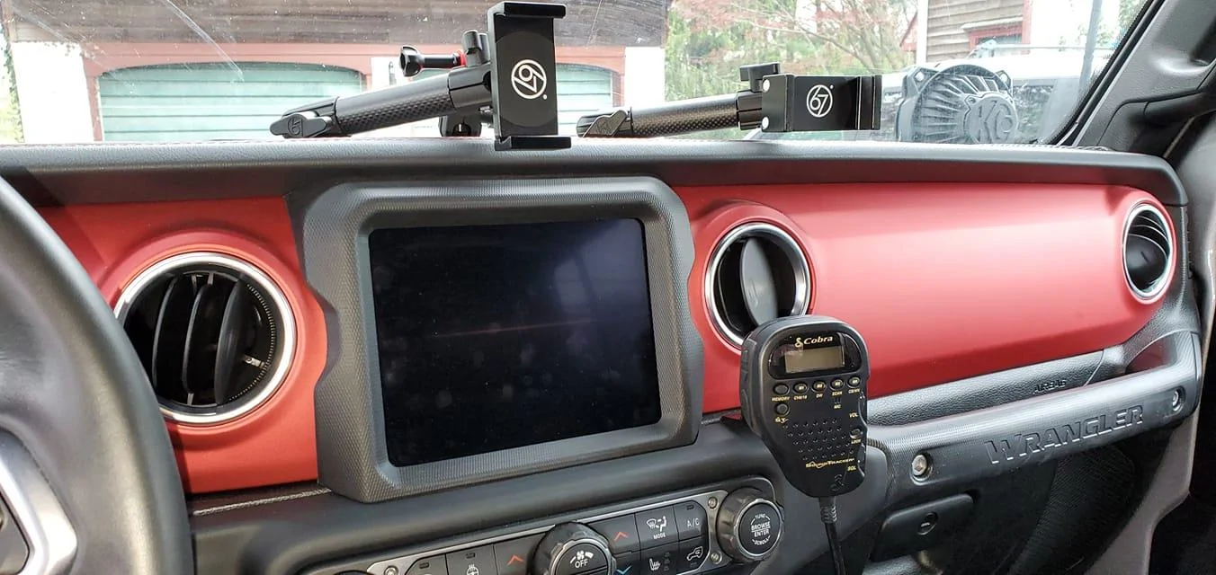

What are you currently doing for CB? Here's my setup:
Jeep Wrangler JL Southeast PA - CB Help cobra_mount

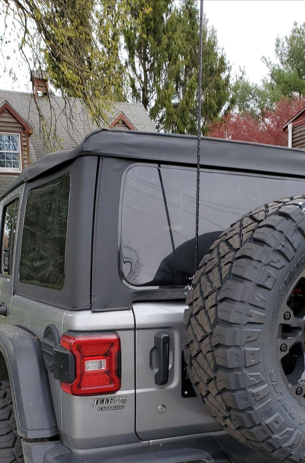

I have a 4' firestick on my Rusty's tire carrier
Jeep Wrangler JL Southeast PA - CB Help 20200514_132438

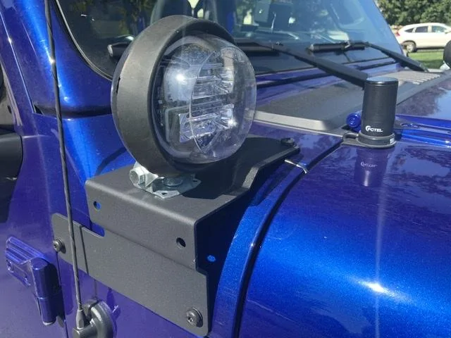

Nice. I'm curious how you do this in a modular way. Do you have pics? Are you mounting your antennas up front or using the same coax? I appreciate your help.
I have the Mopar A Pillar light mounts for my warning lights and I use the open flat space Next to the light for the mag mounts. I install which ever one I‘m going to use. For CB I have a Midland 75-822
