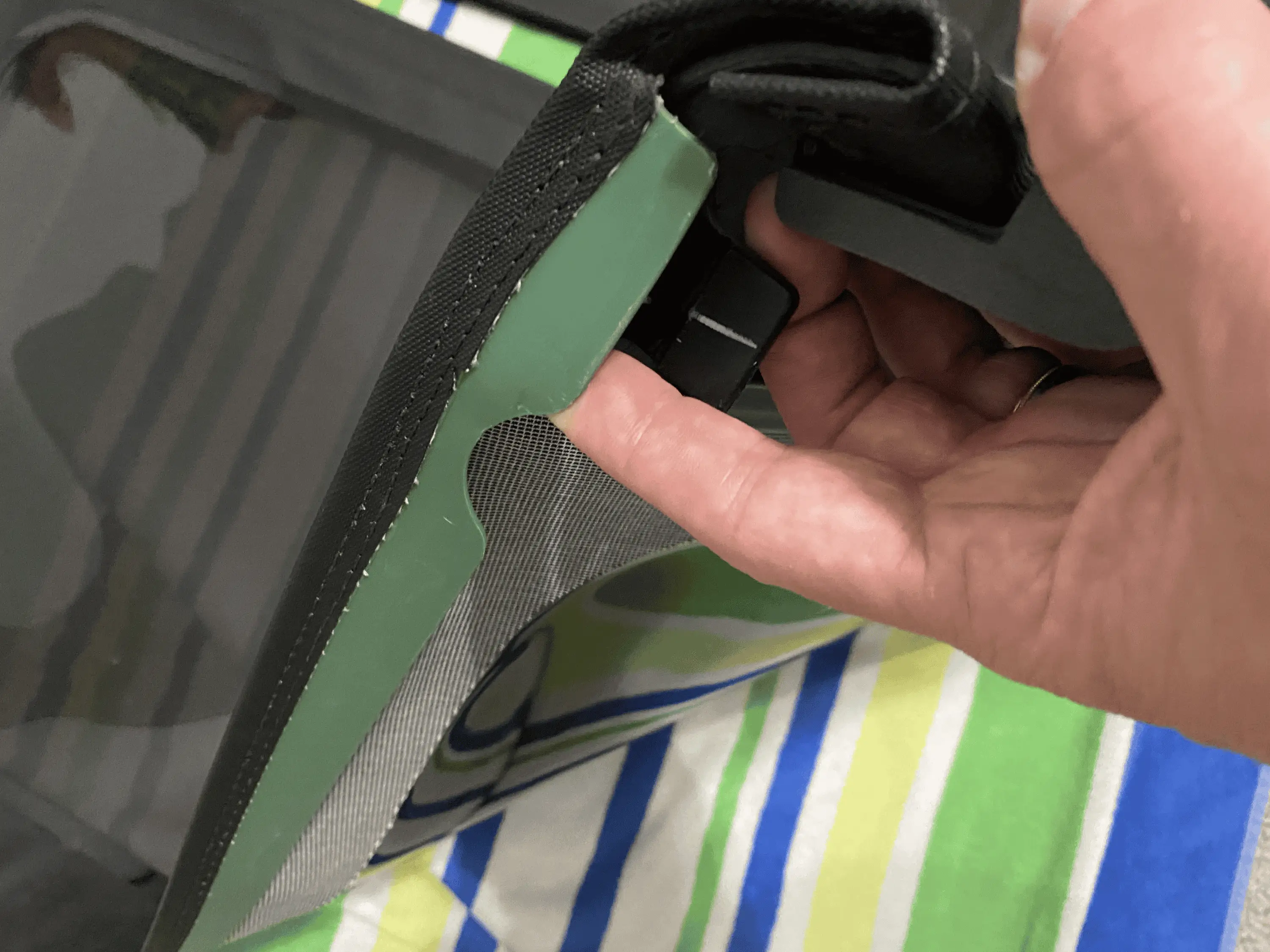

I have a soft top as well
There is absolutely no way you should see that gap between the soft top and body. There is a second plastic tab that goes under there to keep it watertight. I haven't had my soft top on in a year, but that gap isn't supposed to be there. Below is a picture of my soft top tabs the one under my pinky goes into the corner. Everything locks in tight.
I'm glad you posted that picture, it was exactly what I knew wasn't in place.

Another thought here, I bought my hardtop used and the plumbing and electrical aren't connected. It looks like your window washer line is crimped under the corner plate. That doesn't seem right to me. It seems like it should be routed through the same opening as the electrical.

^^^^ This.
The washer hose should not be under the corner bracket like that. In itself that’s causing some alignment issues with the corner piece.
‘Mine take a palm thump to get the corners to pop out when removing the windows, if yours are held in purely by the tension from the rear window something isn’t right.
Yeah, it is a pronounced palm-thump to get them out. Mine don't just slide out by any means, it is a deliberate act to get the clip to release.
