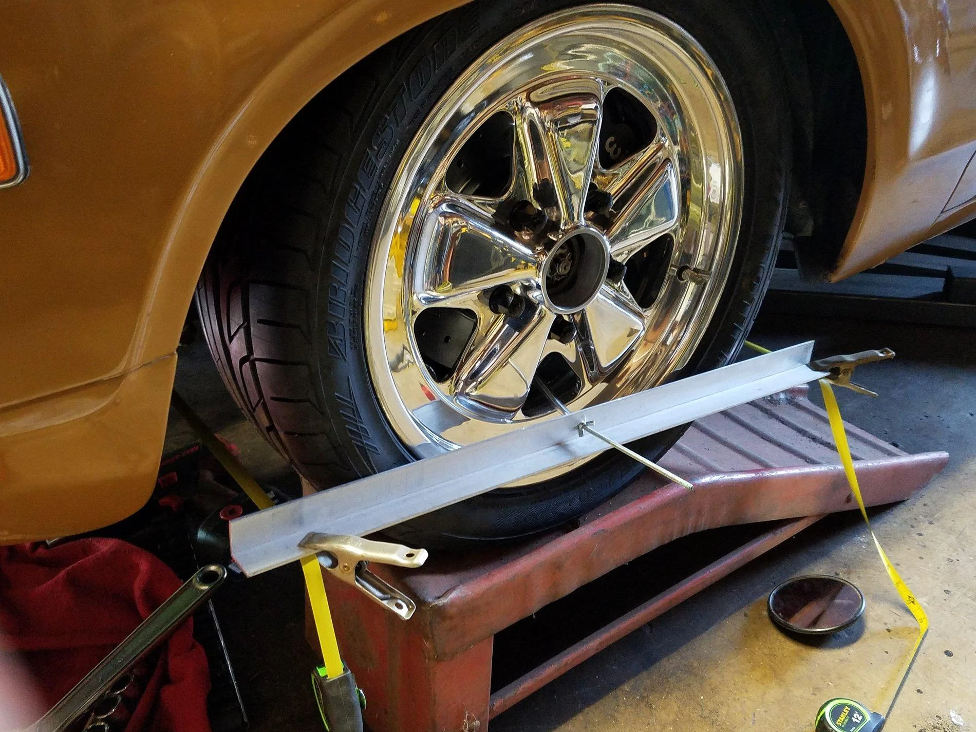

Sorry, it's not a Jeep picture (it's one of my other projects), but this is how I align toe. A simple piece of straight metal on both sides of the vehicle. It's easiest if you have two people (one on each side). Measured at about 30-33" apart, adjust the toe so the difference in measurements is your toe. If toe in, the front measurement will be slightly less.
Since I did this solo, I had some simple "J" bolts holding the aluminum piece against the tire. It's not a perfect measurement, but I do this to get it close enough. Though every time I've taken a vehicle I aligned in my garage, the shop has always said that it's within spec, so I no longer take vehicles to get them aligned.
For my Ram 2500, I have a couple aluminum bars drilled so that I can bolt them directly to the hub. This takes the possible tire variable out of the way.

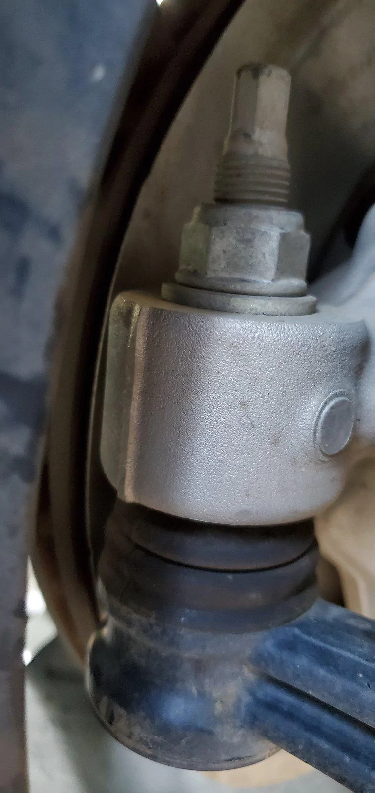

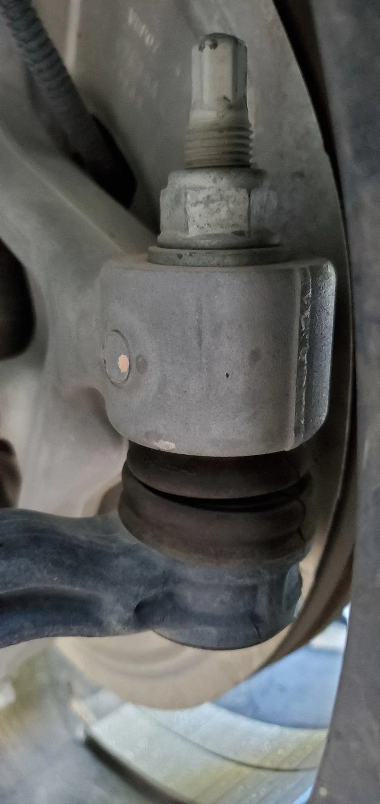

I see there's different ways to do it but what about using the starting point off of the knuckle while stock tie rod is in place, I'm not lifting vehicle.
