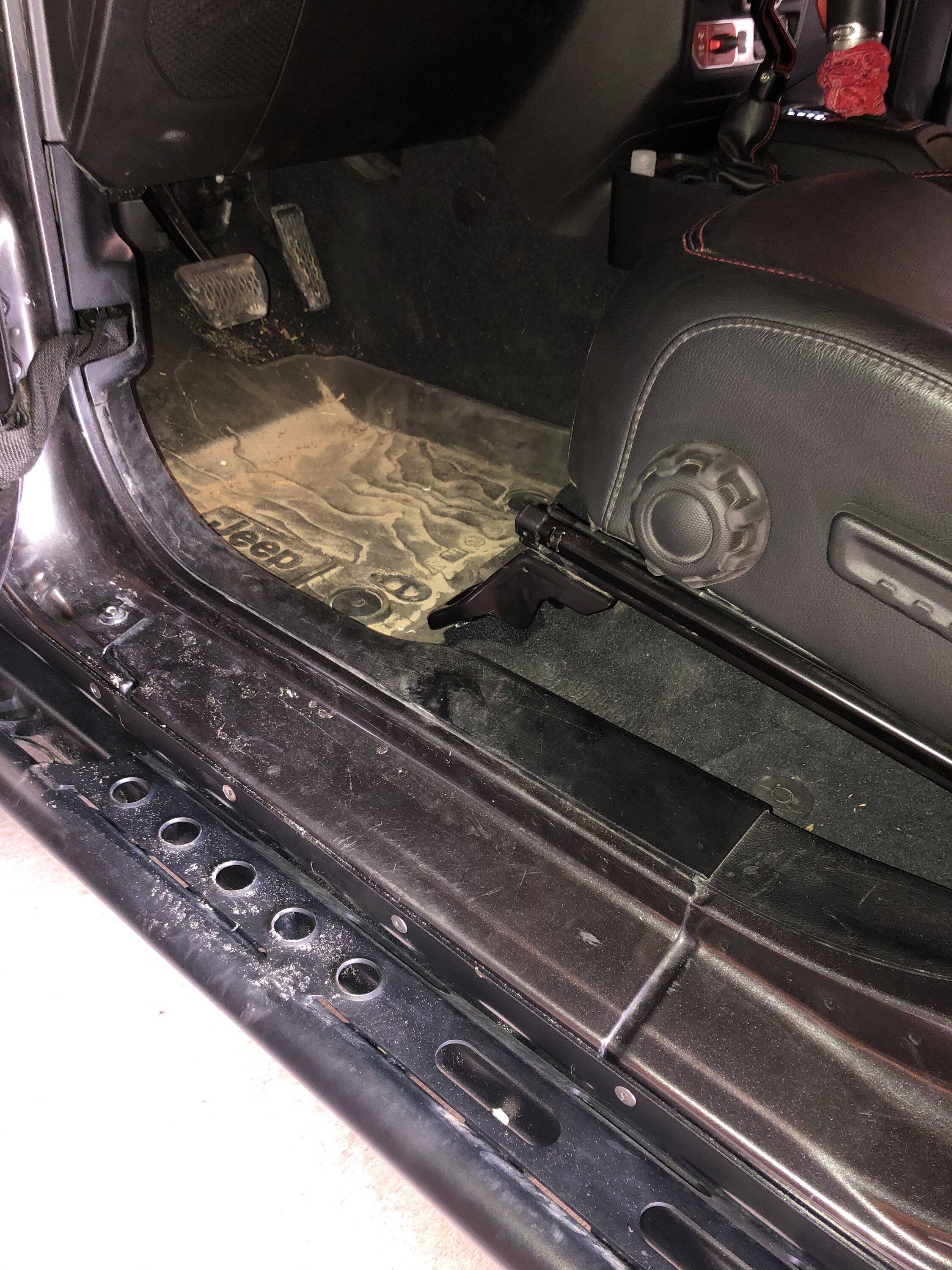

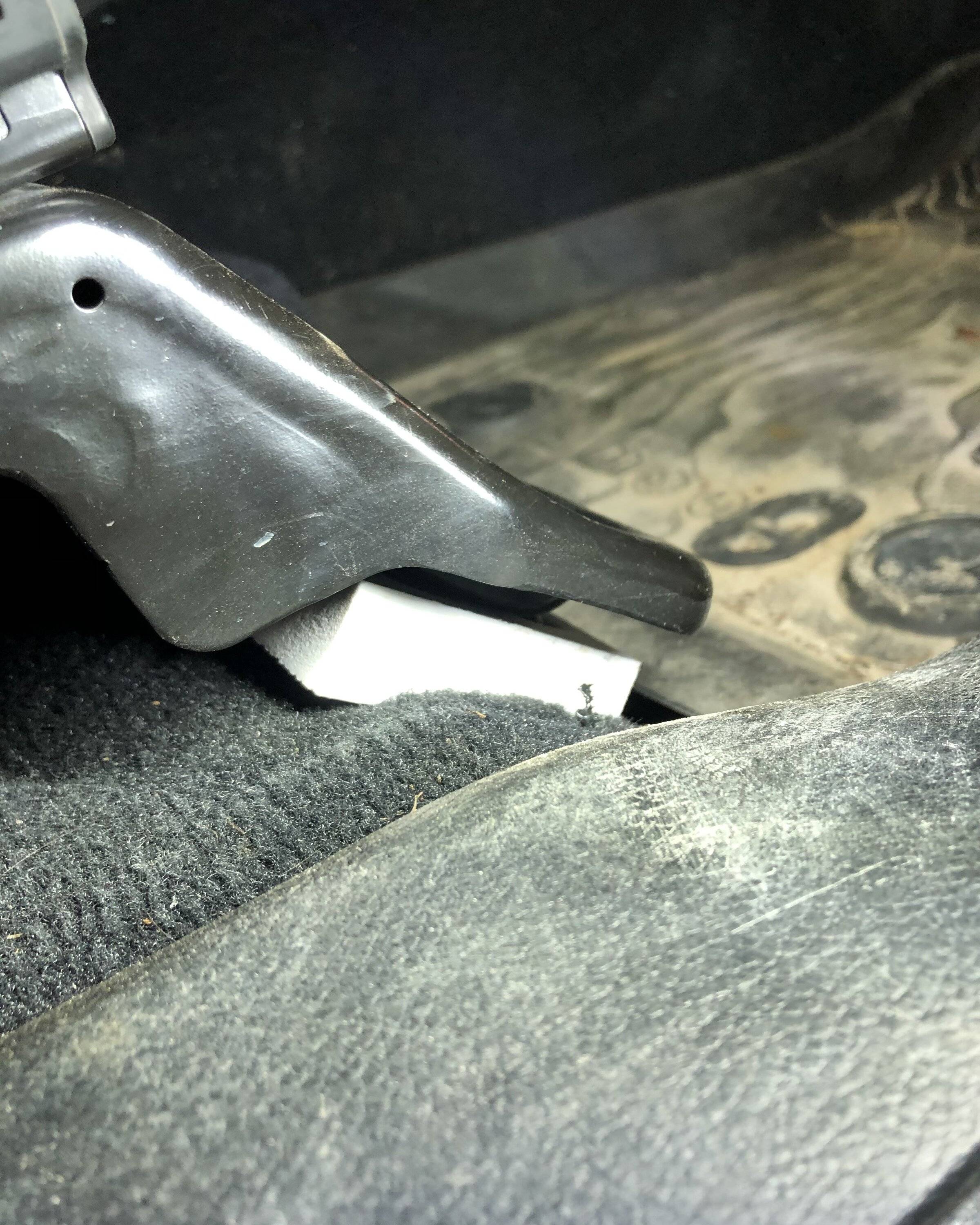

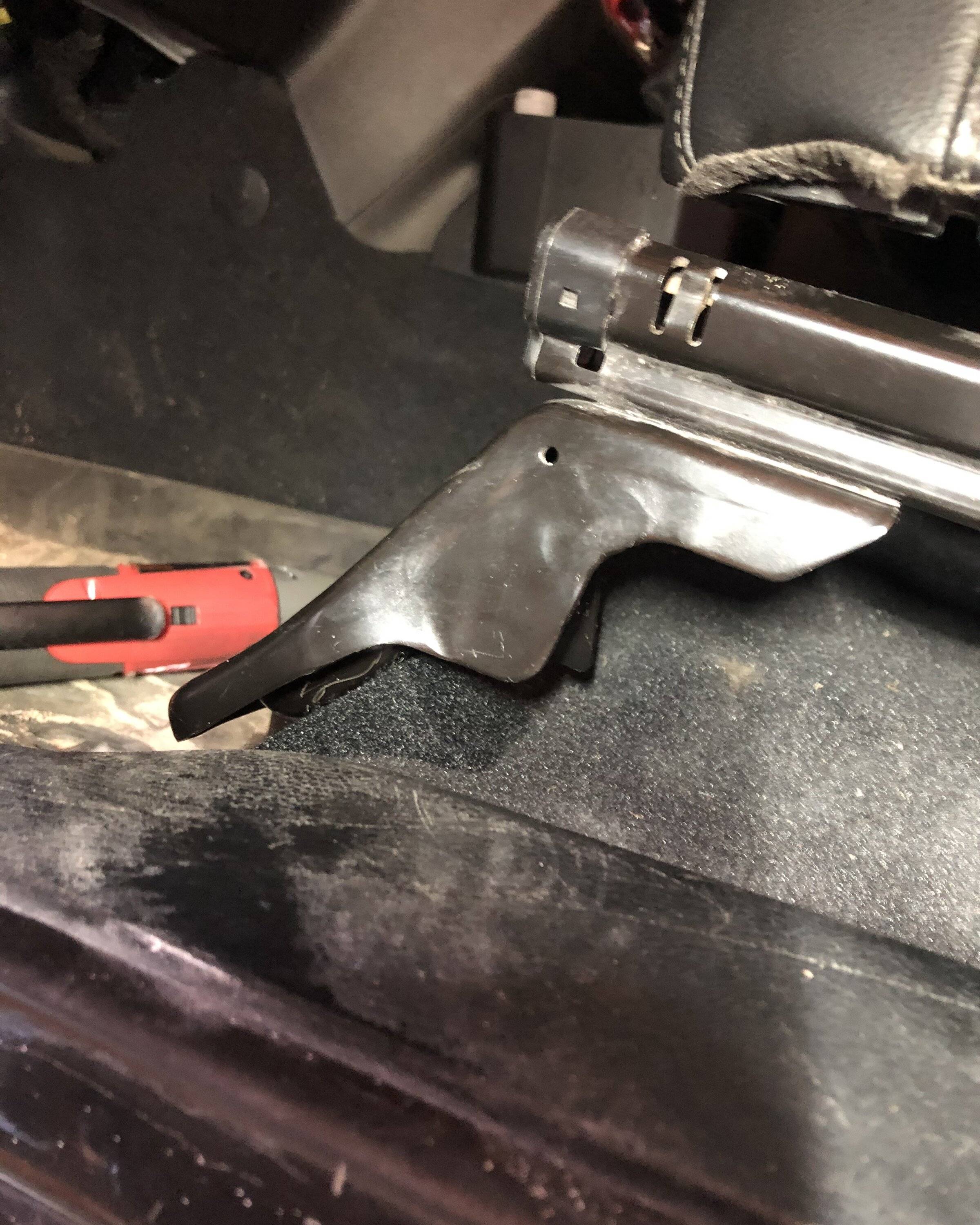

I have the Seat Jackers and they definitely improved my ride but I am 6’2” so not a lot of help. If you are handy or have some close that is handy, you could fab a couple small blocks of wood to simulate the feel.
I’m not saying drive around with them but loosen the two rear bolts and remove the front two bolts enough to slide the wooden blocks and sit in the seat and see how it feels before investing in the Jackers as you know, are not cheap and I don’t think they are returnable IIRC.

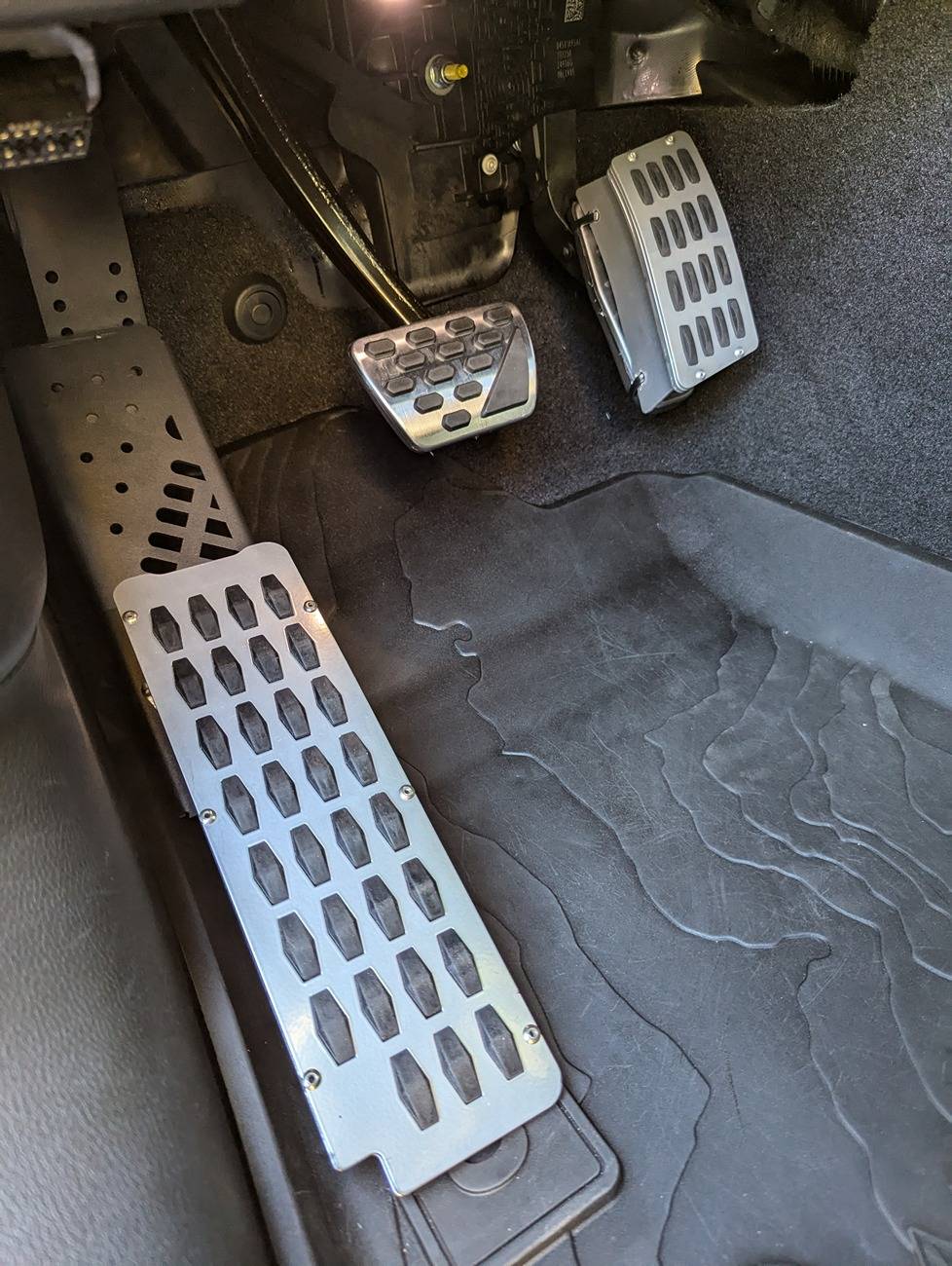

Well I decided to go a bit different route and finagled this together. The dead pedal was still too far back so I added a second LOL. It's a little janky maybe but I was definitely more comfortable driving on my little test drive tonight. If I start noticing issues I might give the shorty blocks a shot.

Never seen a gas pedal spacer before. I guess I haven't been around enough short people? :LOL:
