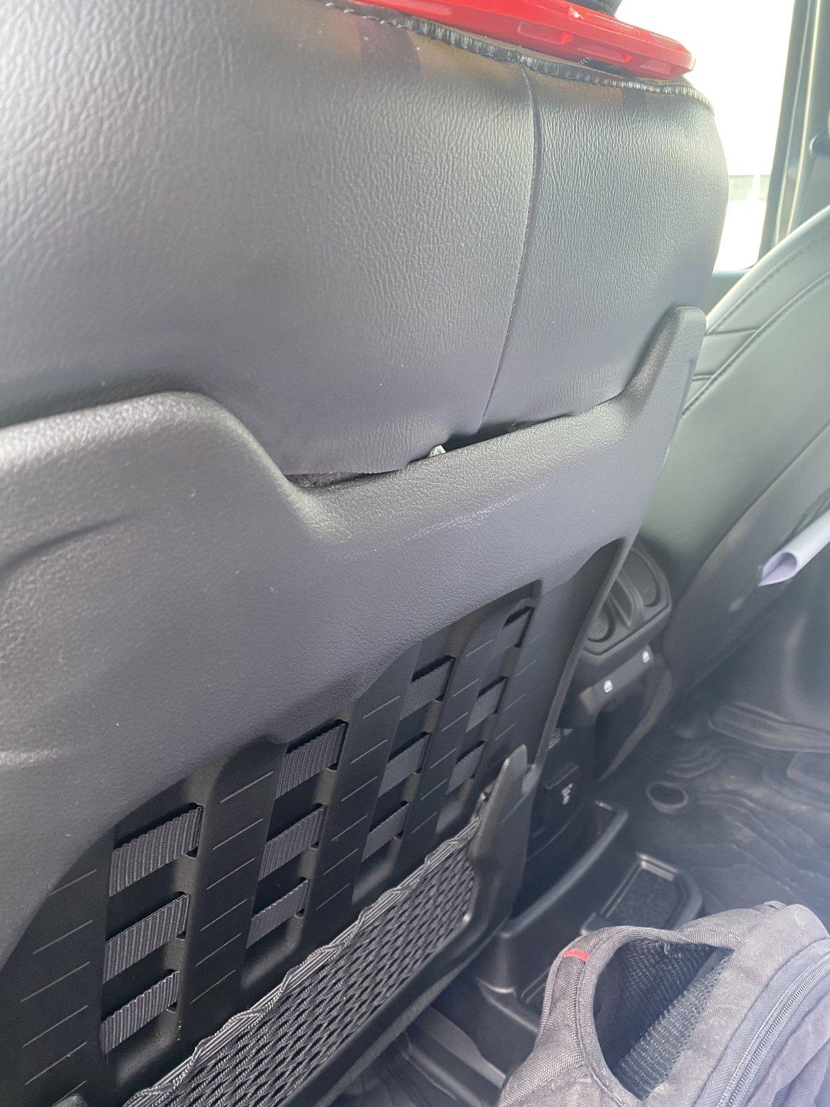

Hi everyone,
just bought a wrangler JL rubicon two months ago. I faced two issues till now:
1- this issue i am wondering if someone faced before regarding the driver seat cover as attached.
Jeep Wrangler JL Seat cover issue 6D01CF37-CE5A-480E-AC81-E06E8570D1EA
2- was the auto rear diff lock connect by it self and solved by changing the rear axleafter driving about 1500 km today i reached 4200km

Yes, I had this issue and the dealer fixed it. I’m not sure what dealer support is like in Saudi Arabia, if you have issues and are handy, there are two possible problems:
1. The top plastic clips on the plastic backing piece are broken
2. The 2 bottom screws on the backing piece were never installed.
Both can be seen in this video, starting around 2.30.
if your plastic clips are broken, you’ll need a new backing piece, if the screws are missing, it’s an easy fix.
I tried to do it by my self just pushed it towards up but still loose, so i will figure out with my dealership here.
Thanks a lot that was helpful
