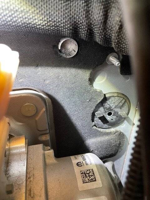

Looking to add hood lights and grill lights to my Sahara 4XE but cannot find an access point in the firewall to route the wires for inside switches. ?????

What would be the clutch pedal hole. You can just pop out the grommet.

Yup, clutch pedal hole. Plug pops right out. There's even a divot in the plug center to drill just the right size hole through it.
I routed a red 4ga cable through it. The plug has two tabs sticking out of it. This is right in front of the driver seat.

Thanks for the fast direction!
My '23 has a plastic grommet covering the access hole.
Easy drill thru and easy access below the dash panel.

Yup, pops in and out easily so you don't have to try to drill it out in place, makes it easier to route the wires, too.
