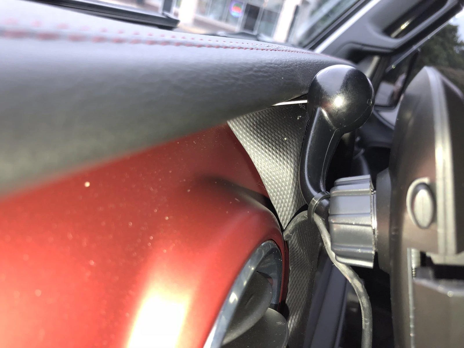

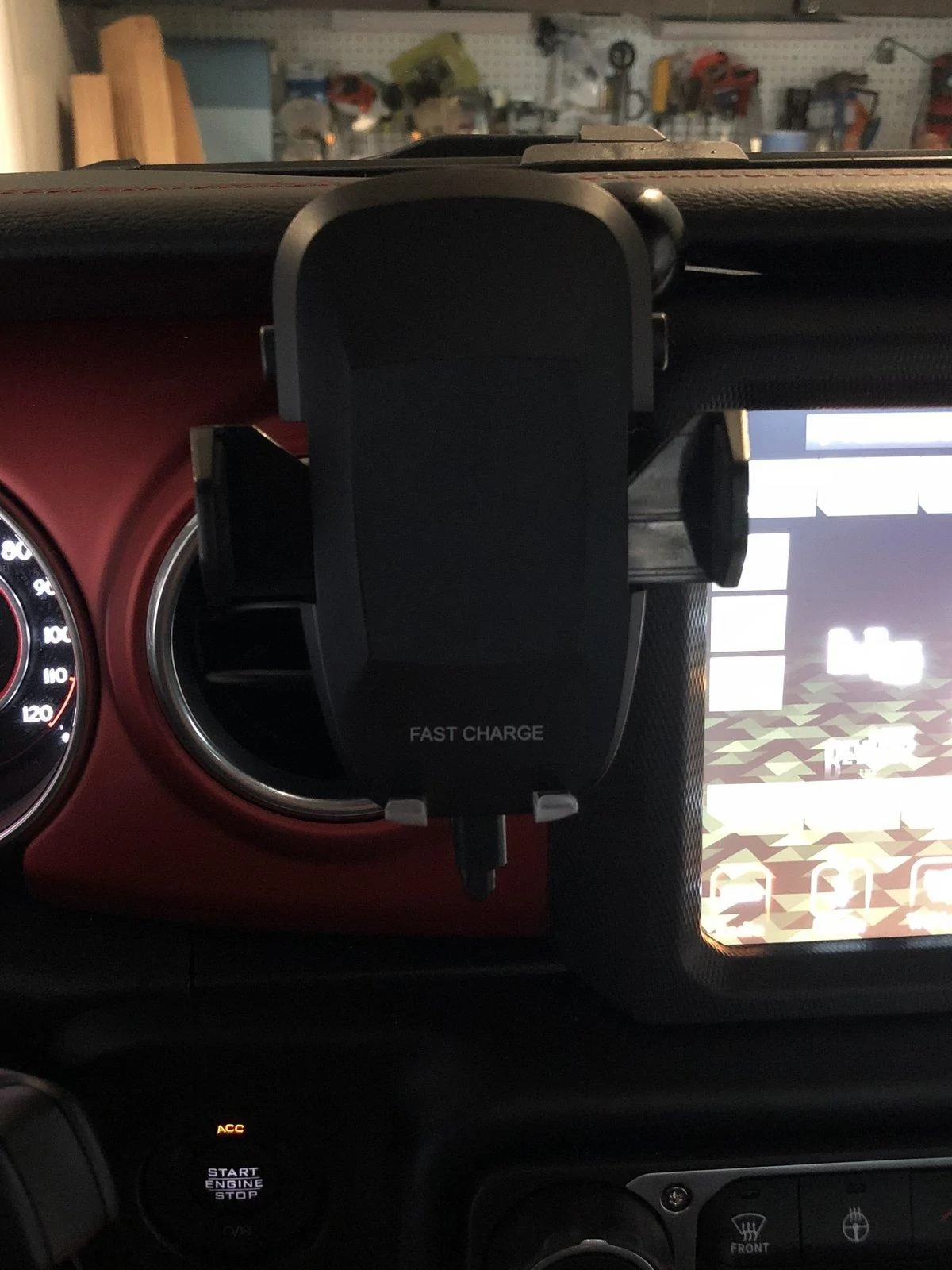

I did it yesterday. Carefully pull out the climate controls. To get to 2 screws on the bottom of the radio bezel. Then it can be popped off. Get a plastic trim removal tool for all trim pieces. take 4 screws out of the radio to run the wire and to mount the bracket. I picked up the wiring on the passenger side aux wiring. Hope this helps?

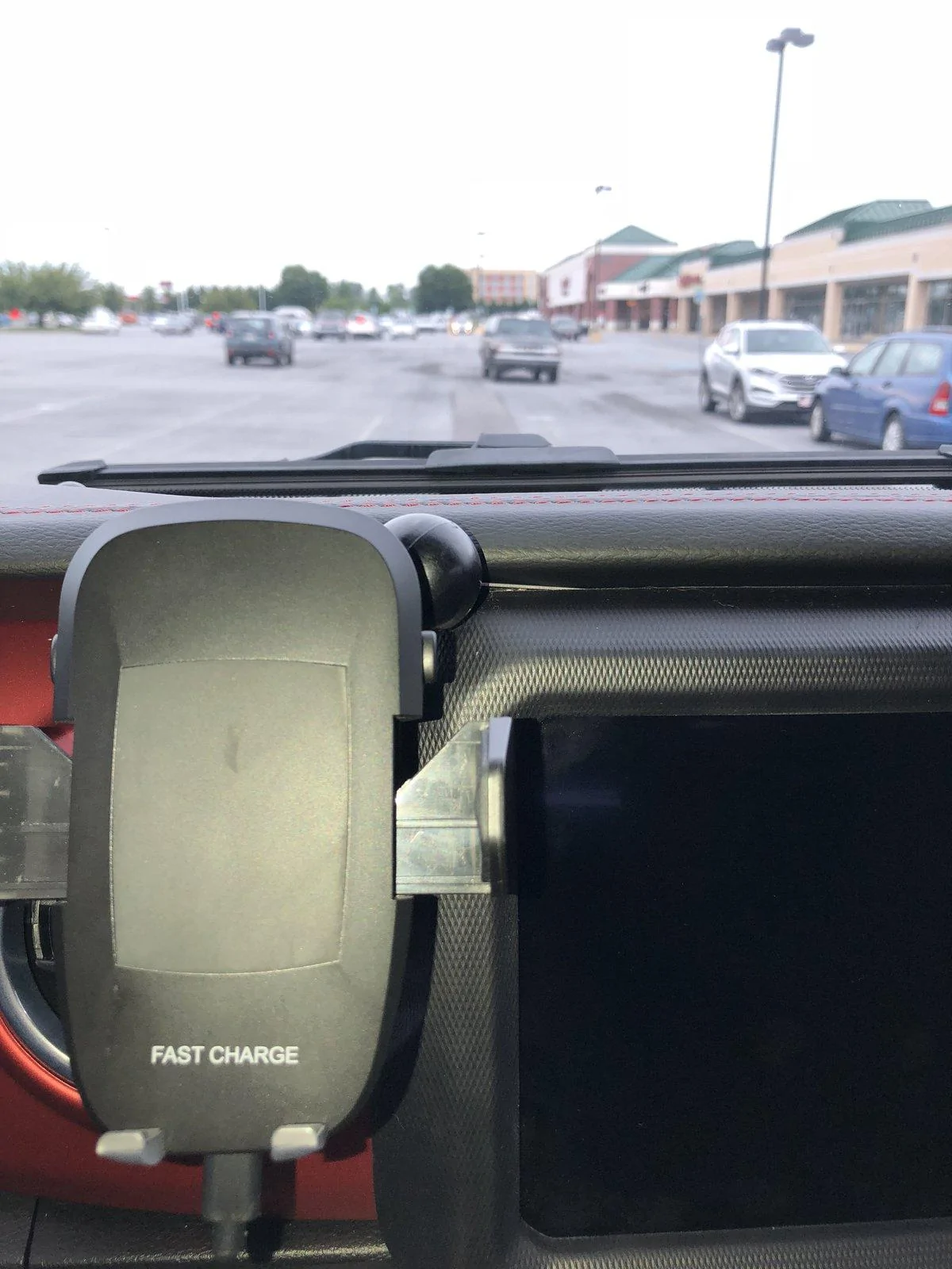

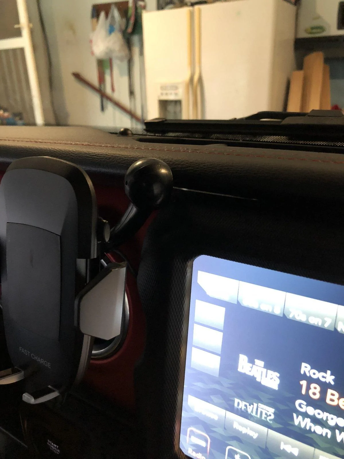

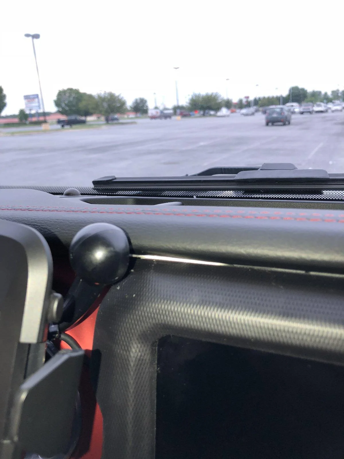

Thanks. When you get a chance can you post pics that are a little brighter? Where does the wire come out? I'm actually looking for the wire to come out above the radio directly below the windshield.

Hope these help?
