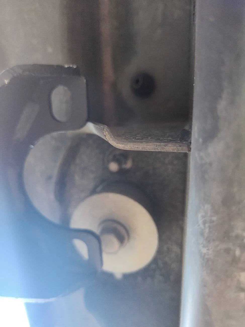

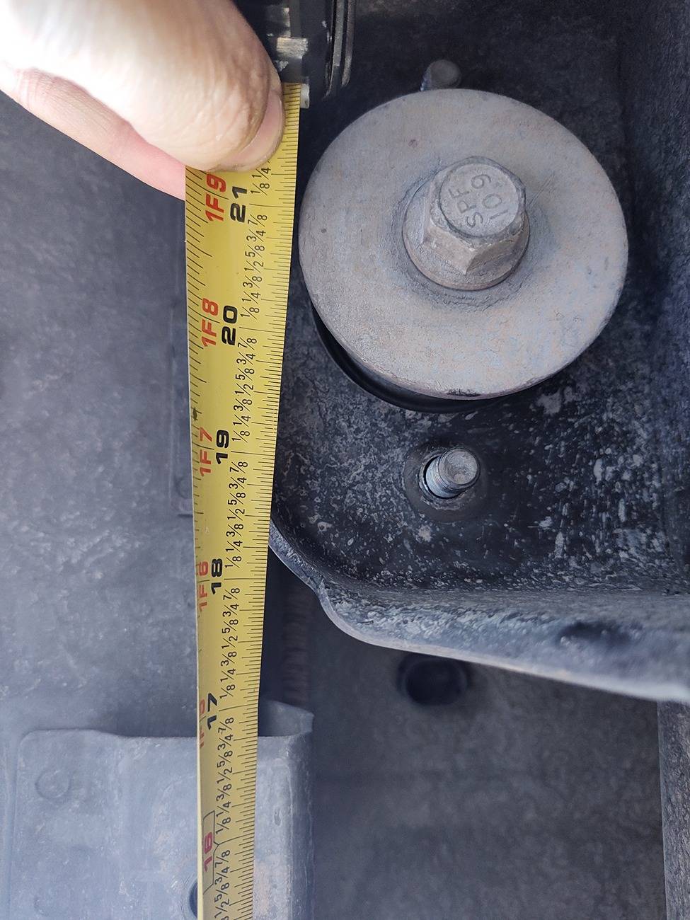

I got the rough country sliders (https://www.roughcountry.com/product/jeep-wrangler-rock-sliders-90801) as a gift, trying to install them this morning and having some issues, was curious if anyone else has run into this. The rear and center mounting plates holes are 15.5" center to center, the bolts they need to mount to are ~18" center to center.... you see the issue lol
I called rough country and sent them some pictures and video (attached here too) they said they are going to get back to me, thought I would check here before I start cleaning up tools and putting the factory rock rails back on the jeep.
difficult to get pictures and video while laying on the ground trying to hold the slider up and take video at the same time.

after I posted this, the forum recommended similar posts and one had the answer, all the brackets are labeled backwards in the instructions, the drivers brackets are really the passenger brackets, and same for passenger, those are really driver side.
I contacted rough country again and advised them of this and asked them to update their instructions to save future headaches.
