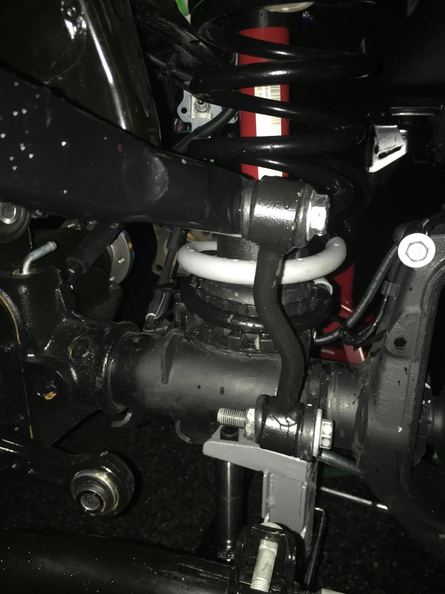

3) Step 11 clearly says torque upper sway bar link to 75ft/lbs which I don't think I got close too before deciding that was far too much. I had reviewed every video and guide multiple times to make sure i had placement and spacing right. I took it back apart to double check and looks like I may have already damaged the sway link. The bolt no longer slides out and you can see the the metal in there crushed. This may derail my whole install until I get this replaced? See pix below.

Got the sway bar on but read in later directions the bottoms are 55ft/lbs so I used that spec. Will be calling RC on monday to get a new sway link.

Got it done! Took closer to 10 hours and wasted and extra two cuz I was none too bright and removed the bolts for the control arms and not the listed track bar. That took some creative jack engineering to get that back together. Still not sure if I did damage to the sway bar bushings and crush sleeves torquing as high as the directions state.
