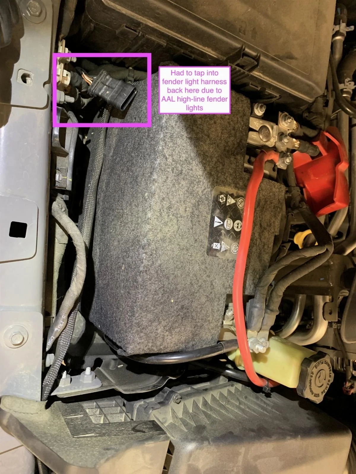

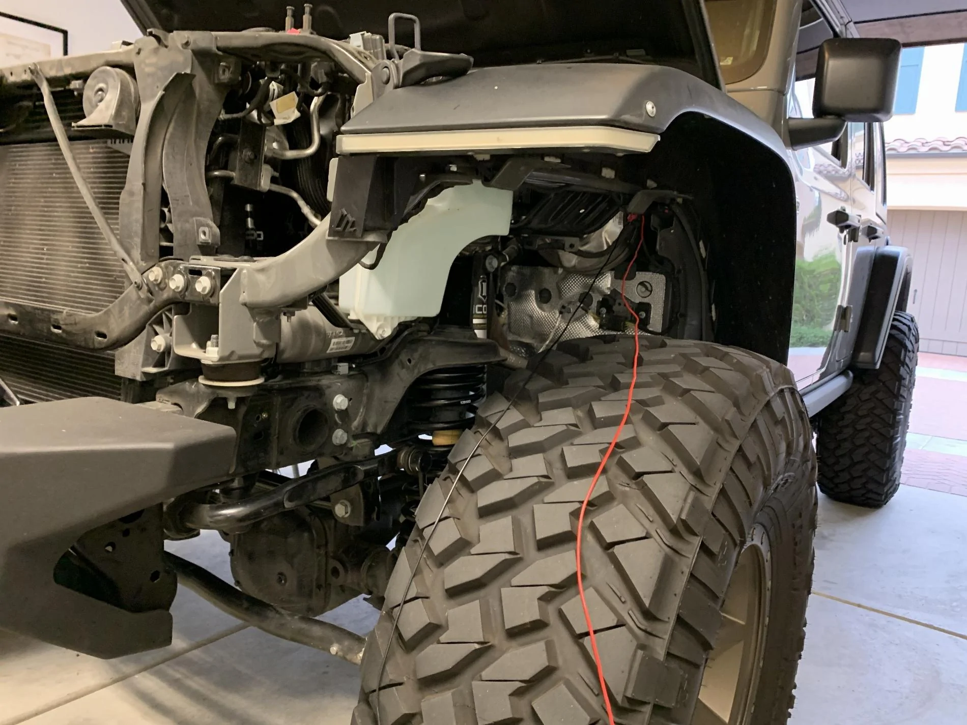

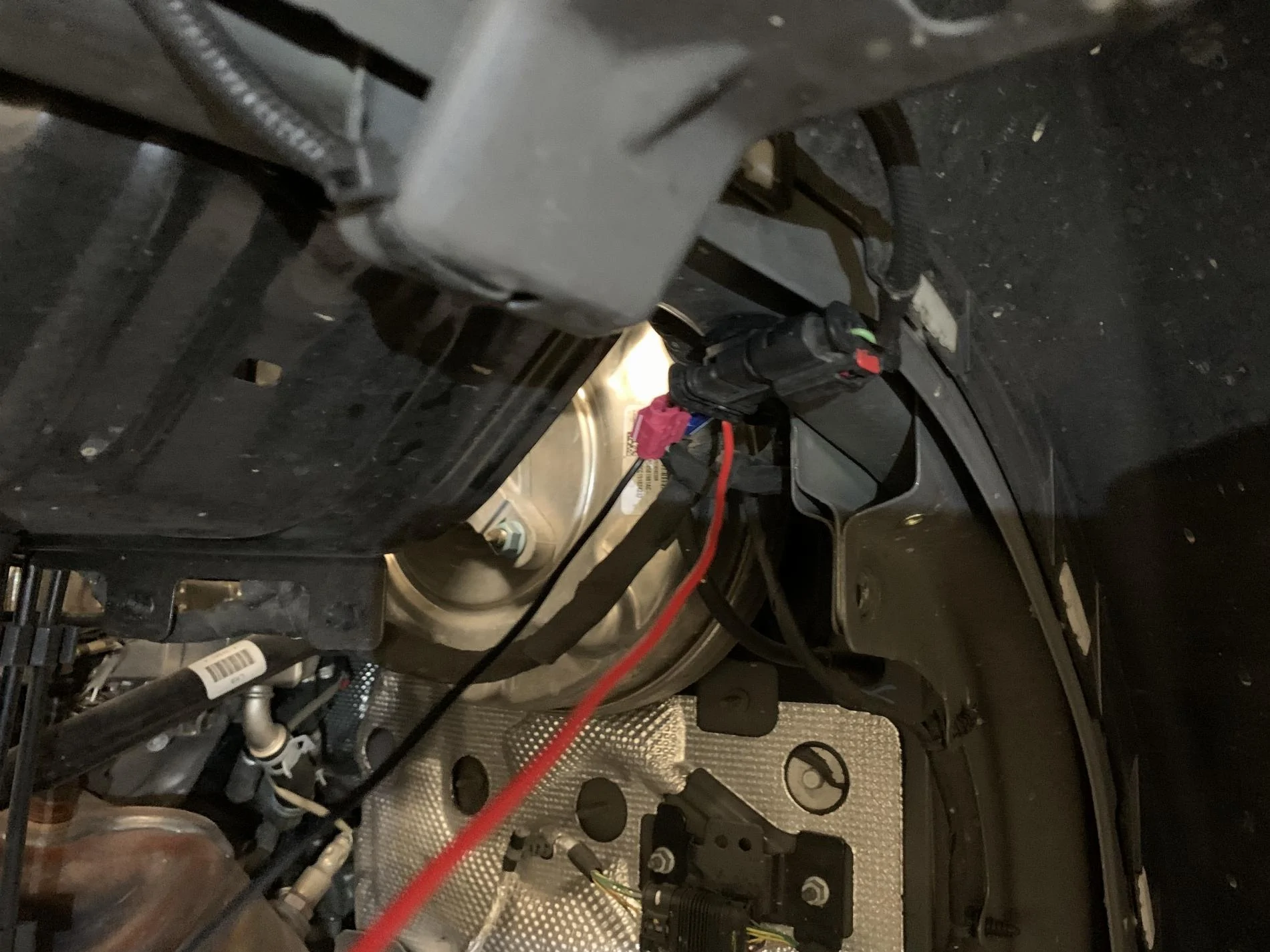

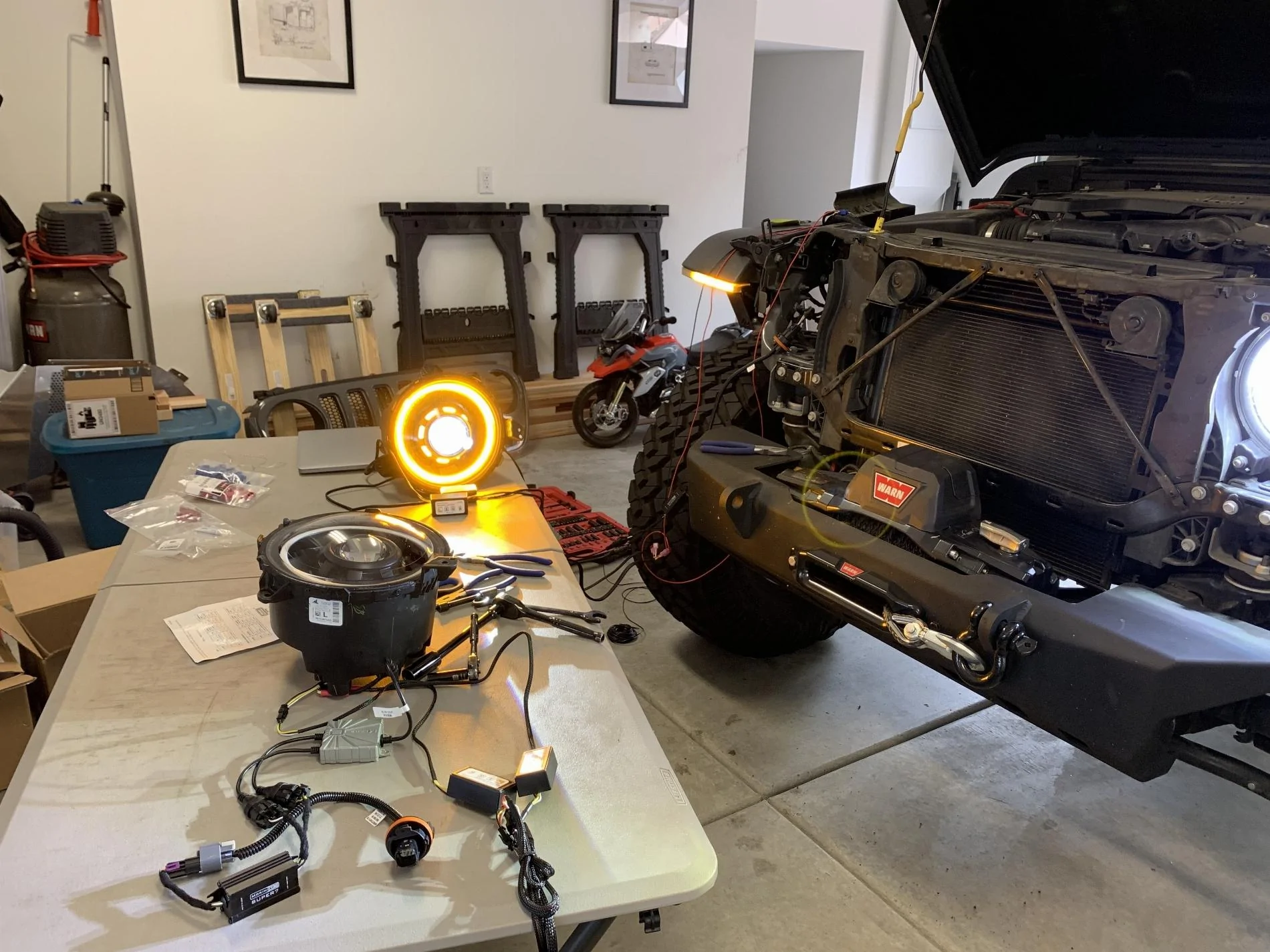

Installation requires wiring. Depending on whether you have high-line fender lights, you may need to tap into the blinker wires either at the front or back of the fenders. Recommend doing the driver side since there is a lot more access. Follow Diode Dynamics instructions to tap into the right wires. Took a couple hours to complete.

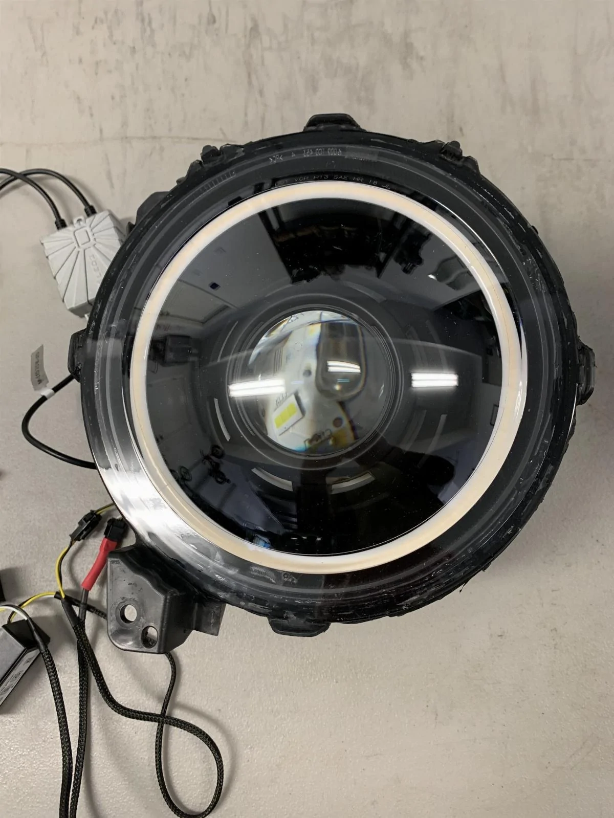

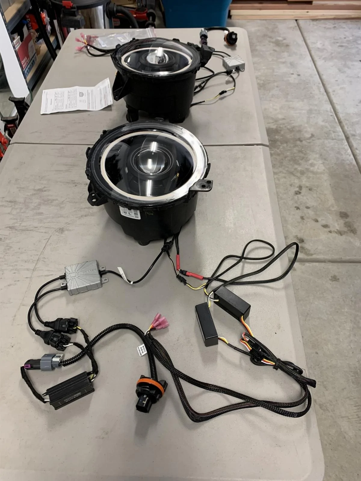

Morimoto M LED 2.0 https://lightwerkz.net/collections/led-projectors/products/bi-led-morimoto-m-led-2-0
Diode Dynamics Halo Light Switchback https://lightwerkz.net/products/halo-lights-led-185mm-switchback-pair-diode-dynamics
Also will need to purchase semi-flat black spray paint to black out the halogen housing, headlight housing re-seal, and quick splice wire connectors.
Installation:
Jeep Wrangler JL Retrofit Halogen Headlights IMG_2418
Jeep Wrangler JL Retrofit Halogen Headlights IMG_2420
Jeep Wrangler JL Retrofit Halogen Headlights IMG_2423
Jeep Wrangler JL Retrofit Halogen Headlights IMG_2426
Jeep Wrangler JL Retrofit Halogen Headlights IMG_2441
Jeep Wrangler JL Retrofit Halogen Headlights IMG_2463
Jeep Wrangler JL Retrofit Halogen Headlights IMG_2462

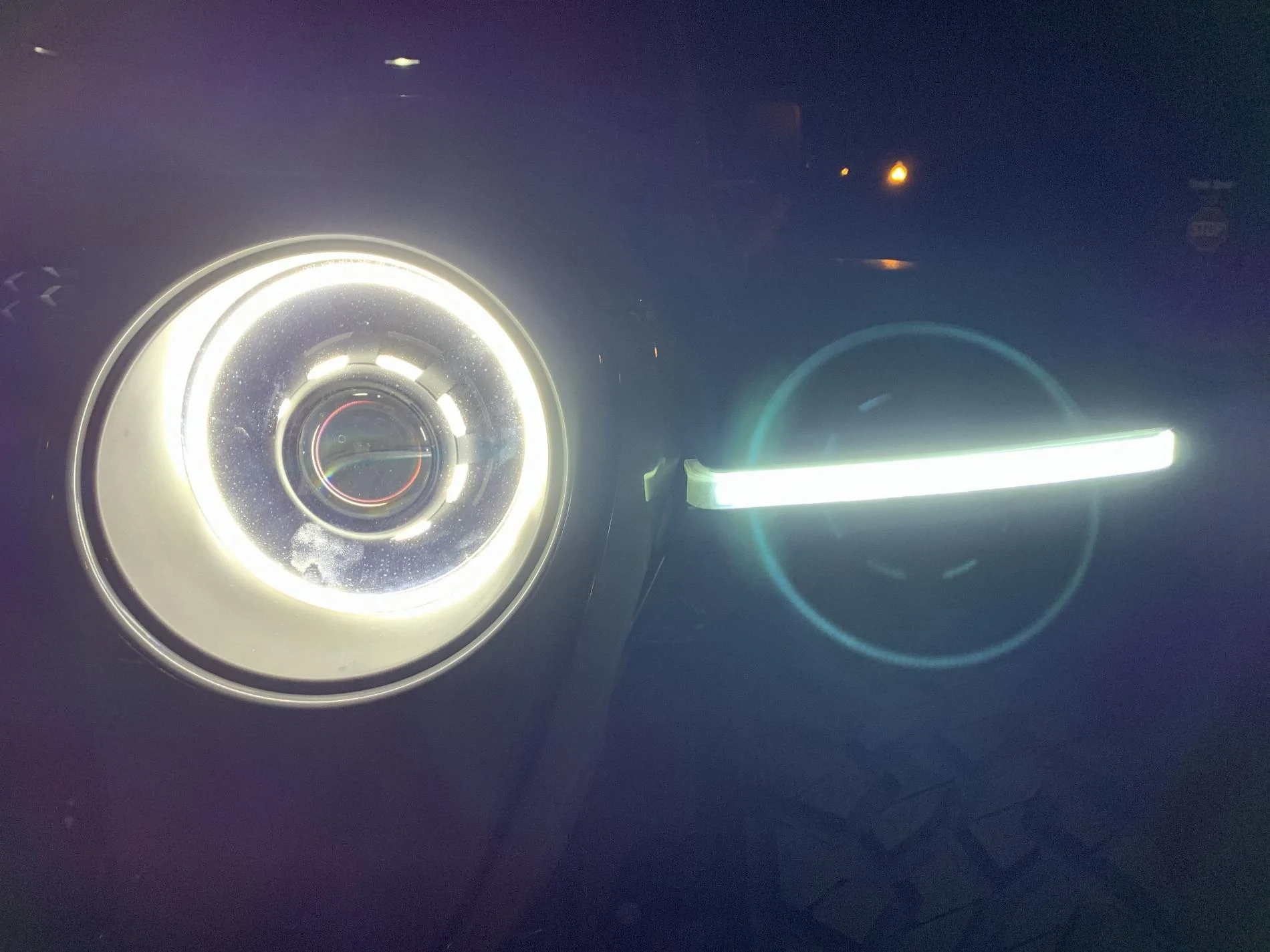

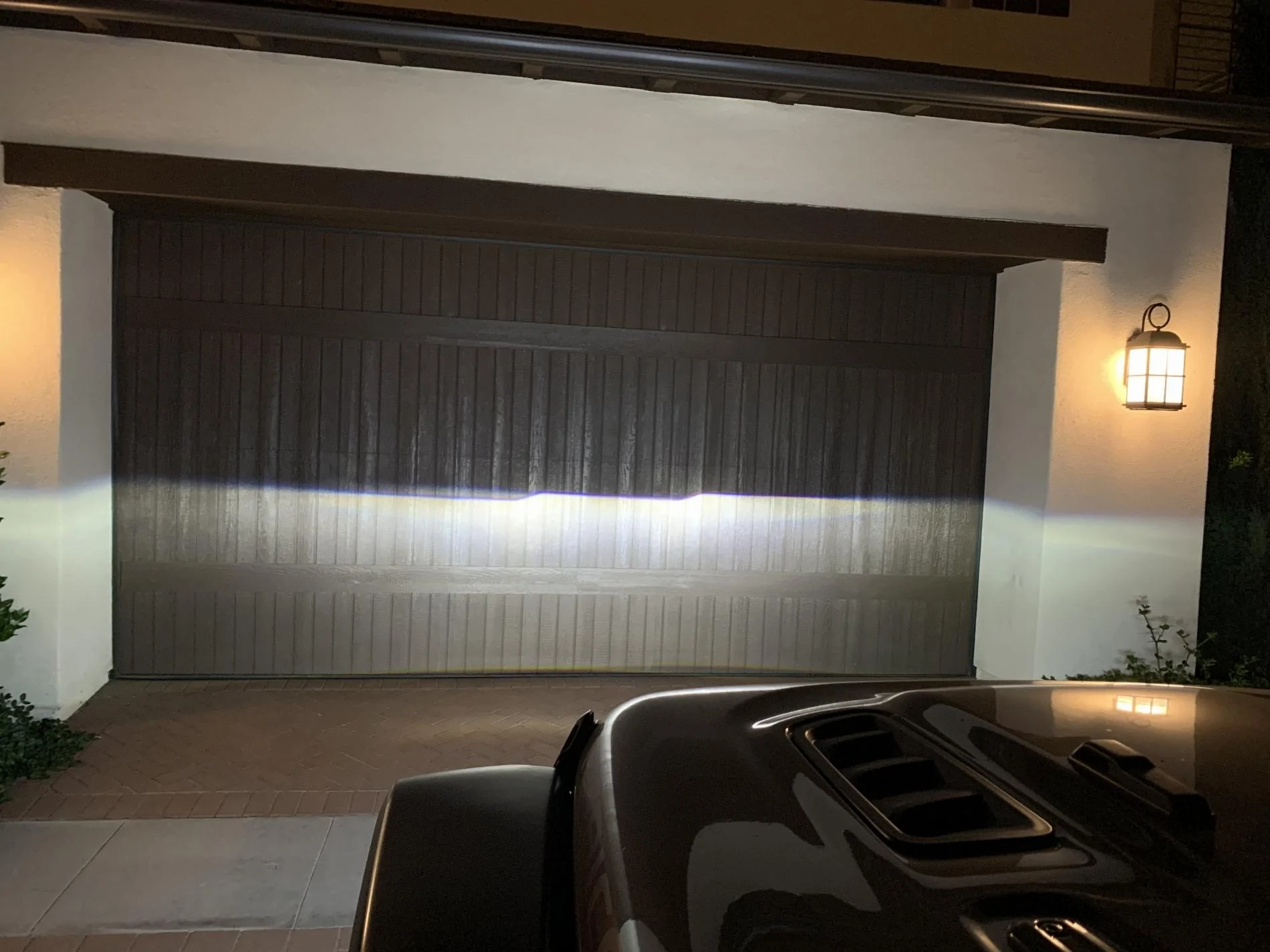

Results:
Jeep Wrangler JL Retrofit Halogen Headlights Beam
Jeep Wrangler JL Retrofit Halogen Headlights IMG_2503

I actually had Lightwerkz take care of the housing setup. I've done it a few times with my other vehicles but did not have the time to take on all of this one. You can always reach out to Caesar at [email protected] though. He is the owner and a friend of mine.
We did take pics throughout the process which you can browse through this link from google drive.
