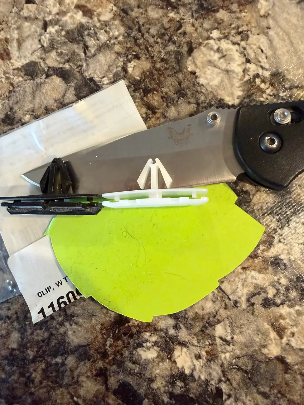

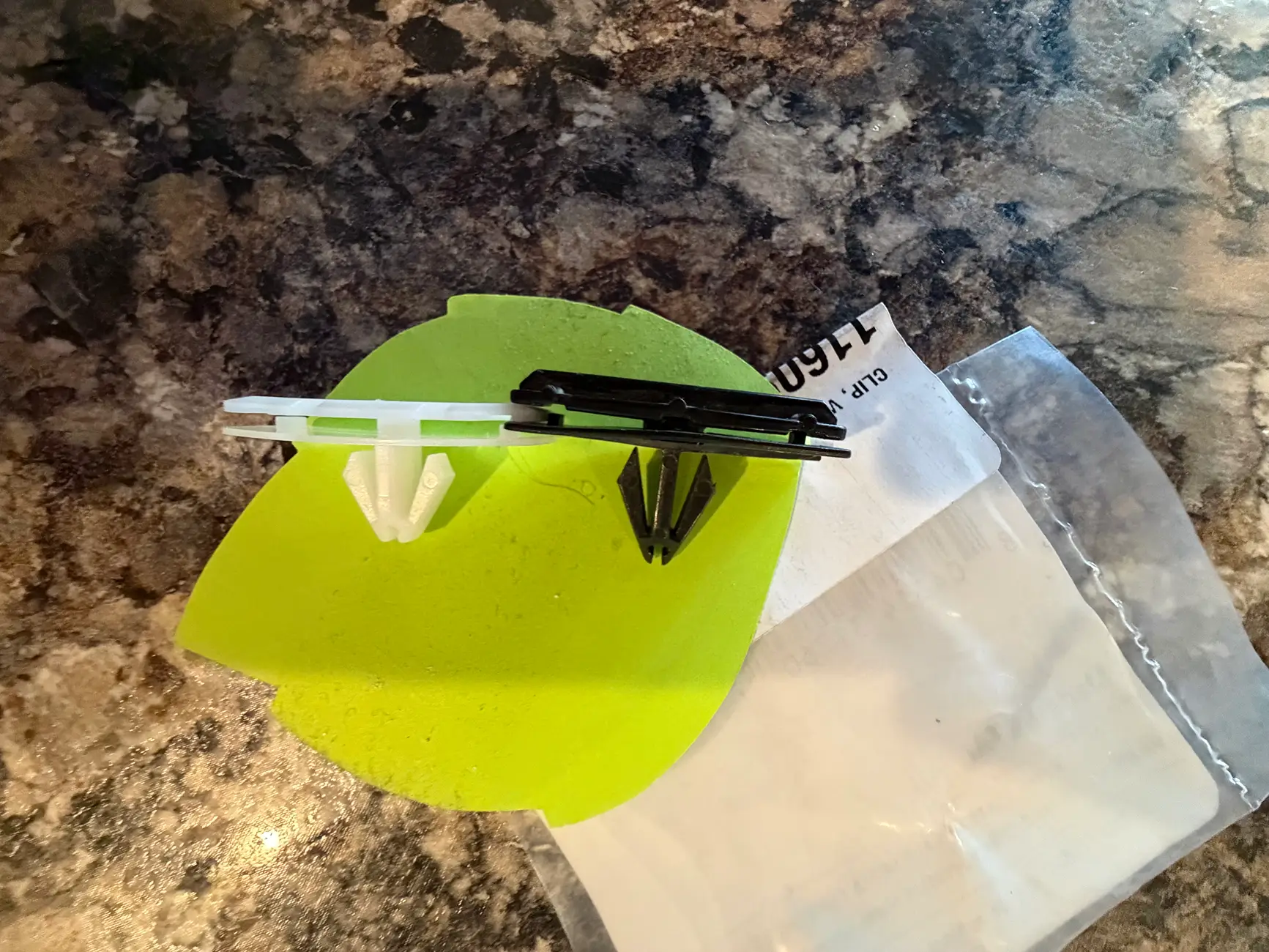

Appreciate the info above. Are the fender clips interchangeable between JK and JL?
I need to take off a rear fender, I note JL clips are white v JK being black, I have surplus clips from my old JK, so can I use them
jadmt
jeff
May 19, 2020
78
5,105
9,731
montana
no sure if they would work or not..they are slightly different size but unsure if that would make a difference in how they worked.

Going from memory here...
The JK and JL use a different clip. When i was looking, sourcing the JL pn was difficult, unless I was willing to pay for Mopar parts and price. JK was easy to find, in bulk. Sourcing was also difficult because the clips are very similar, some sites claim one size fits both.
The difference between the 2 is the thickness of the post that connects the 2 "plates". Slide a small file in the 1/8"gap to knock some plastic off the post. Then the clip will slide onto the JL flare.
The 2 anti-rotation nubs fit just fine on the JL flare, as does the barbed clip into the sheet metal.
