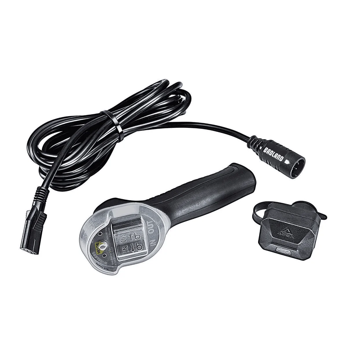

So my remote quit working I have this one.
Jeep Wrangler JL Replacement Badlands Apex 12k wireless winch remote? 1692325541429
I It was working fine with both internal and external receivers. I called Harbor Freights 1-800 number they suggested I go buy the one in store and if it works I could return it and order the one over the phone since it was cheaper. I tried to pair it and it would only spool in for half a second. But either way I thought that the remote was bad because it would not work with either internal or external receiver. So I took my remote to O'Reilly's and tested it with their key fob tester and it shows that it's transmitting. I guess I need to go buy one at Harbor Freight to test it. I saw that the remote transmitts on the 315 megahertz frequency which is the same frequency as some Key Fob and TPMS frequency.

Quick update I got my winch controller working. I pressed the in button and the on off button it spond in once and would not working again. I press the Spool in and double tap the on-off button it started working. I'm not sure if it's some type of Safety Lockout but it's working
