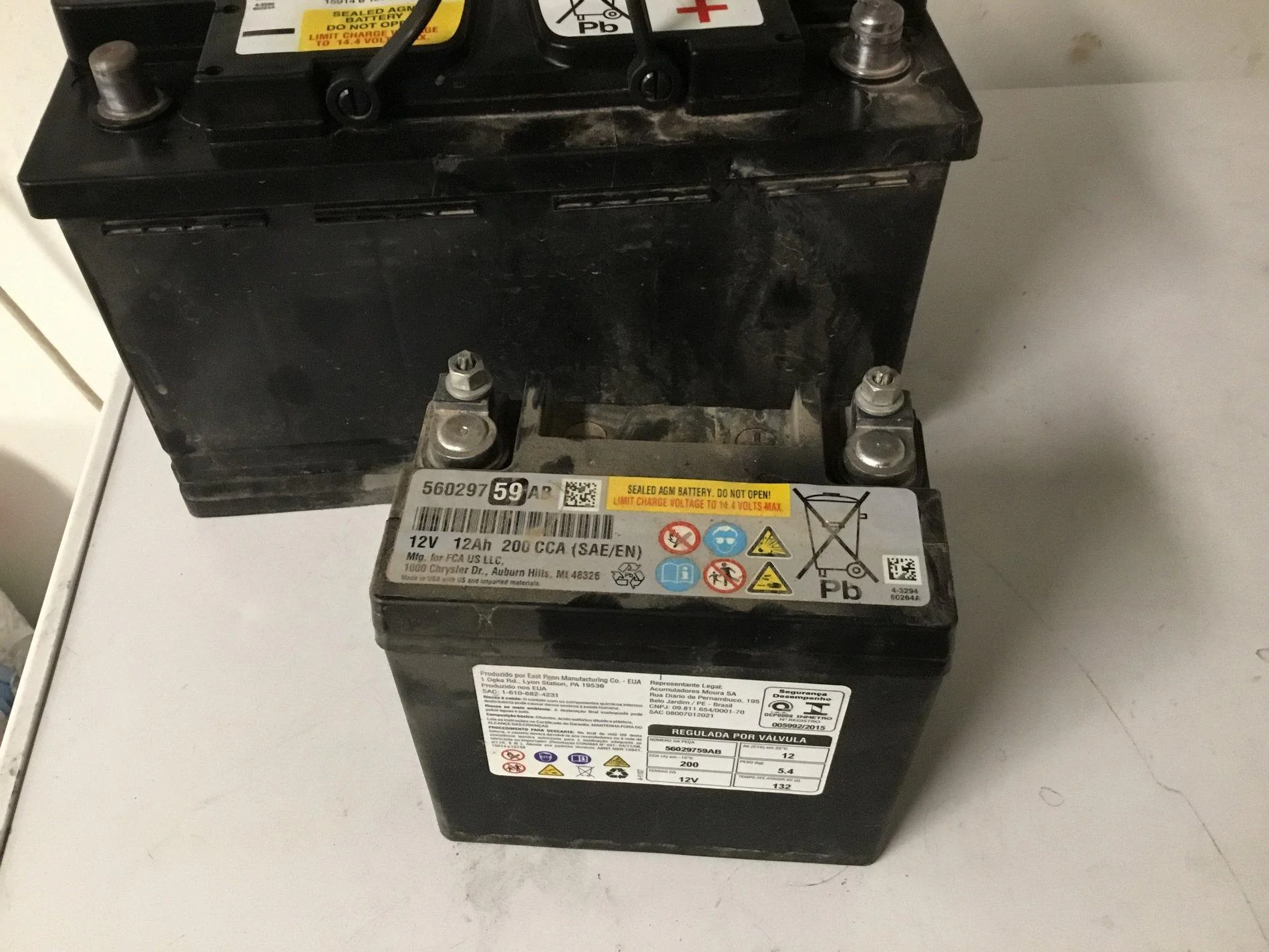

Replaced both batteries

I had the message "Aux switches not available, battery charging" for a couple of times I started the Jeep.
So, took it to the dealer and they said the main battery was bad. I explained about the Aux battery and asked if it was tested, "yes and passed".
Okay, then I picked it up and when I started it..... yep, same warning on dash..........
The service manager said he never heard of this, wait isn't that why I brought it in to begin with?
Said he would get with Jeep and let me know. I asked about the aux battery and he said it tested good..............
After a couple of days and calls, I told them i would bring it in and get a rental until they figure this out..........
The next day they called and said to bring it in as Jeep told them to test the aux battery as it looked like it was bad........ ????
Brought it in on an appointment at 730am and at 4pm they called and said the aux battery passed 2 times and on the third time it failed.
They are going to replace it as well, but there is a Nation wide back order for the battery and it will be a week before it comes in, picked the Jeep up again.
Asked the service manager about the voltage being high at 14.4-14.5 and was told that is normal all the time......
Asked why the battery was back ordered, a lot of them being replaced?
He went off about FCU changed vendors and now they can't get batteries for just about any vehicle.
My take on this is I will have to replace batteries about every 2 years as long as I own this Jeep. LOL
This isn't a complaint more of a laugh as they just wouldn't listen to me for any reason.............
So they replaced both batteries 3 weeks ago and the warning on the dash is back, "Aux switches not available, battery charging".
Back to the dealer for more checks.
