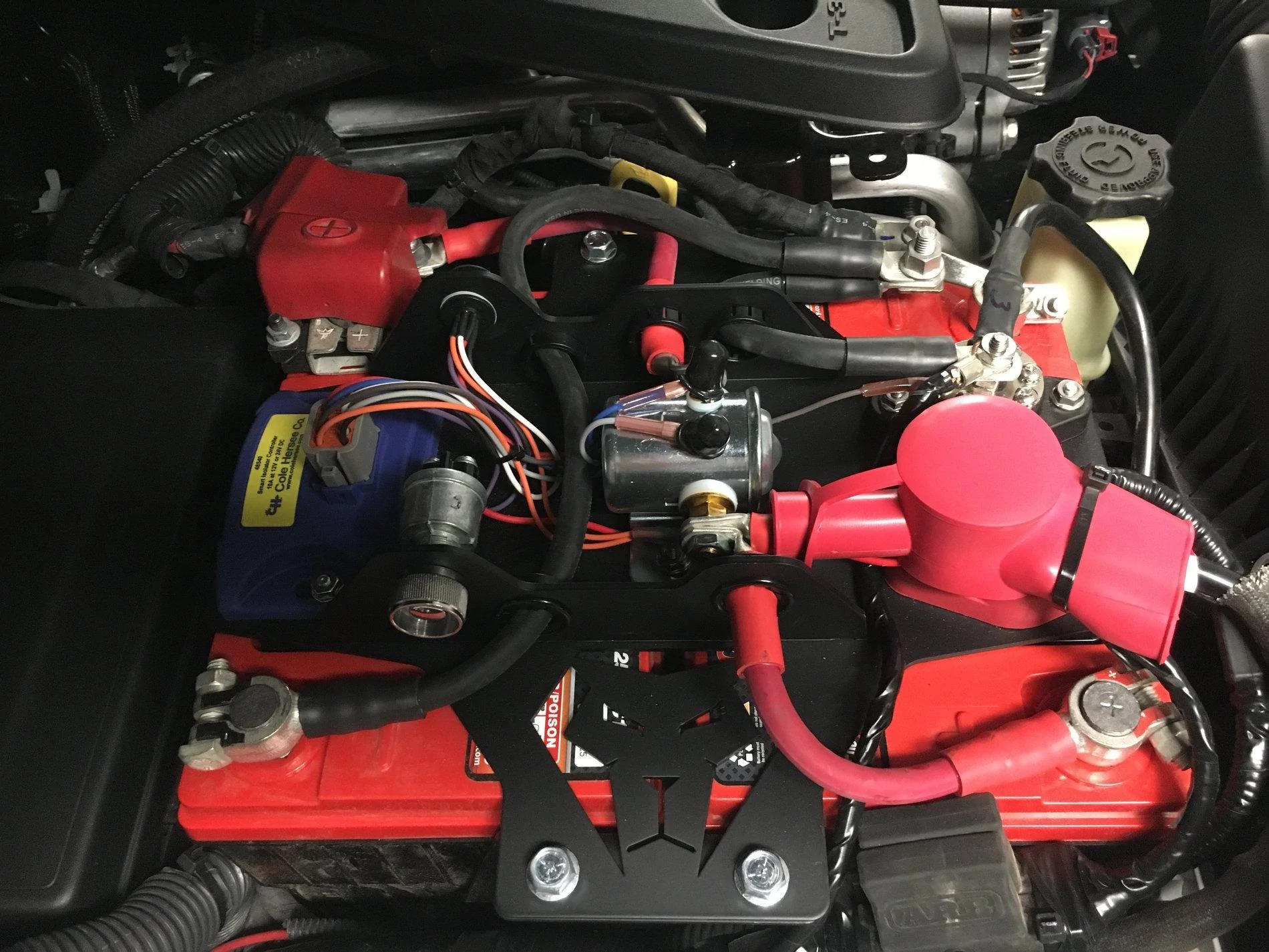

When you install the Genisis system the small aux battery comes out and goes in garbage. You now have 2 full size batteries.
I leave my ARB fridge on at all times and sometimes don't drive the jeep for weeks on end.
On the 2.0L Turbo, there is no small aux battery, only the 1 battery, so with the Gensis system you get a dual battery system and the batteries are 850 cca each and if i remember correctly the factory battery is only 750 cca
