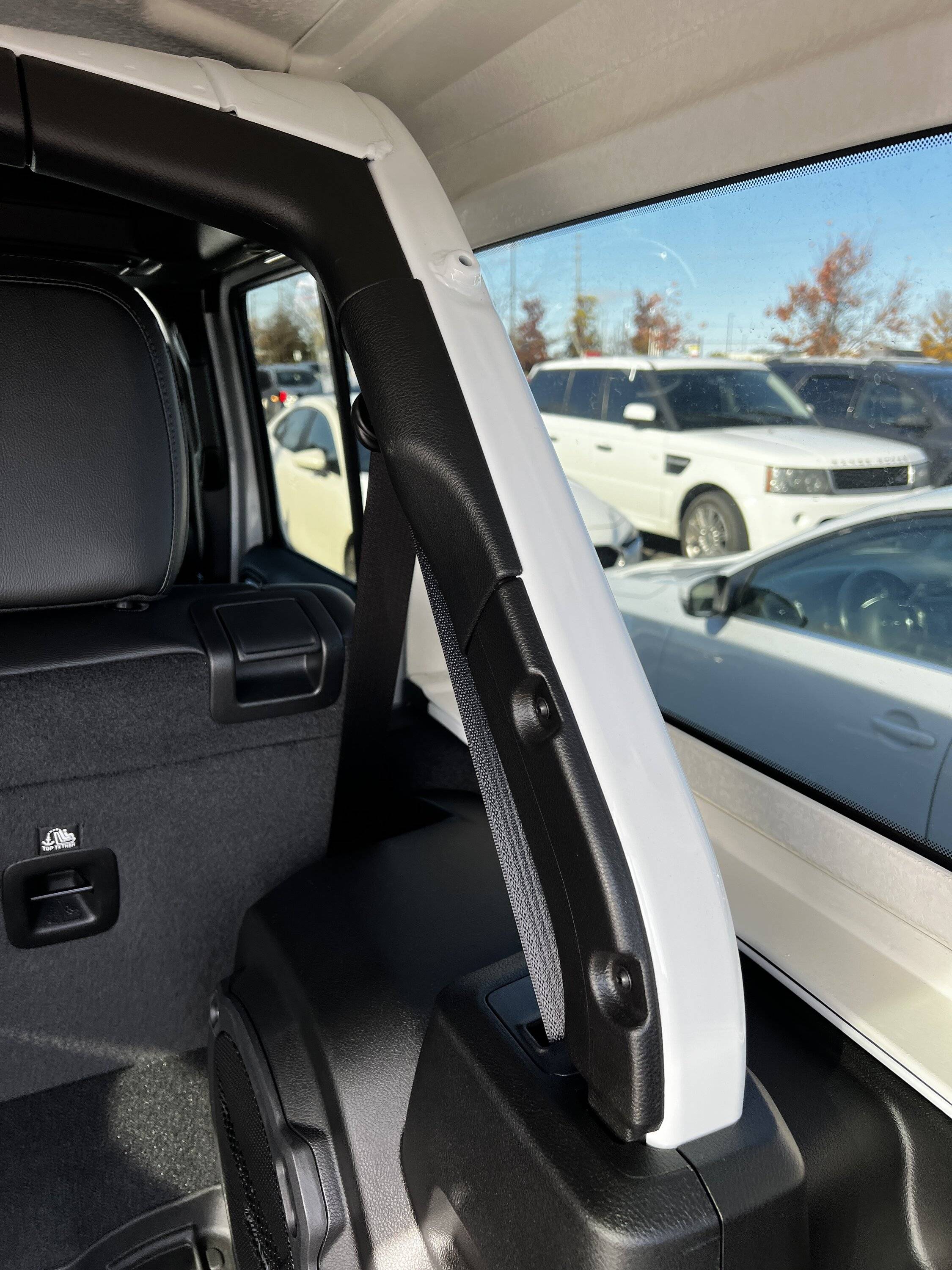

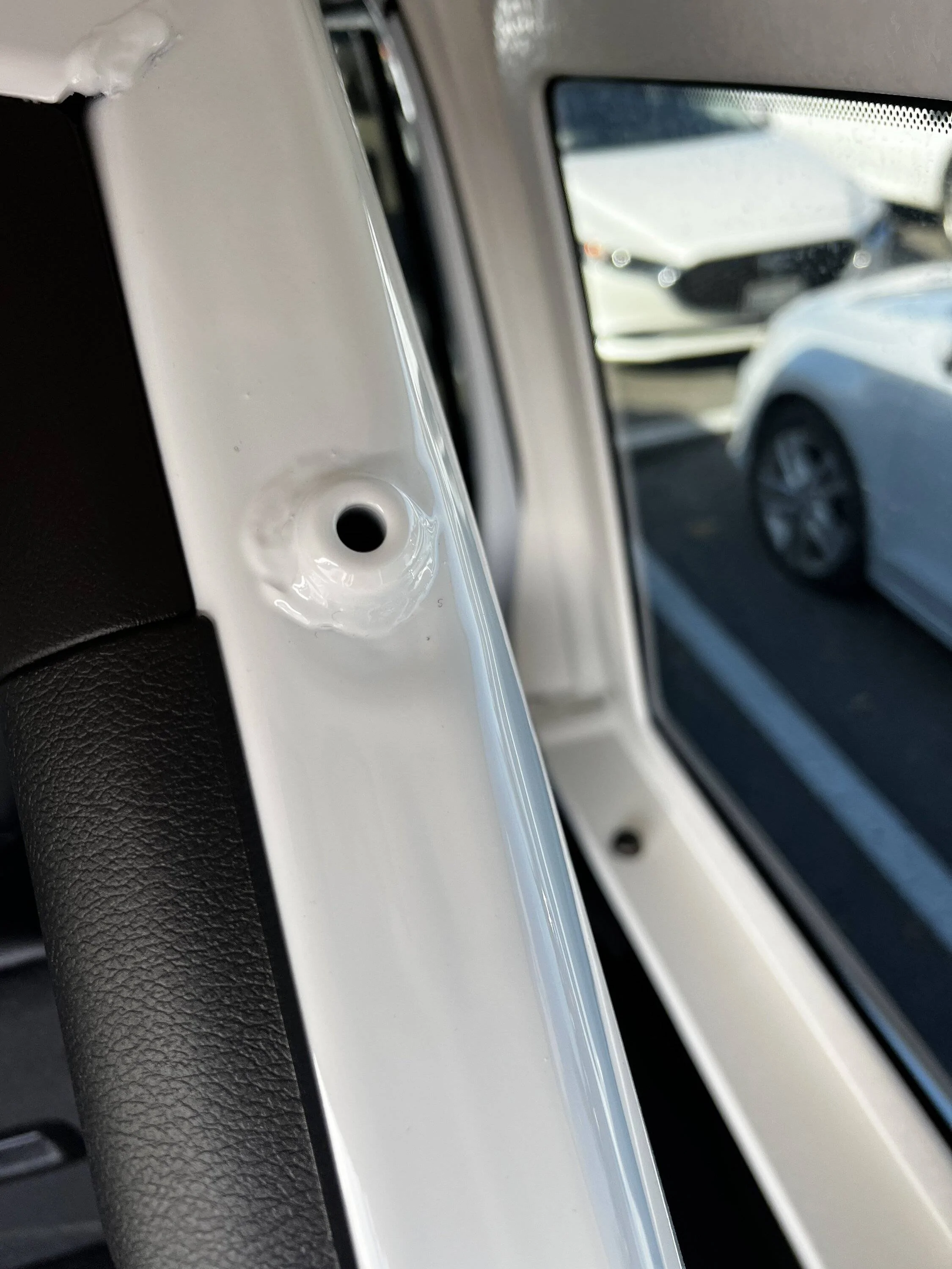

Does anyone know what type and size of bolt goes into that hole?
I’m planning to build a support cross bar to mount my traction boards and recovery rope.

I don’t know. Sorry. Time to start investigating and trying a few other bolts.
It looks similar to a hardtop bolt. Try that first.:like:

I believe it’s not threaded. Looks like about a 3/8-16 bolt but you would need to use a tap to cut some threads

hehe i thought id avoid spending time on it and just ask. I didnt even look inside, really thought it was threaded :)
Ohh man. Dammit. Why would it be simple? Now project will get more time consuming
i TAPPED MINE TO 3/8" X 16
thanks, I guess im buying tools tomorrow.

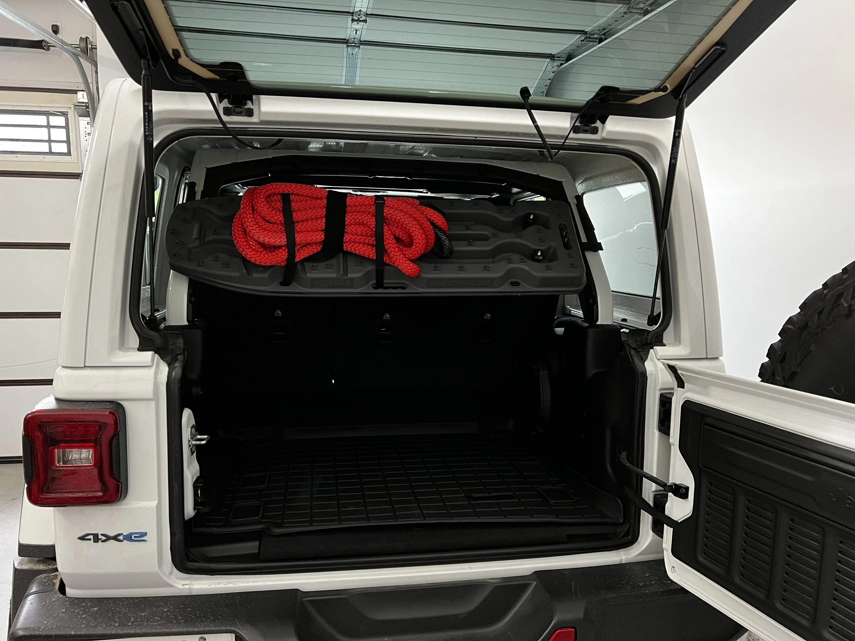

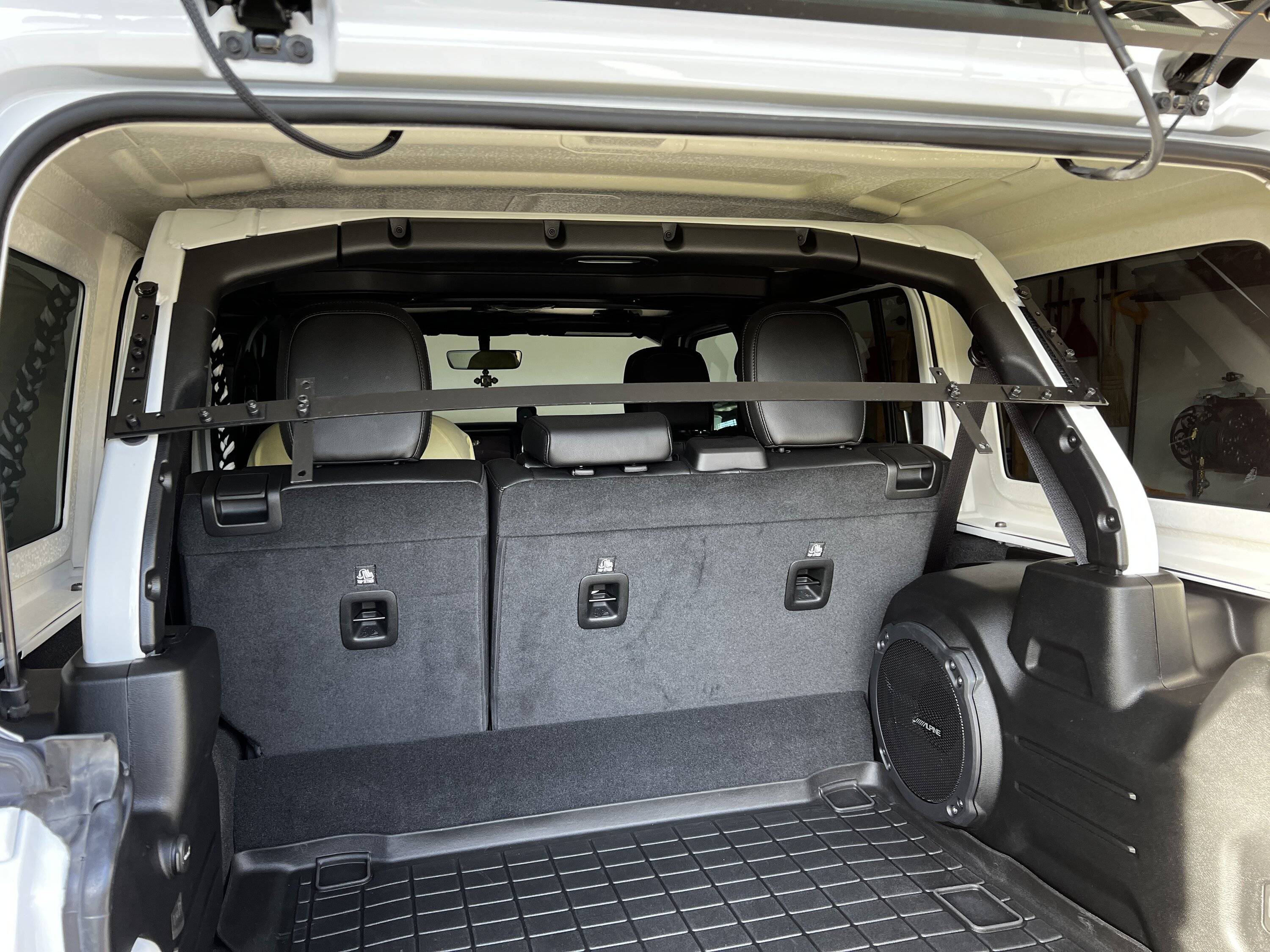

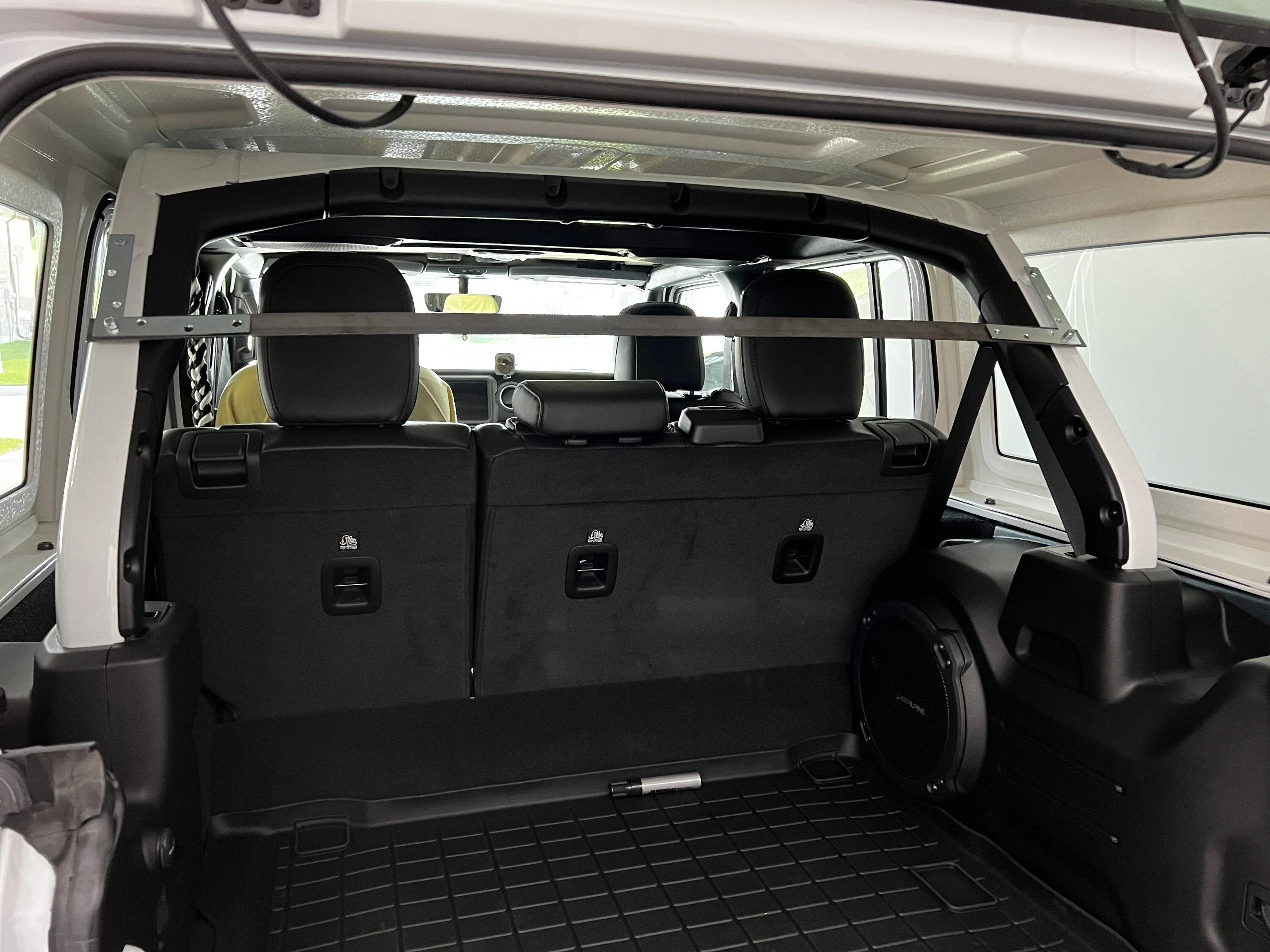

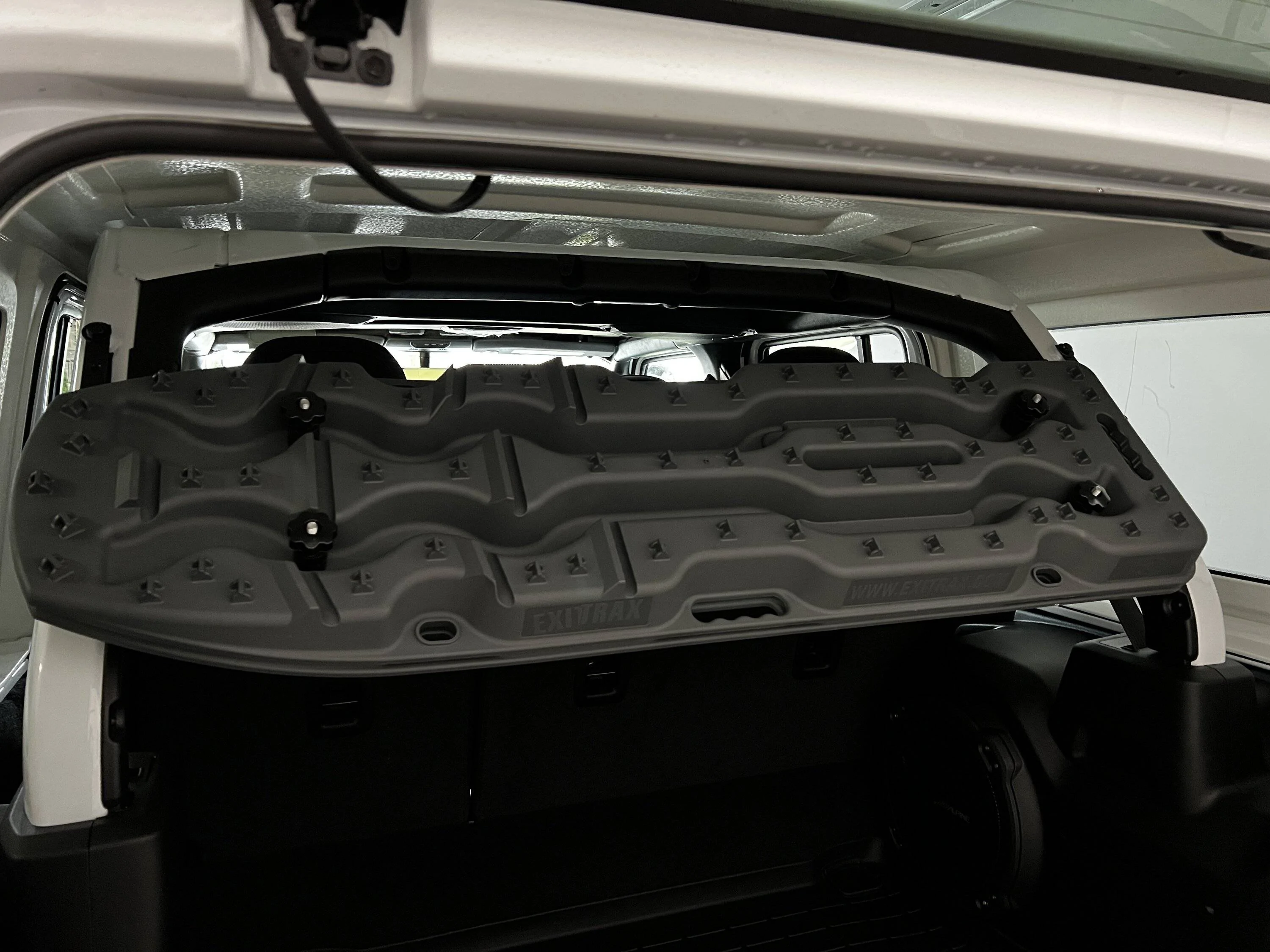

Final product. Not too bad. Works that’s all I care.
