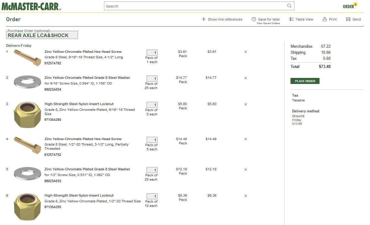

I’d be worried about the ones that were over torqued and not replaced. If you went way over those bolts may be stretched already. What do you go to?
When I put on lower shock mount / LCA skids I had to replace the bolts. The metric stuff is hard to find but a grade 8 (NOT grade 8.8) is considered equivalent.
https://monsterbolts.com/blogs/news/bolt-and-nut-grades-explained
This is what I went with for LCA and shock bolts.
Jeep Wrangler JL Question on rear shock bolt 1728356968331-zg
https://www.jlwranglerforums.com/forum/threads/control-arm-to-frame-mount-damage.38445/post-2384665
I think you’d only need the 1/2”-20 thread 3” long for shocks with no added skids.
