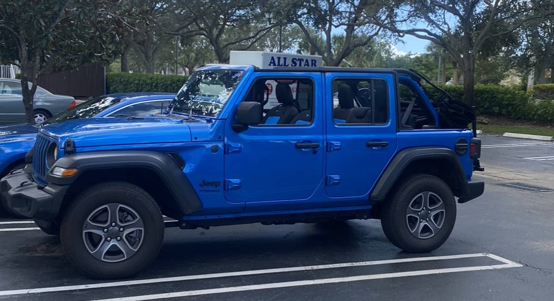

so I was at the tire shop today and they said I have 245 width - 75 height tire - 17 rims. I hear people talk about 33 inch and 35 inch tires and I don’t know what that means in relation to the 245/285/315 etc.
I feel like my Jeep looks odd. The tires look so tiny on it … there’s a lot of room between the tires and the bumper. It looks tall and skinny compared to other jeeps I see. If I went with 20’ rims, what type of tires would best fill that gap, so to speak, without raising the height of the car too much? (Or does it just have to?). And then also, why would someone want to stay with smaller rims? (I’ve seen members say that). Is there a ride difference?

The 245-75-17 are the stock tire size that comes on a sport trim. They are about 31.5 inches tall-ish.
Regarding the ride, yes, more sidewall will usually absorb bumps better and give you a better ride. Sticking with a 17 inch rim, and maybe going up a tire size to 285-70-17 is a better way to go vs. getting into a 20” rim imho. But ultimately it is up to you and what style of Jeep you want it to be. There are trade offs to everything. Also, how you intend to use your Jeep should be a major factor in determining wheel/tire choice.

basically the only rims I can find that I really like that match my hydro blue come in 20’
are tires able to be completely customized? Like you can choose different diameters etc? Looking at this calculator it seems like 275/60/20 might give me what I’m looking for. I want to fill in those gaps under the bumpers better for sure
Yes, you can go that route. Things like size and weight are definitely considerations, and will affect how the Jeep handles / accelerates.
