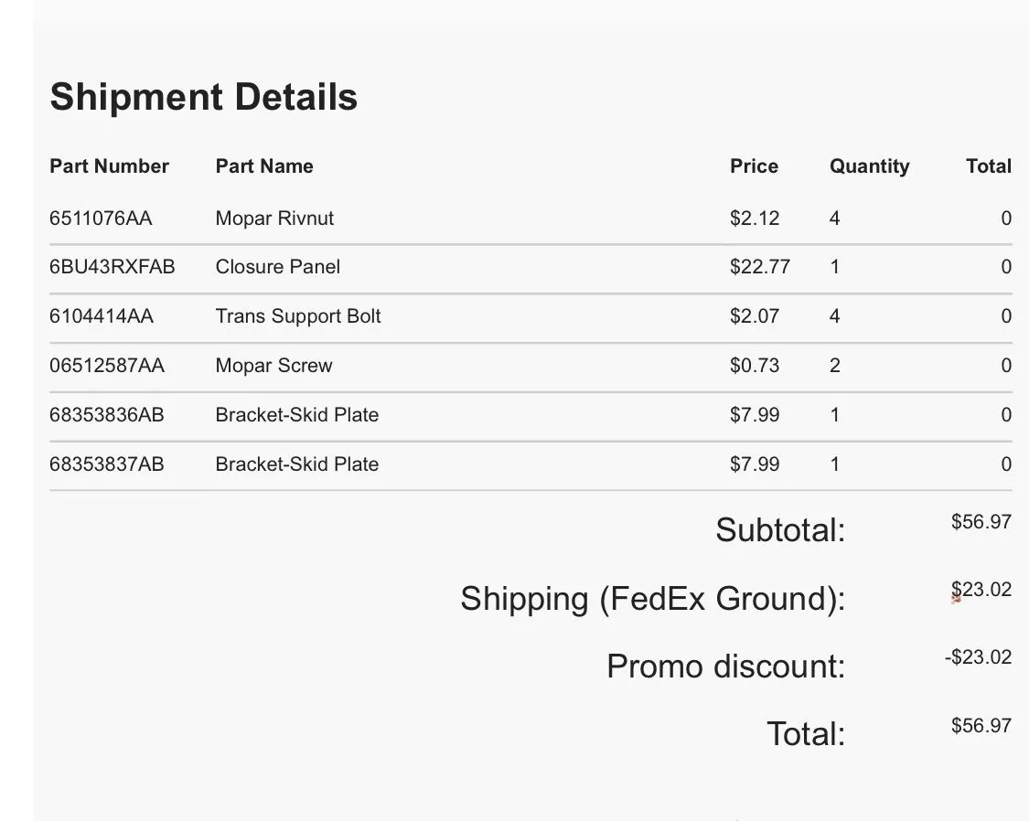

Let me start with don’t plan on installing when picking up. Takes a little more time than you think. I assume based on your reference to Rivnuts your are getting the steel skid plate also? If you are here is list of items you will need. I ordered these parts from @AllMoparParts.com here on the forum.

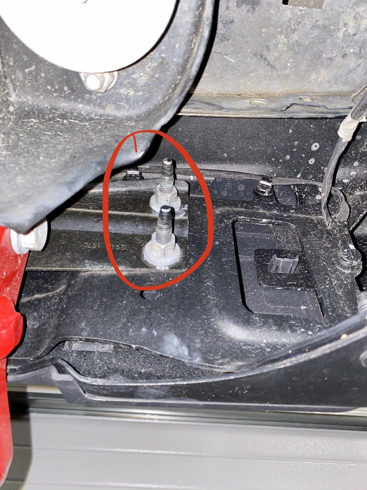

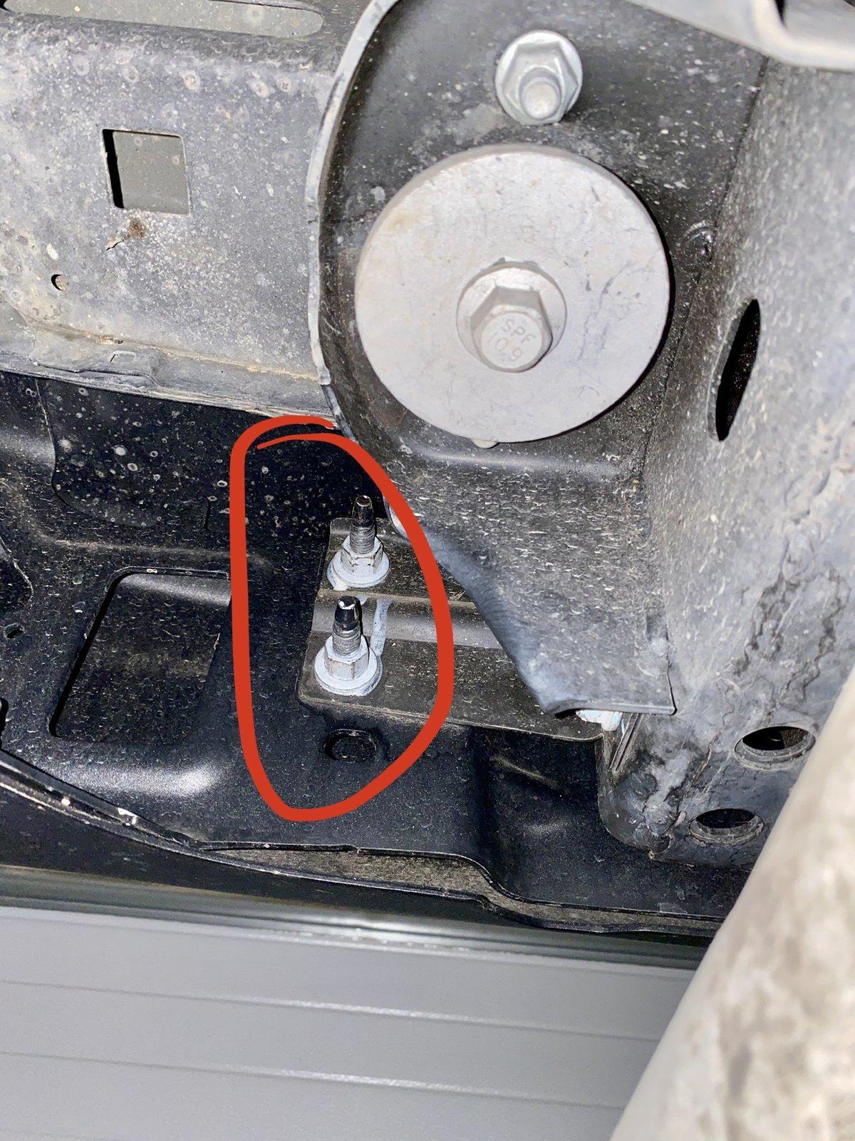

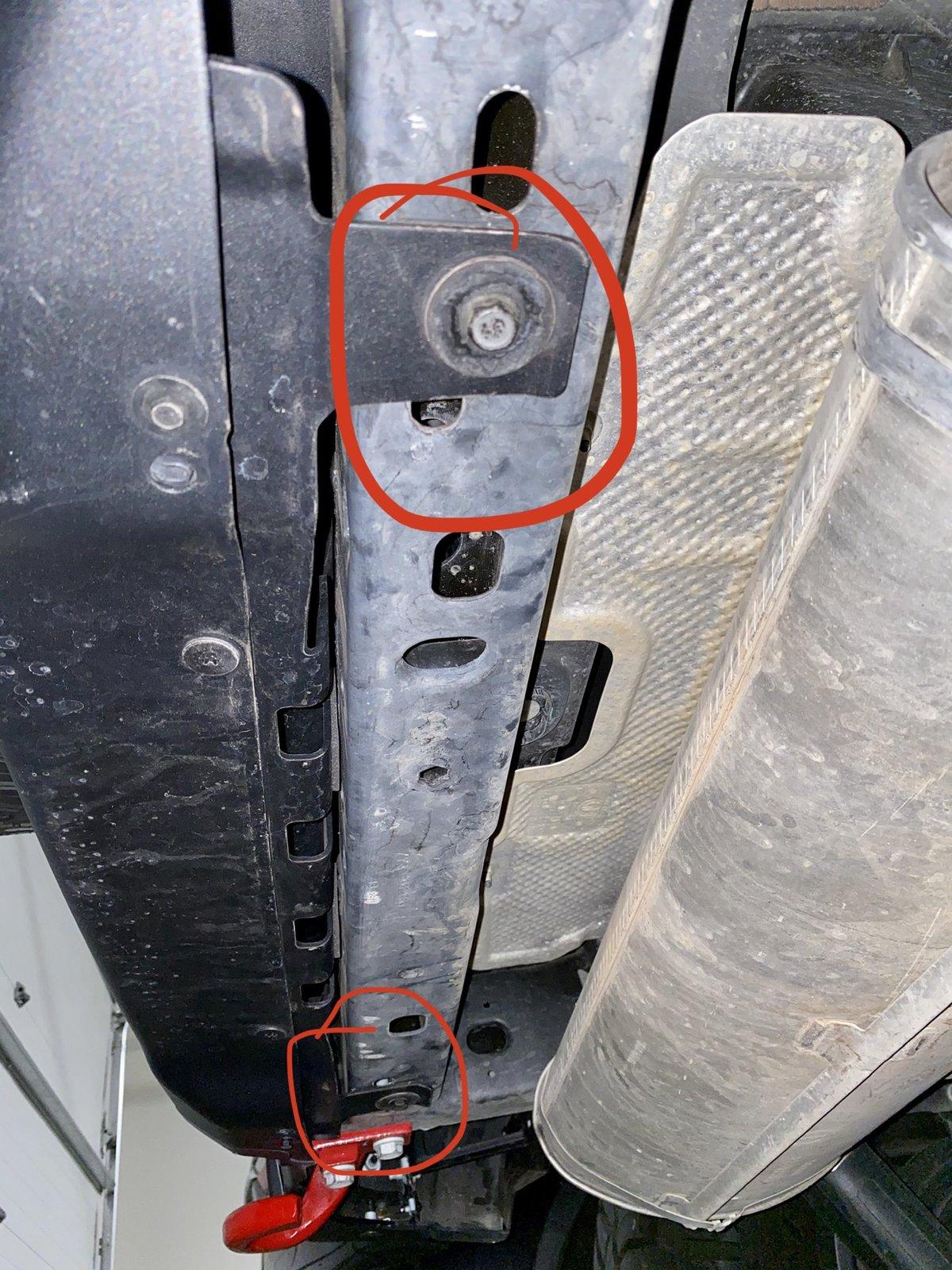

Here is a couple pics of rear bumper nuts and the two bolts/Rivnuts mentioned.
Jeep Wrangler JL Plastic to Steel E1424102-DE33-49FB-894A-9805C3CB261F
Jeep Wrangler JL Plastic to Steel C263EA8E-1983-41B1-8E5E-B672DADBD151
Jeep Wrangler JL Plastic to Steel ABB6CD23-AE60-4362-849A-762056F5DE29

When you order the bumper and skid plate from a mopar parts supplier, these parts on your list are not included?
