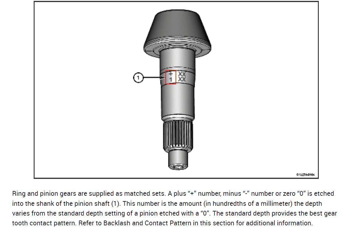

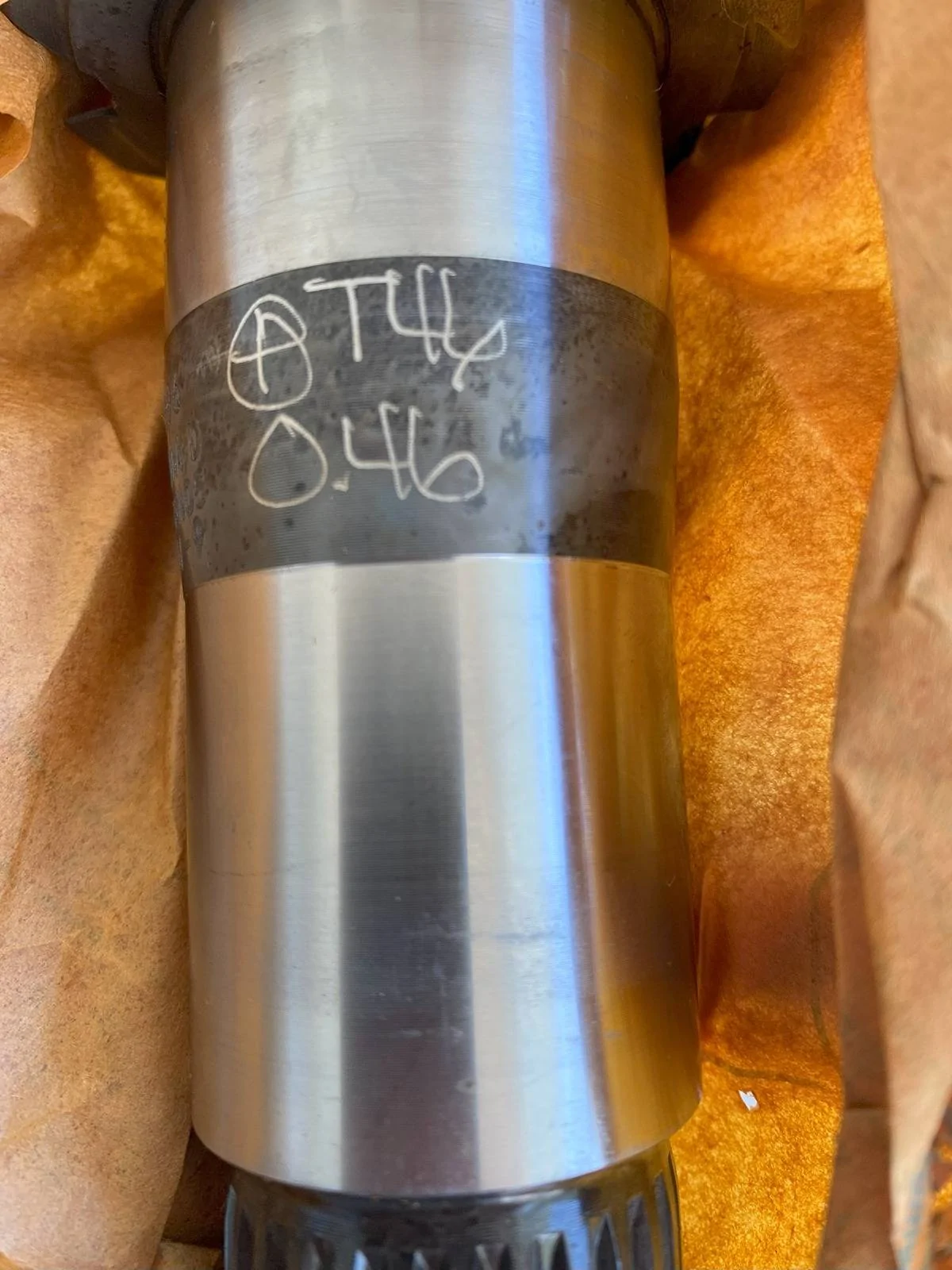

So, here are the etchings on my old pinion:
Jeep Wrangler JL Pinion Shim Value 0
Here are the etchings on my new pinion:
Jeep Wrangler JL Pinion Shim Value IMG_4385
As I understand it, these are both zero pinions and use the same shim as factory and it is behind the bearing race. @chevymitchell

As someone who recently went through this, you are correct -- they are both 0 pinions, so try the same shim thickness to start.

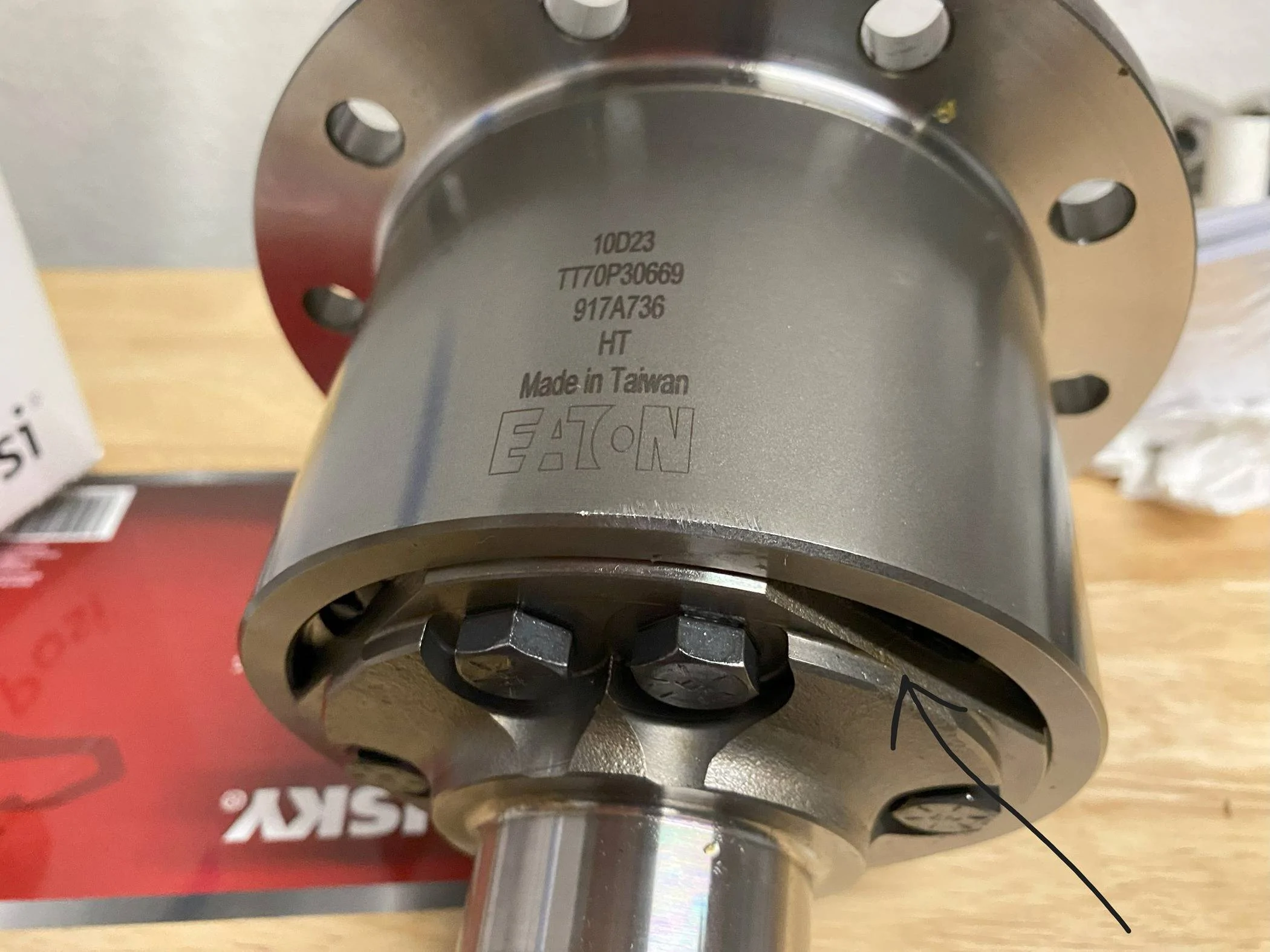

How do I torque down that ring gear, do I need to do it inside the diff housing?
Hate to bug you again @chevymitchell?
Best answer is a vise that's large enough. You need to find a flat area on your carrier that you can clamp to, otherwise it'll rotate on you and you'll start rounding off bolt heads (don't ask me how I know).
I tried doing it in the diff and it didn't work well for me. Some people make it work.
If you have a locker that you can engage, you can bolt a tire to an axle and stand on the tire on the floor, and the locker will prevent the carrier from turning.

Yeah, it's a truetrac so there is nothing to clamp to. I thought of a big azz vise with rubber pads, but 135 lb-ft is a lot. I'm sure most shops are like "135lb-ft, sounds like 6-7 duggas", dugga-dugga-dugga.....
I also installed a Truetrac. At first i tried to clamp on the round area and it was a disaster. Tried the rubber pads on the vise and all. No good.
Look at the end of the Truetrac opposite where the ring gear goes. You'll see a thin metal plate ,(maybe 3/8") that has square edges on two opposing sides. You can clamp your vise on that plate and it'll hold. That's what I did. Just clamp that really tight.

Maybe a shallow
Are you talking here?
This worked! It was a real effort to keep it down in the vise, I was holding it down while my neighbor leaned into my big Tq wrench. Now I know why they don't have you reuse the bolts as once you lean into it that hard, it's one and done. Tried the tire and axle trick solo and used the factory yellow loctite, so it has red on it now.
