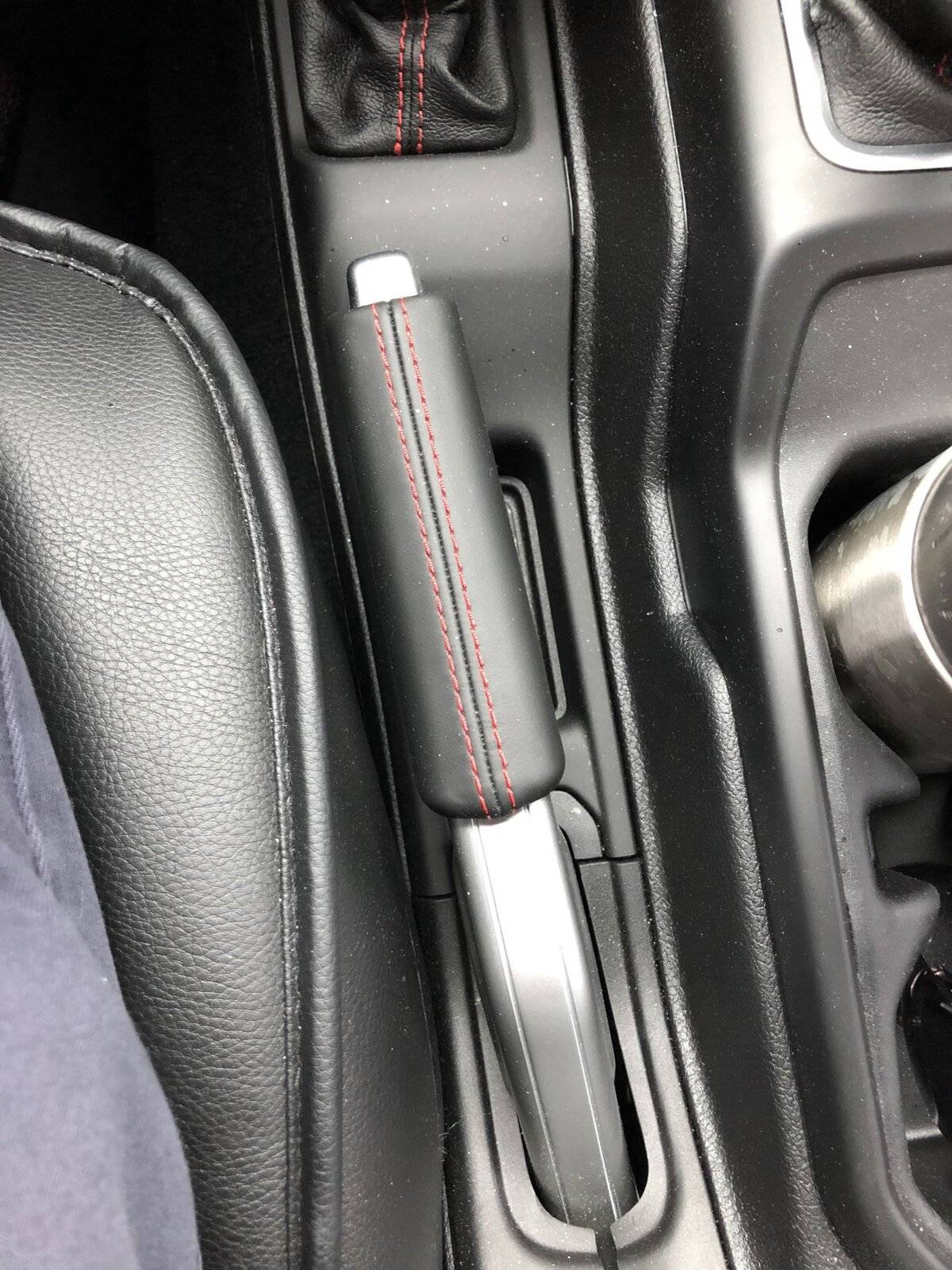

If I wanted to swap plastic non leather E brake grip for the leather stitched one, what’s involved? Can I swap the leather part easily or is it the entire unit that needs to be installed, and adjusted etc

just wanted to revive this thread because I'm interested as well. The vinyl covering sits on top of a hard plastic sleeve which slides over the metal handle. In order to replace with the leather sleeve, you will need to cut/drill out the plastic sleeve to release it from the metal rod.
