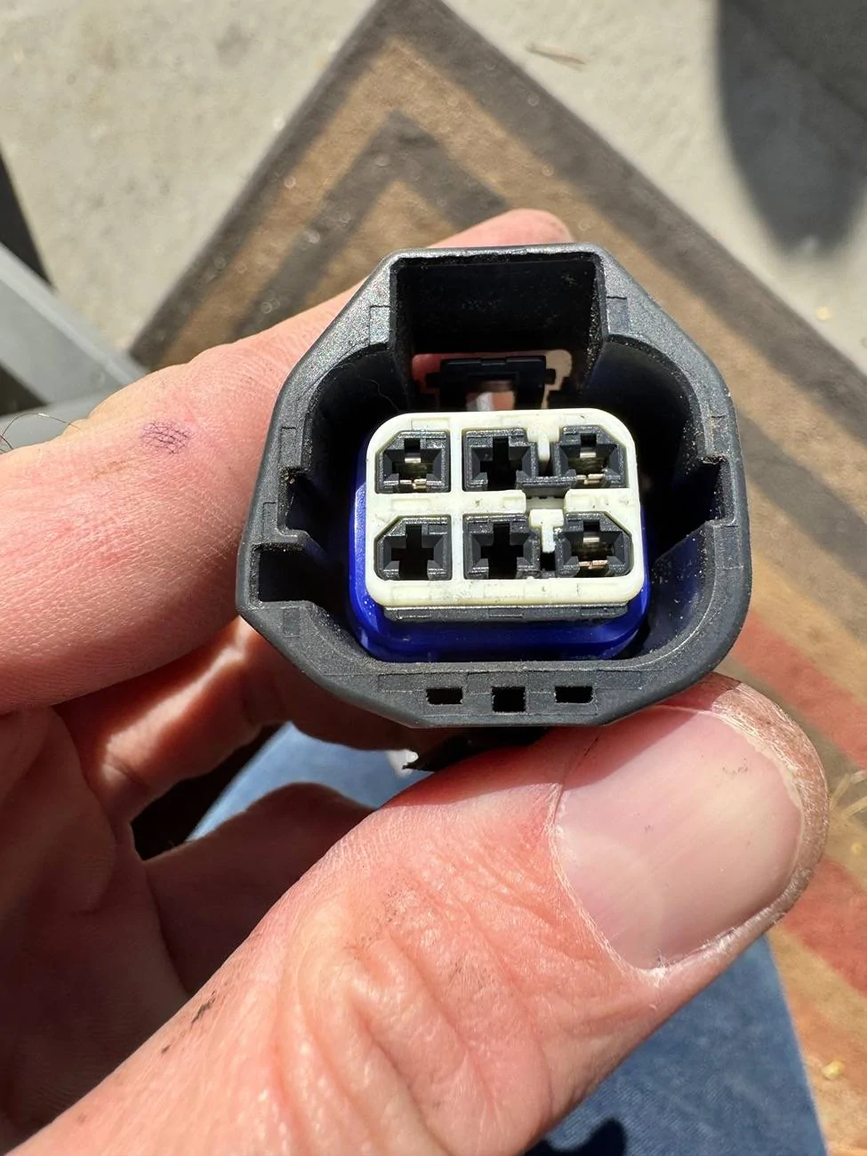

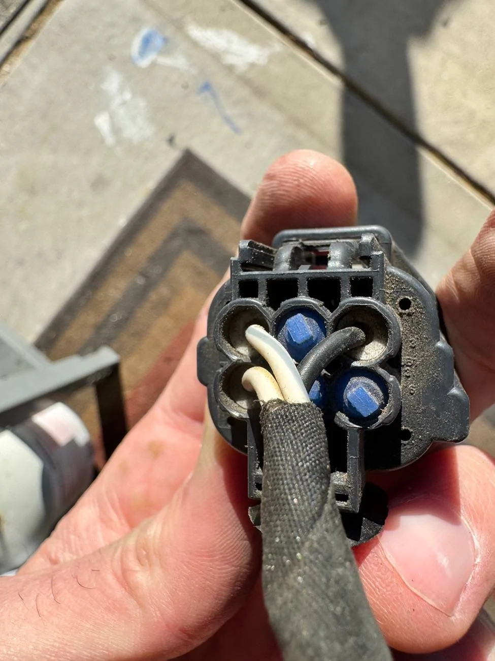

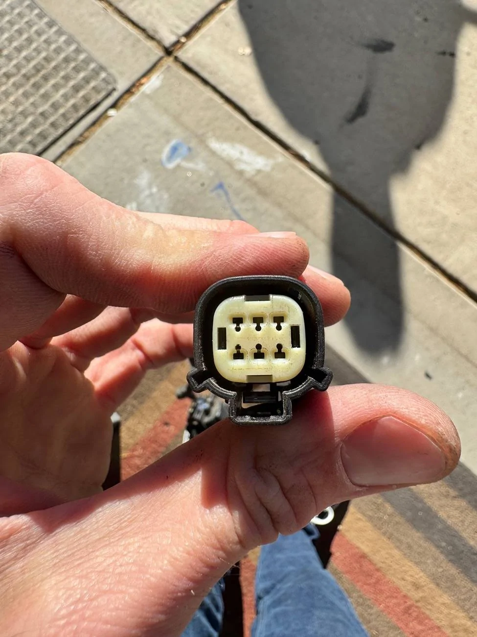

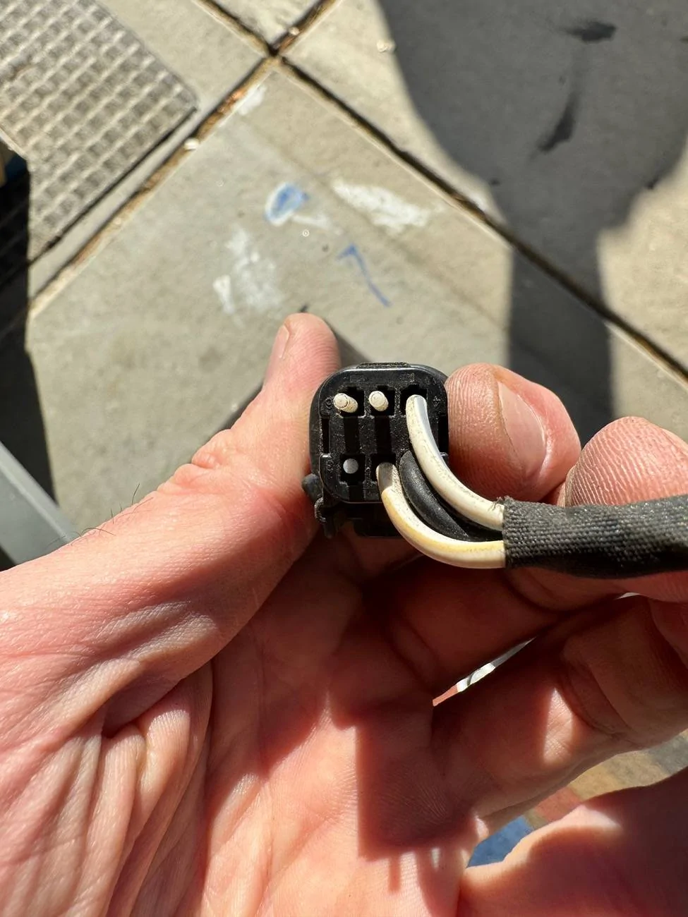

Did you ever figure this out? I did the same thing with my 21’ JLURD. Swapped the halogens for a set of OEM LED headlights from a 20’ sport. My driver side plug has 4 wires and the halo works, the passenger side does not. I’d love to have the halos working. And I’ve tried every thing through JScan, without that wire I’m sure it will not work.
