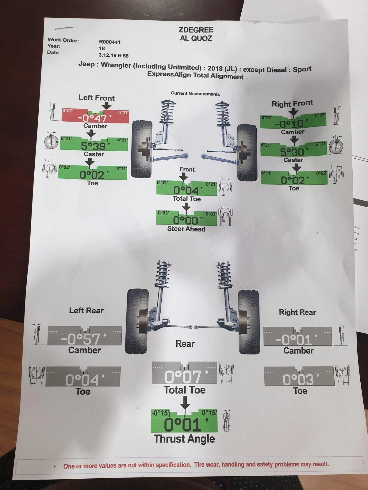

Hey all,
First post here as I've just picked up a new 2019 JLU, however, I'm having a real issue with the car drifting to the right at all speeds above 20kph. I've searched and searched the forums and can't seem to find specific answers, some say adjustable LCA's are needed, some say to get an adjustable steering stabilizer, some say its Purley down to the camber in the road.. the list goes on.
Info on the Jeep below:
- 3.5" rough country suspension lift (came with geometry correction brackets)
- 315/70/17 Cooper AT/3 XLT
The Jeep has been aligned 3 times, two from the dealer and once from an independent tire specialist and they are saying everything is in line, attached is the latest print out from the alignment specialist.
Now, I've noticed on the printout, the camber on the left side of the car doesn't match the right side, however, at the shop they said this is completely fine and should not be creating the drift to the right - Am I right to believe them or is this causing the car to pull to the right?
It's quite bad, whilst going at higher speeds (100kph +), if I let go of the wheel the car will be in the next lane within about 5-10 seconds. I've driven the jeep like this for around 2000km now and across multiple roads, flat areas, roads that camber down to the left etc. and it's still pulling to the right no matter what.
I have a couple of questions below:
1. Is this to do with my lift, are the RC geometry correction brackets not doing the job and the caster is off?
2. Is this from the tires?
3. I've heard pulling the power steering fuse can do the trick, however, I can't find any info on how to do it - would this be a smart move trying or am I best to get the dealer to do it?
Please do let me know any suggestions/advice as this pull to the right is driving me crazy, the jeep drives like a dream otherwise.
Thanks all, appreciate your thoughts.
J
