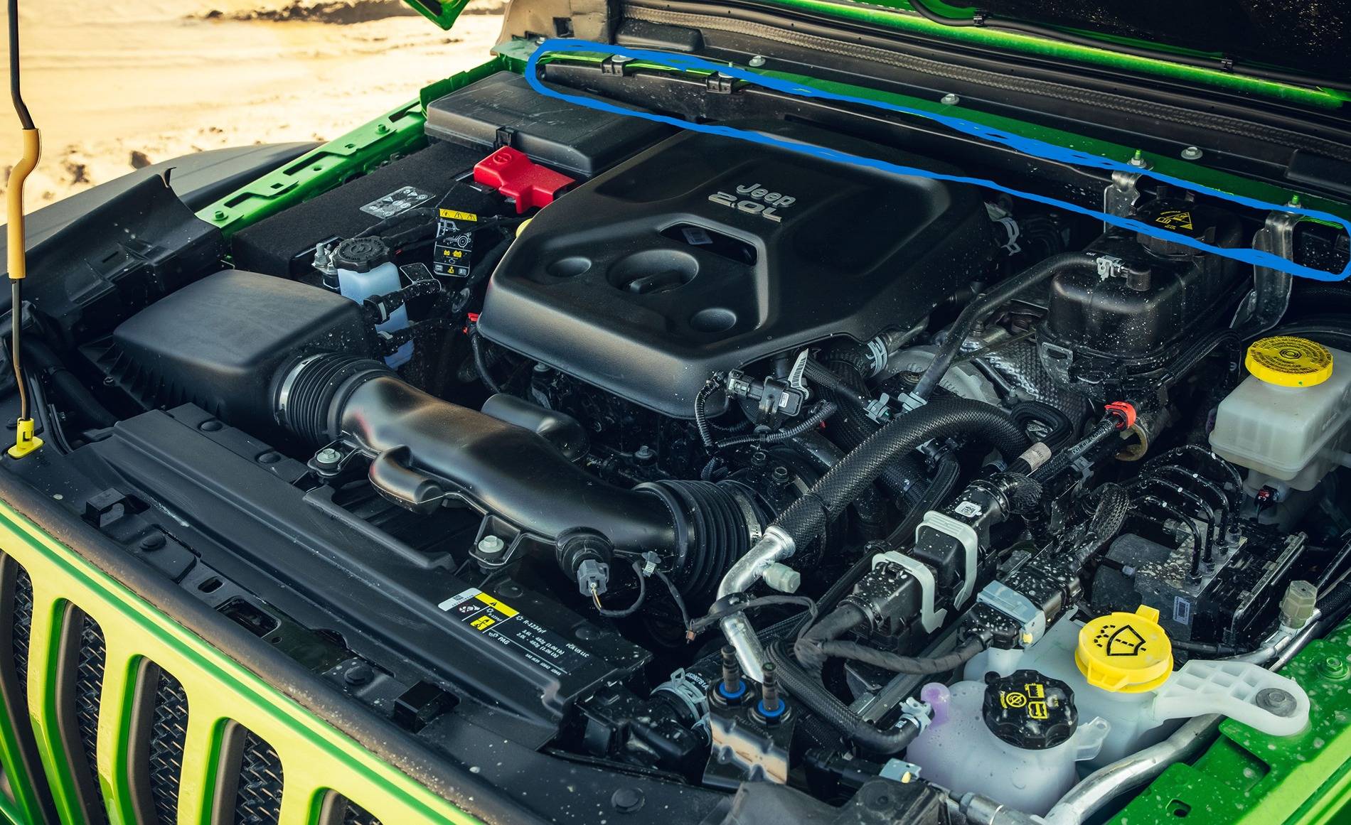

I have a 2018 JLU with a 2.0 engine. I was looking to run a wire harness along the back firewall. See pic with the blue circle. There is a black plastic square piece that runs driver side to pax side. Does anyone know if this is solid or contains anything I shouldn't drill into to. I wanted to insert nut plates to run a harness. Any help would be great!!!!

Don't Drill through that!! Get a small screwdriver and pop the clips open. That plastic piece is full of OEM wiring & has lots of room for more.

What dirtdigr said, don’t drill.

Thank you for the help got the wires ran looks like it came from the factory now!!!
