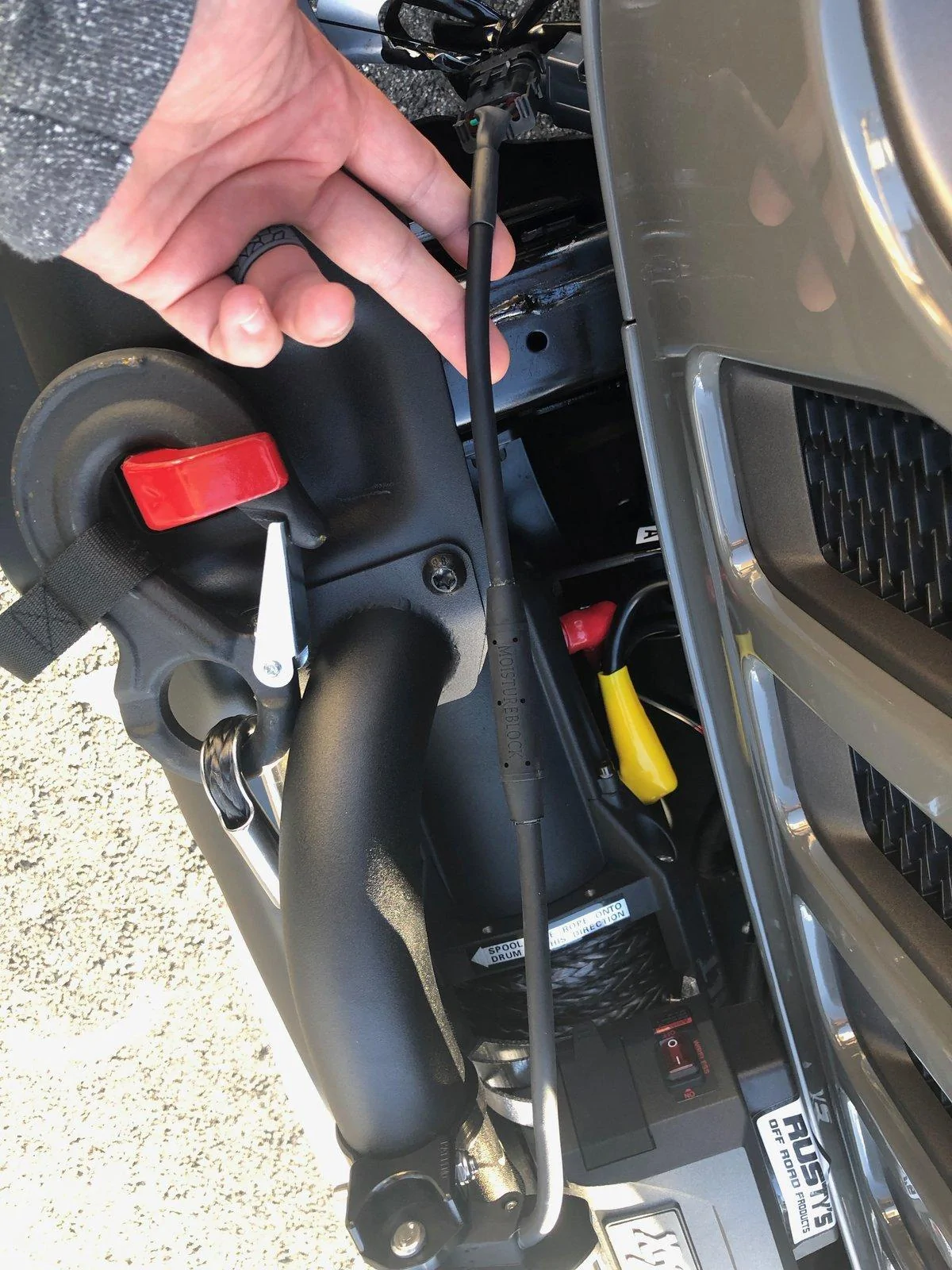

So the first pic is the cable coming off the light.

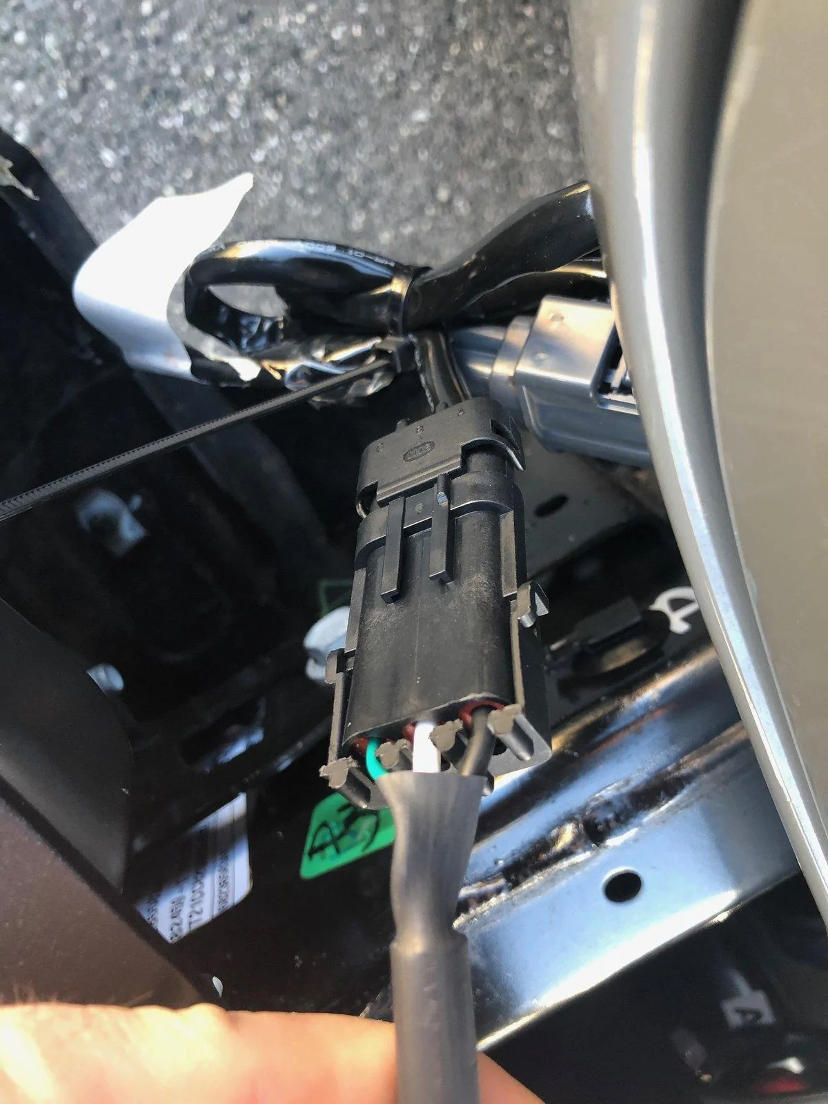

The second is the connection from the light bar to the wiring through the engine bay.

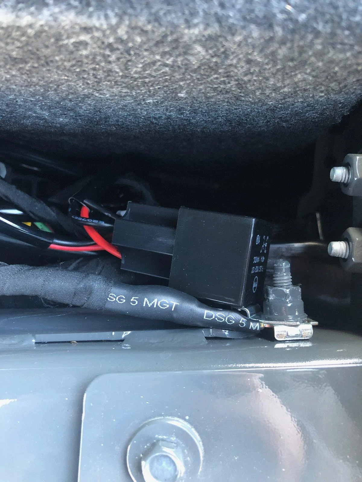

The third is the "relay" where the wires from the light end.
There is a black and red wire coming from it with an inline fuse. From that fuse, I have the black grounded to the truck and the red connected to the AUX for connection.
Are you saying I should cut all of that out and run just a red and black from the connection in the second pic to where I have the ground hooked up and the red to either AUX 1 or 2?

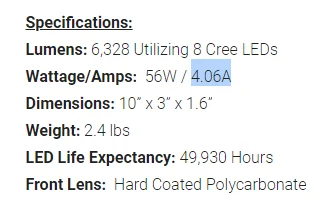

AUX switches 3 & 4 should work if it only needs 4.06A, correct?

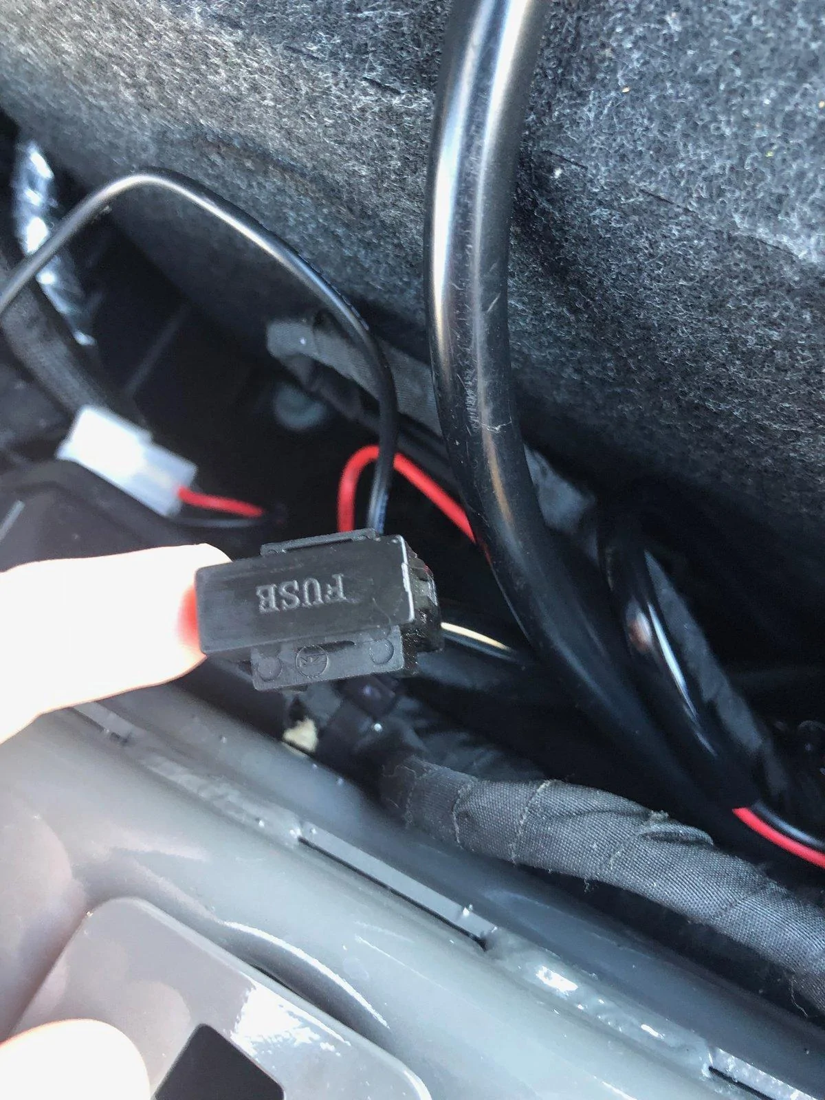

I'm assuming you checked the fuse? Sometimes they aren't shipped with one in the holder. Also could be blown
It's good. Double checked twice.
