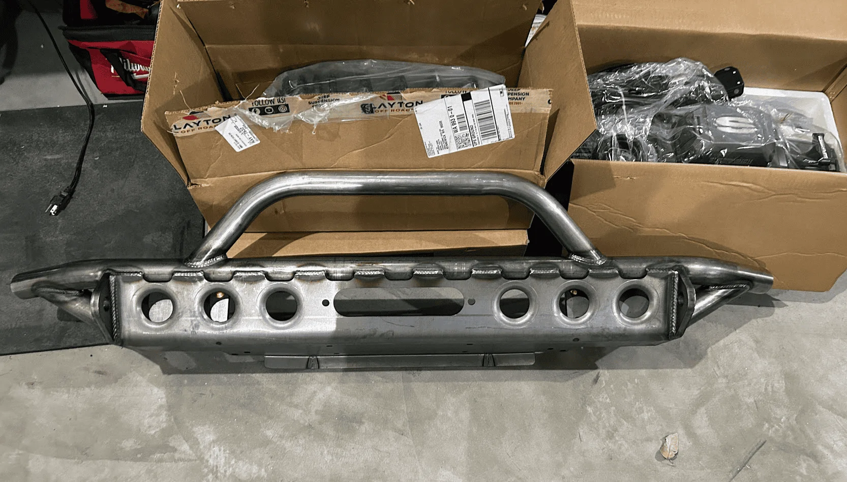

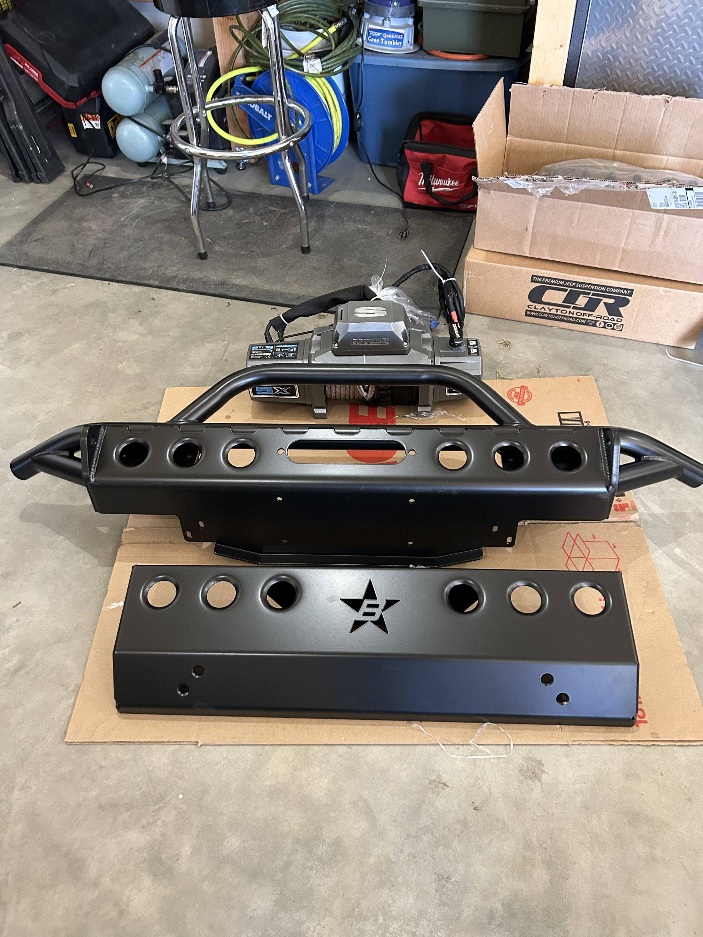

Barnes Pritchett Canyon bumper ready for powdercoat

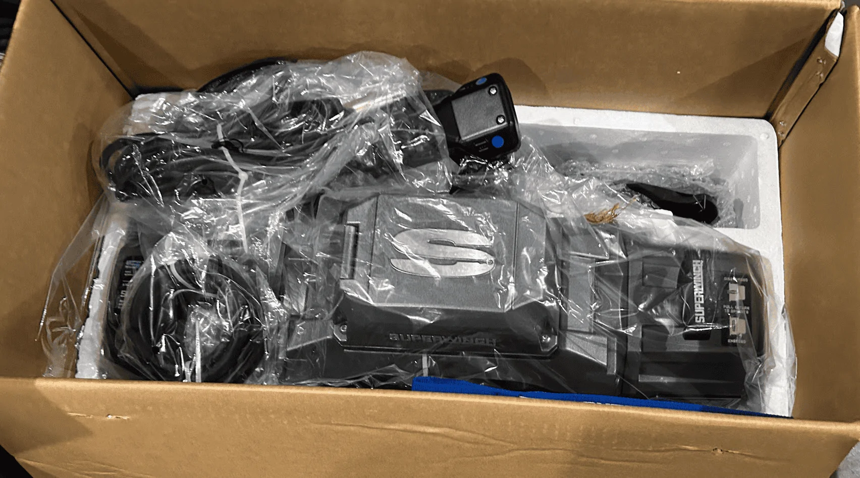

Superwinch SX10SR Ready for bumper to get powdercoated.
Jeep Wrangler JL MY23 JLUR 1674428313155
Still planning on installing bumper and winch first and then measuring, Clayton springs are here still waiting on Metalcloak front and rear adjustable track bars. Winch is heavy so kind of curious how much height difference after install.

Bumper and skid to powdercoat today. $375, seems like a lot but I have never really had much done. Another 2 weeks to wait for that. The welding on the Barnes bumper was outstanding and would highly recommend at this point but will see how it installs.

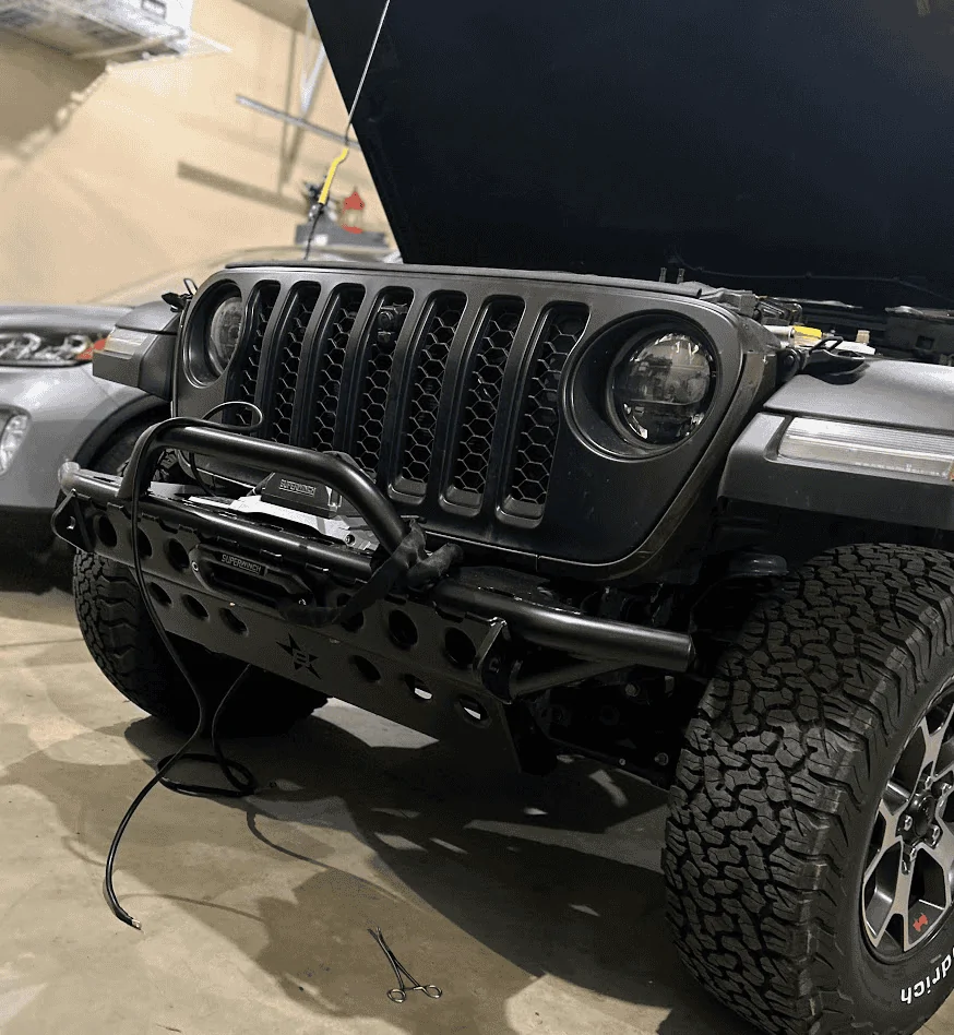

Bumper and winch installed yesterday, wiring left to do. Bumper installed well, great fit, winch pretty tight. I will get some better pics, height change, and install notes later.

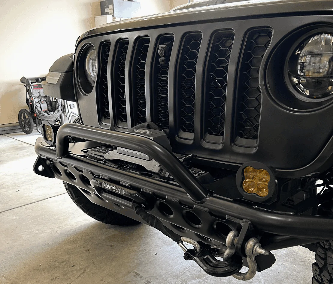

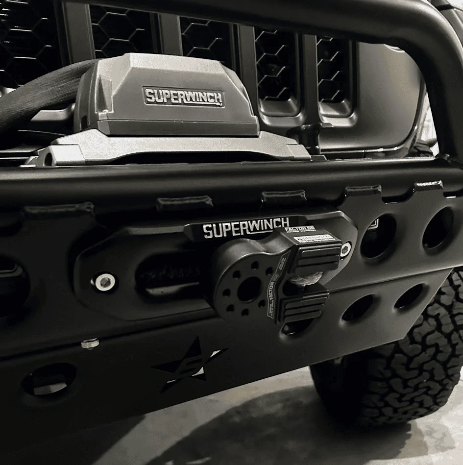

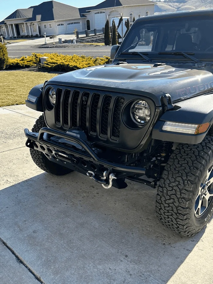

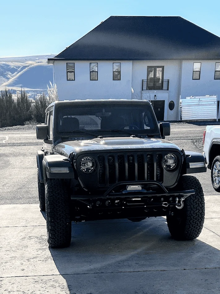

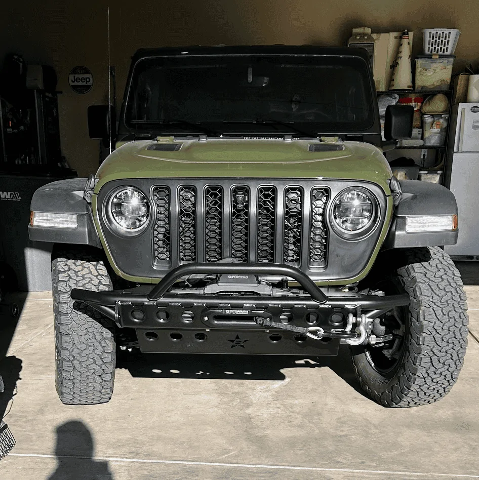

Finished up the winch wiring today and got everything buttoned up. Had to add some rubber where the winch wiring comes out of the box and some of the wires rest against the grill. The bumper wound up being a perfect fit and I really like the look. Probably would not have done the Superwinch if I were to do it again, its just too tight a fit. I added about 110 to 120 lbs with the bumper and winch and front in drop was minimal, maybe 1/2 inch. The bumper did not have space for factory fogs so I ordered some Diode Dynamics for mounting on the bumper. Emailed a bunch of questions to them and they were very helpful and great to deal with.
Still deciding on shocks, wheels, and tires.
Jeep Wrangler JL MY23 JLUR 1675026999414
Jeep Wrangler JL MY23 JLUR 1675027113749
Jeep Wrangler JL MY23 JLUR 1675027211317
Sorry about the poor photos

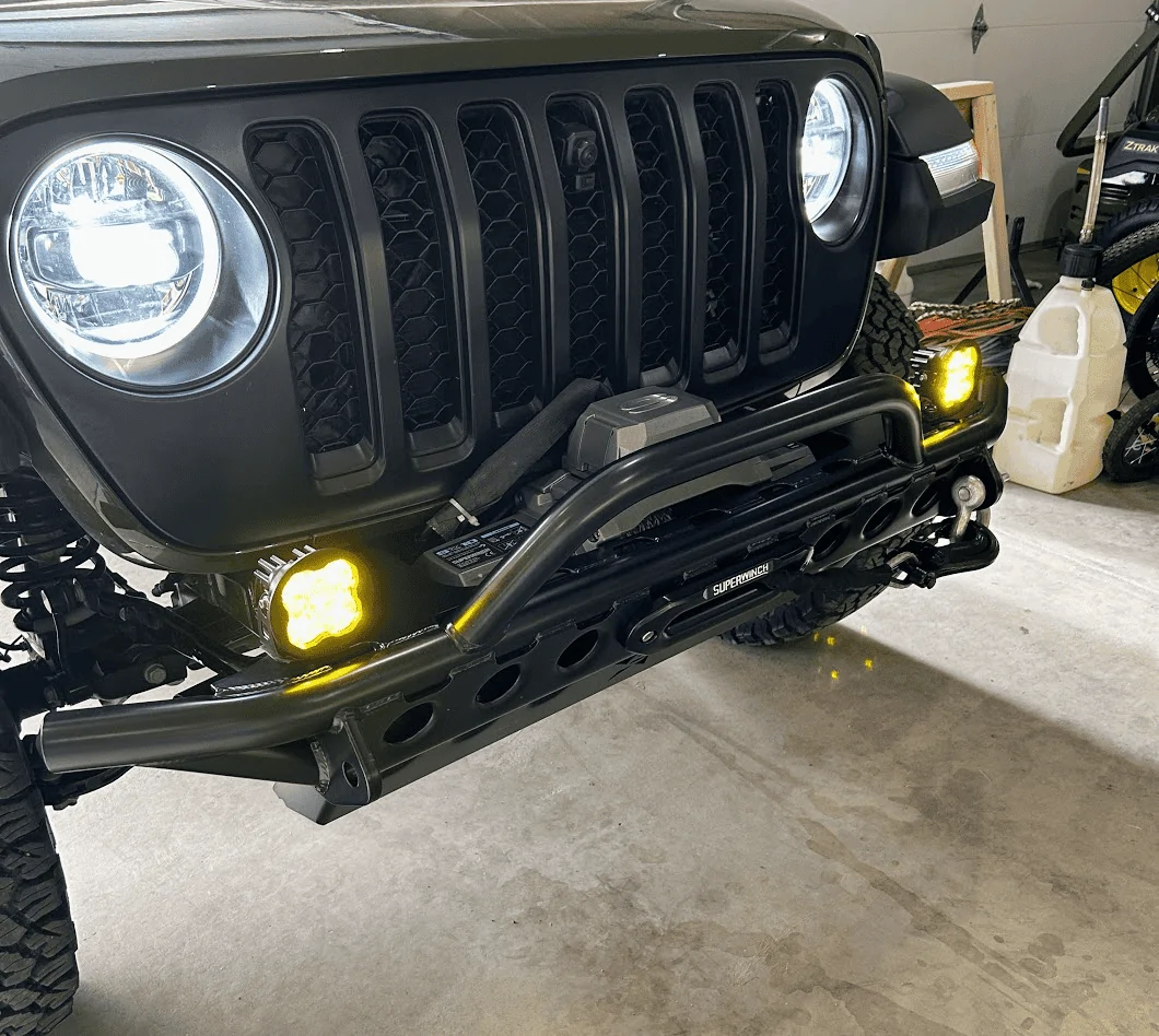

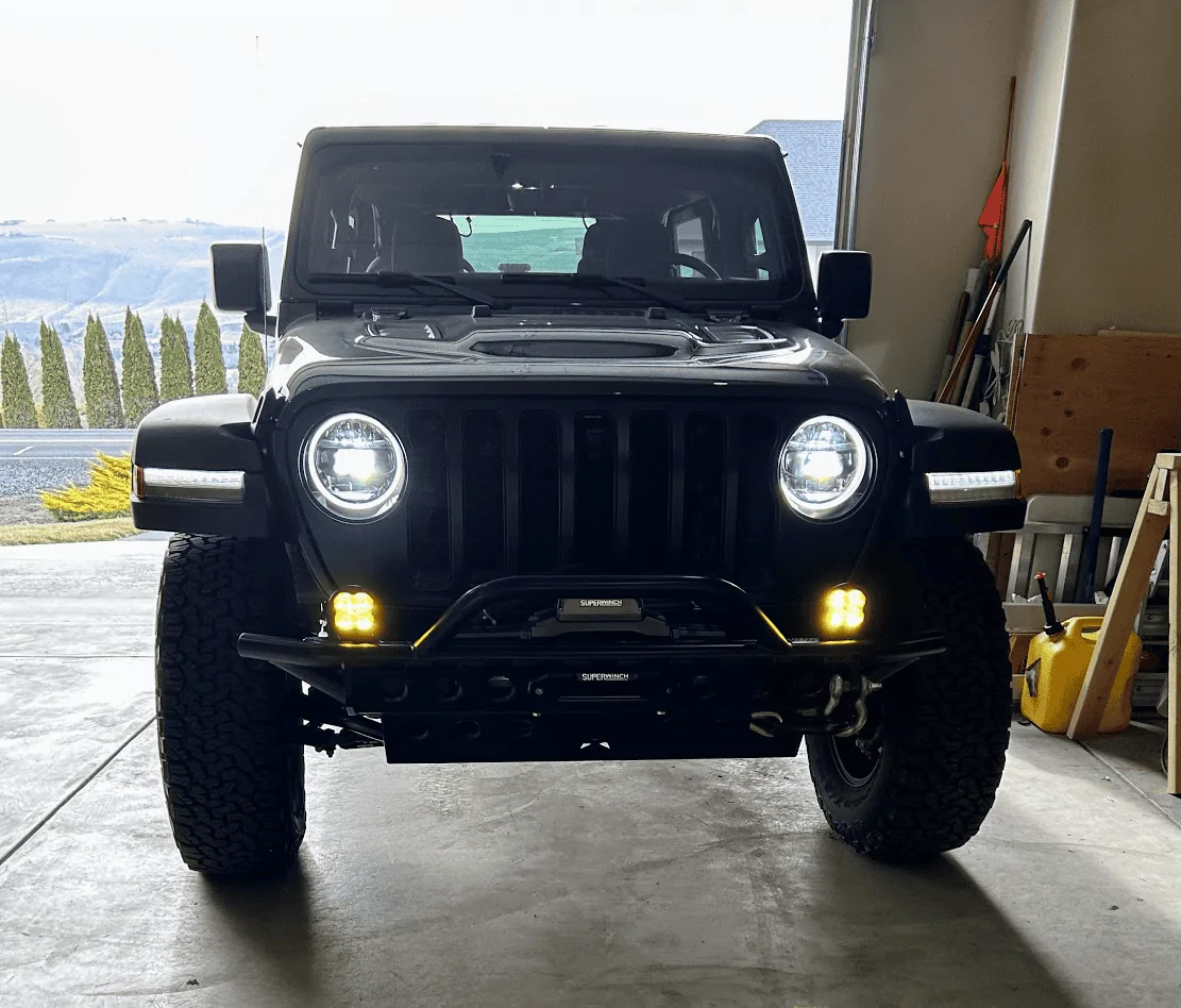

Added the Diode Dynamics Fog lights. Haven't really tried to know how effective but they seem very nice. Bought the wiring adapters and worked great with the harness from my plastic bumper. Diode Dynamics has been great to deal with and seams to make a nice product.

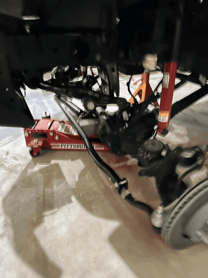

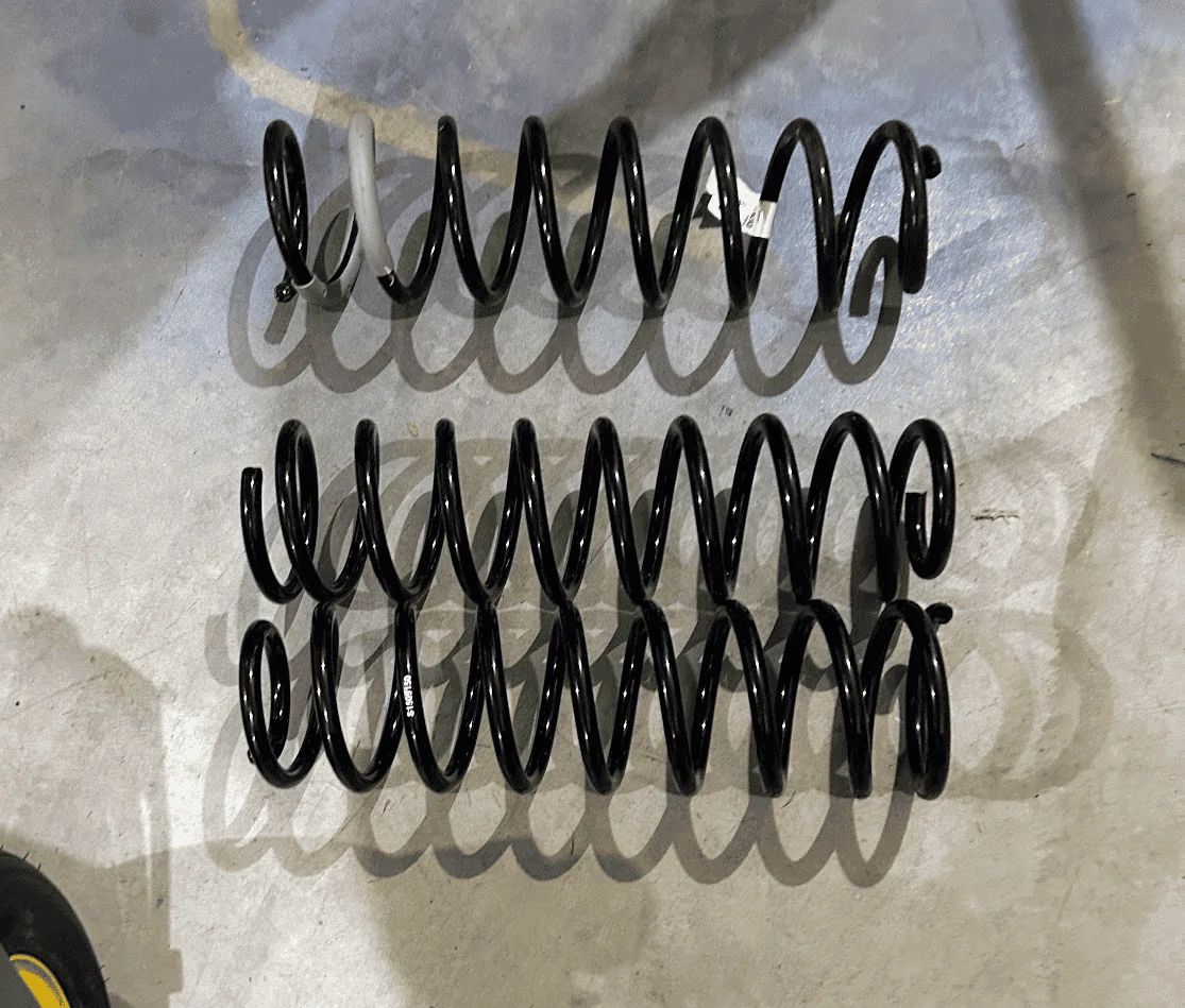

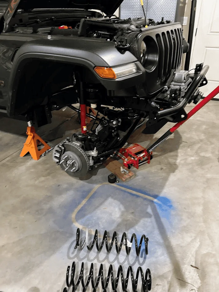

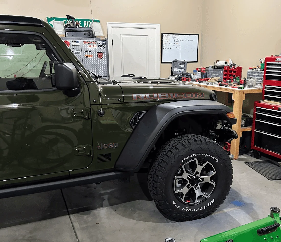

Decided to start in on suspension, kind of taking it slow. Did the front tear down and ready to add springs. Had to call Clayton, the new 1 1/2 springs, they are the same height as stock rubicon springs. They tell me the 2" gain is from spring rate. I bought the metalcloak bumpstops and they require drilling out spring perch so I left that till later. Think I will finish up the front Thursday. Here is where I am at now.
The 2 below are the Clayton and the single above is stock.
Jeep Wrangler JL MY23 JLUR 1675804496599
Jeep Wrangler JL MY23 JLUR 1675804588328
Jeep Wrangler JL MY23 JLUR 1675804631703

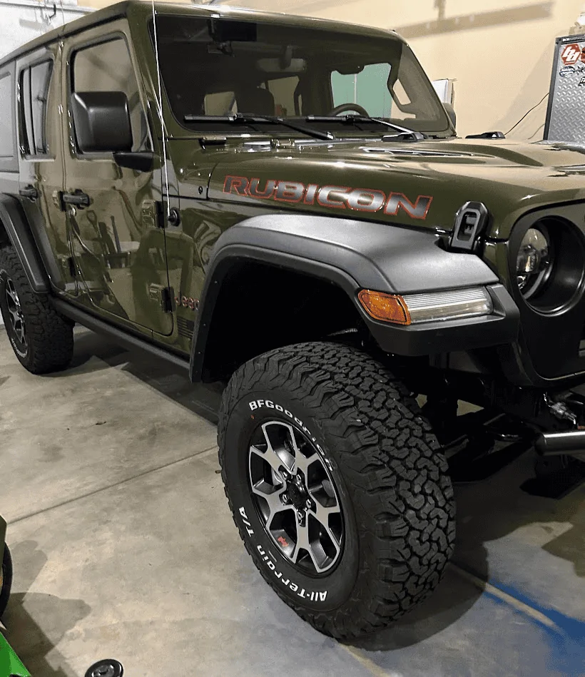

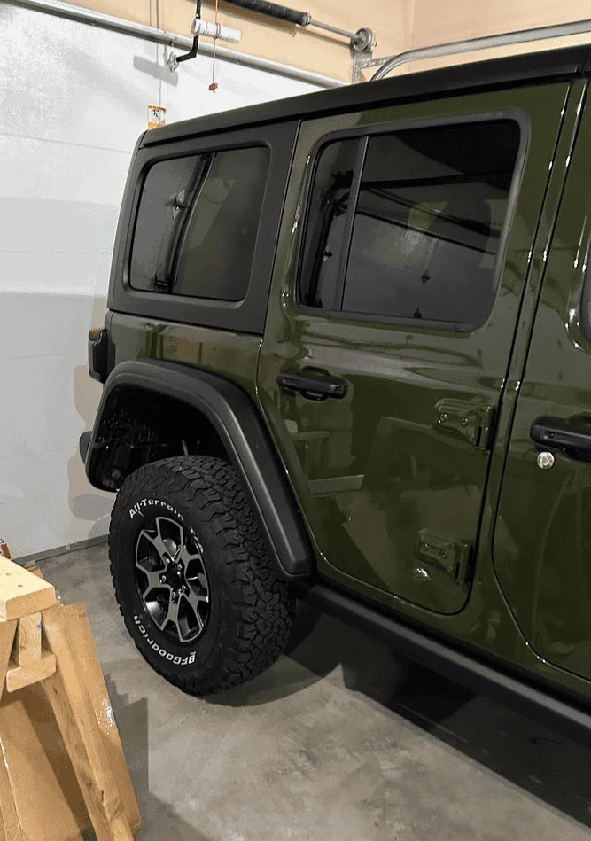

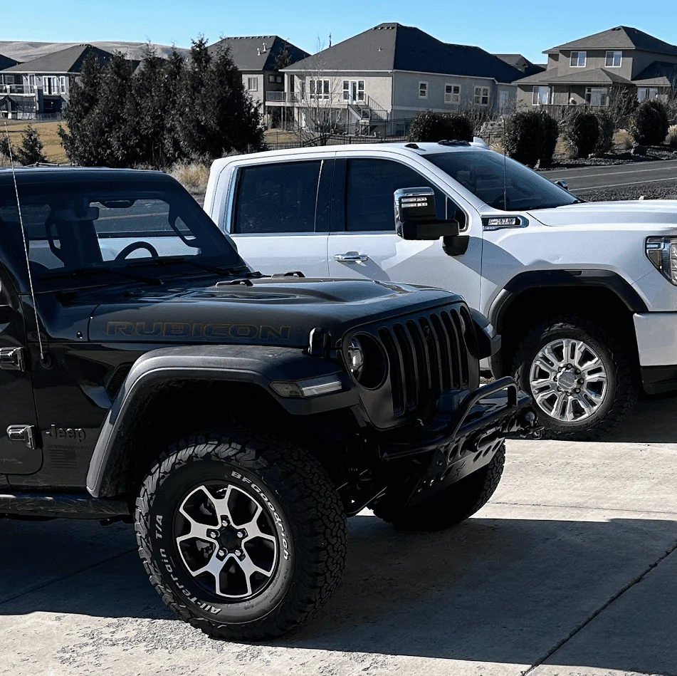

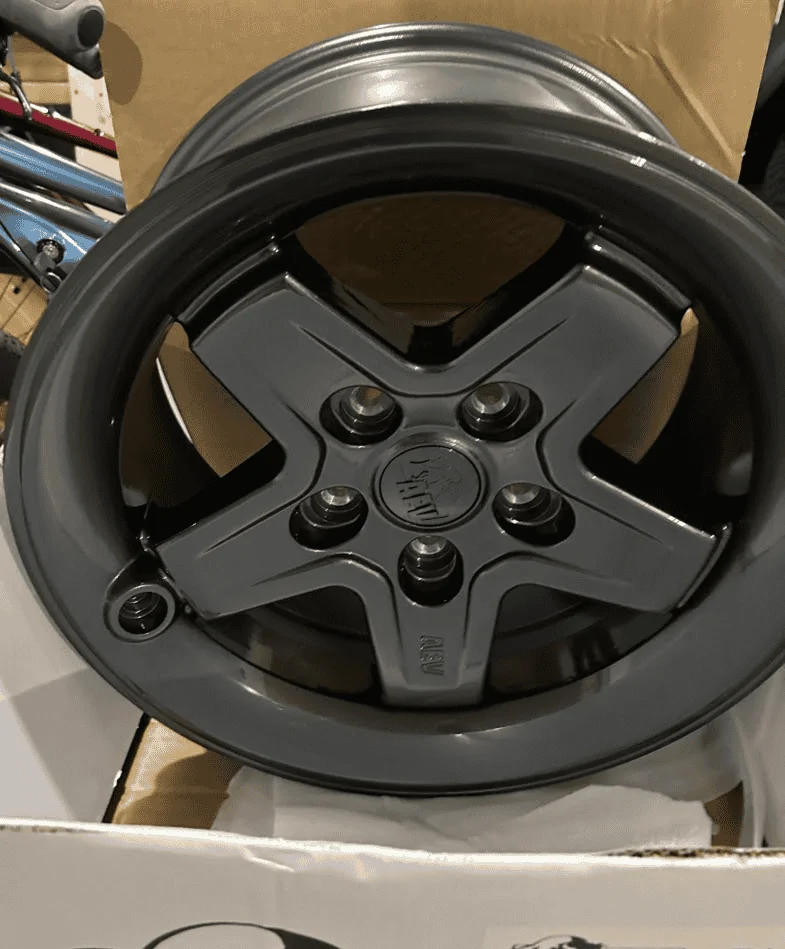

Finished up the lift today. The 1 1/2" Clayton springs netted me about 1 1/2 inches. Install was not too bad, seems like there is always something, had trouble lining up the upper rubber perch on the rear springs. I went with the Metalcloak front and rear adjustable control arms, not sure I would recommend as I had to spend quite a bit of time reaming the hole on the axle mount.. Think I had to do that with the steer smarts also though. I also added the longer Mopar front lower control arms. I did leave the stock shocks and the stock sway bar connectors, clayton did not recommend, I think it will be fine but will upgrade at some point in time. Received 3 of the 5 wheels yesterday, which was what Northridge had in stock, those guys are amazing at how quick they get stuff out if they have it in stock. Still debating tires, gonna drive it like this for a bit.
Jeep Wrangler JL MY23 JLUR 1676077348752
Jeep Wrangler JL MY23 JLUR 1676077559306
Jeep Wrangler JL MY23 JLUR 1676077402087
Jeep Wrangler JL MY23 JLUR 1676077456725
failsafe306
Oct 25, 2021
811
1,957
Tulsa
2022 JLUR 2.0
Curious why you didn’t upgrade to longer shocks. Did you at least install some extension brackets?
