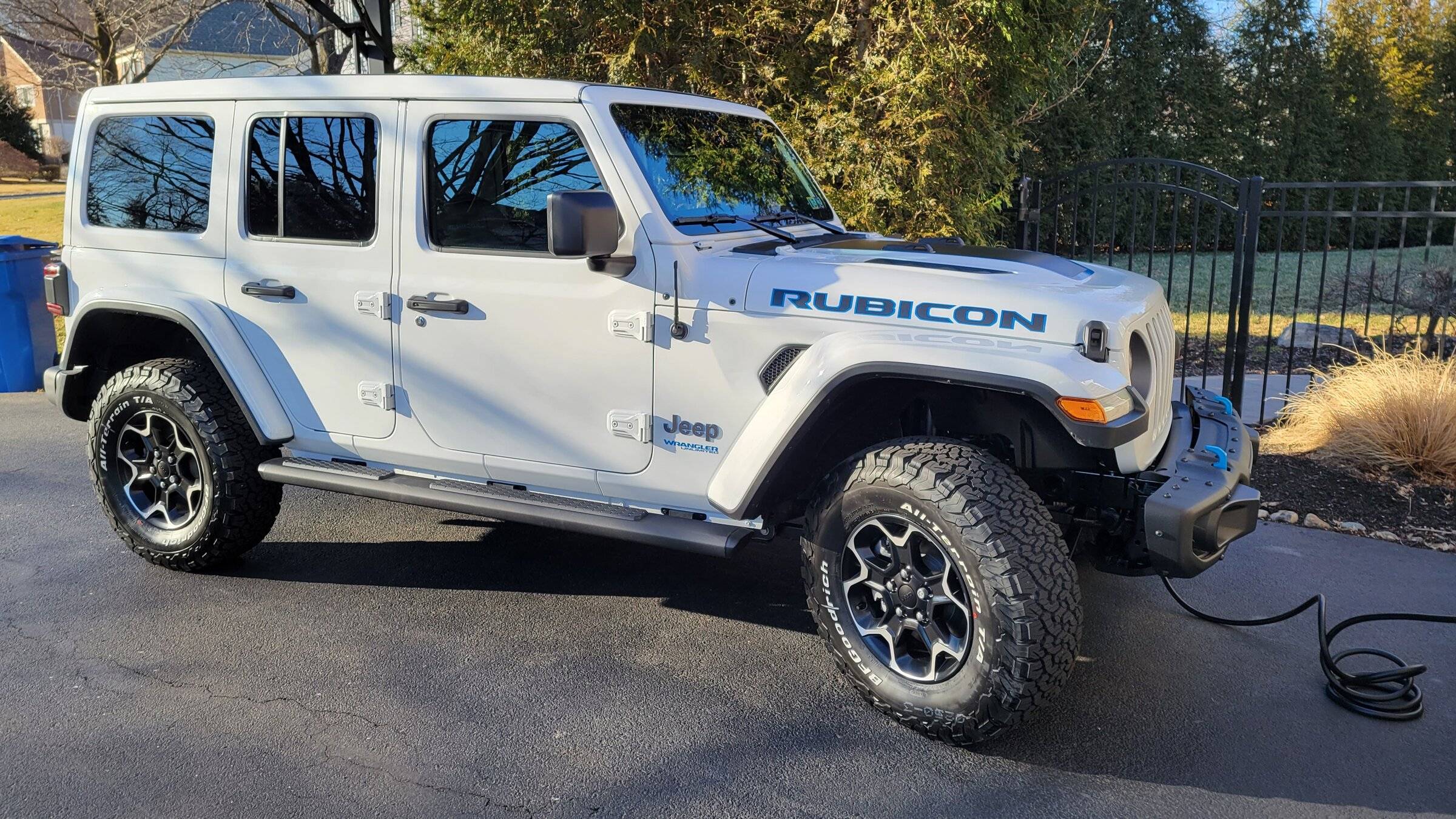

Looking to install "Sahara Style" Mopar side steps on a 2022 Rubicon 4xe.
Mopar Part:
Tubular Side Steps - Mopar (82215327AB)
Mopar website states it does NOT fit 2022 Rubicon 4xe. Search on Mopar for side steps on Rubicon 4xe returns nothing.
Has anyone installed these on their Rubicon 4Xe?

Had those installed by my dealer when I picked up my 4xe Rubi. Obviously, you lose the protection of the rock rails, but they look and function well (as a step) IMO.
Jeep Wrangler JL Mopar Side Steps for Rubicon 4xe? 20220303_161614

Same here. Worked perfectly.

Yeah I have them on my Rubicon as well.
It is a direct replacement for existing rockrails on the Rubicon so no issues with fitting, and you can reuse the screws for the rockrails on to the steps.
How much did the dealer charge? They look great!
