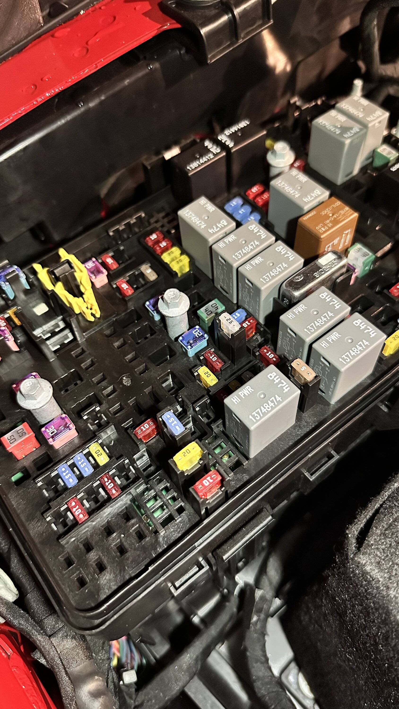

I was installing the Mopar aux switches in my jeep and I think I’m missing fuses in the fuse box for those 4 aux switches.
At first I thought my issue was a blown fuse so I ordered some fuses (come to find out now that they’re the wrong size) but when I opened up the fuse box I’m not seeing any fuses in the spots that they would go in. There’s only one 40 amp fuse in the F93 slot. The other 40 amp and 2x15amp fuses are missing I think. Is this the case or am I not seeing them? (This is a new 2023 Jeep)

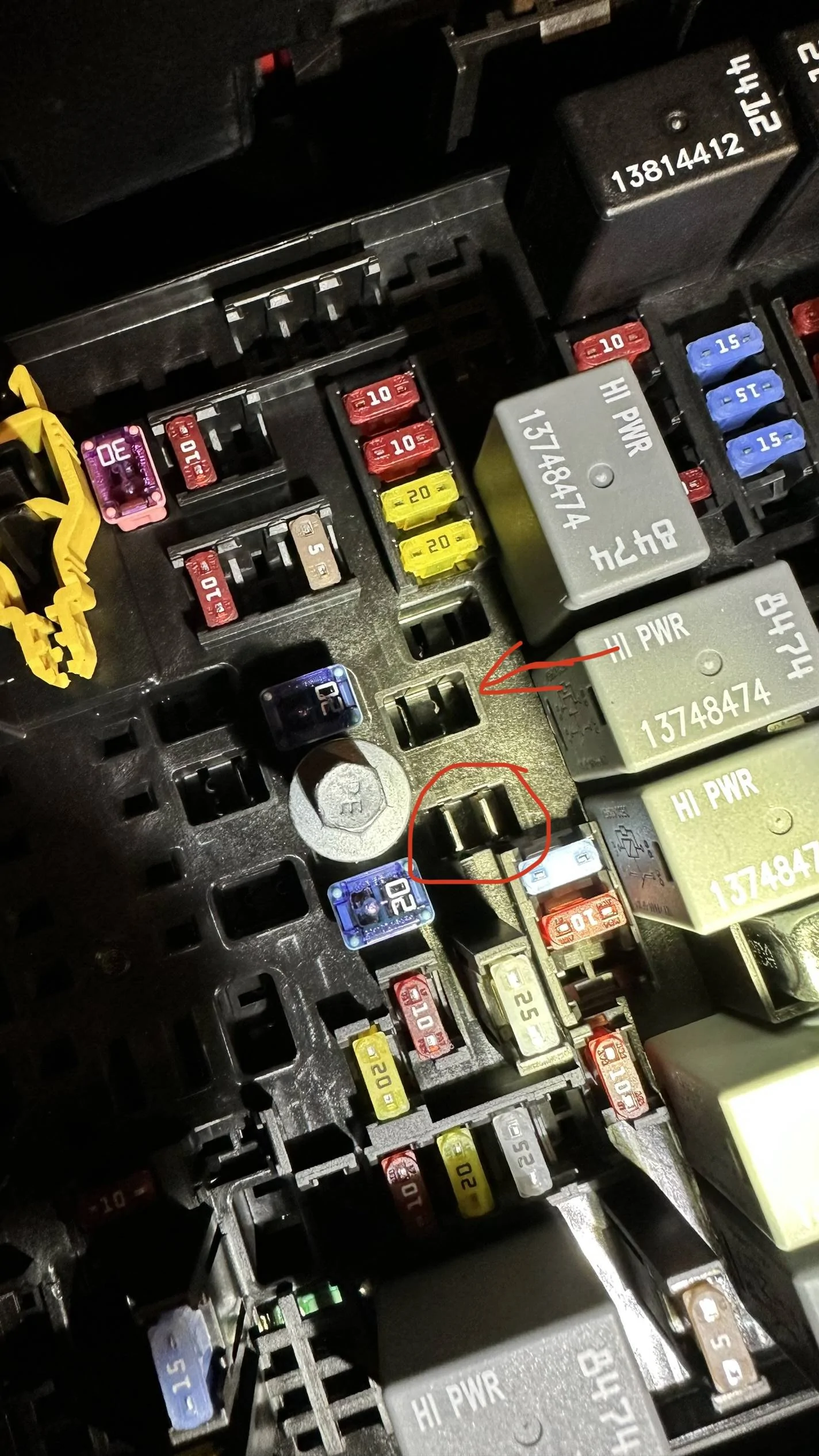

So now that I know that it didn’t come with the fuses, does anyone know how to get the other 40 amp fuse slot to have 2 prongs like the other ones? What’s involved in installing that?
edit: just realized I was looking at the wrong slots so I need 2 40 amp fuses but I also need them to connect with the 2 metal prongs. I’m not sure how to get those, this might be more complicated than I thought…
Jeep Wrangler JL Missing fuses for aux switches? F8AC70ED-46F7-4B88-9AB8-49ACAD21C652

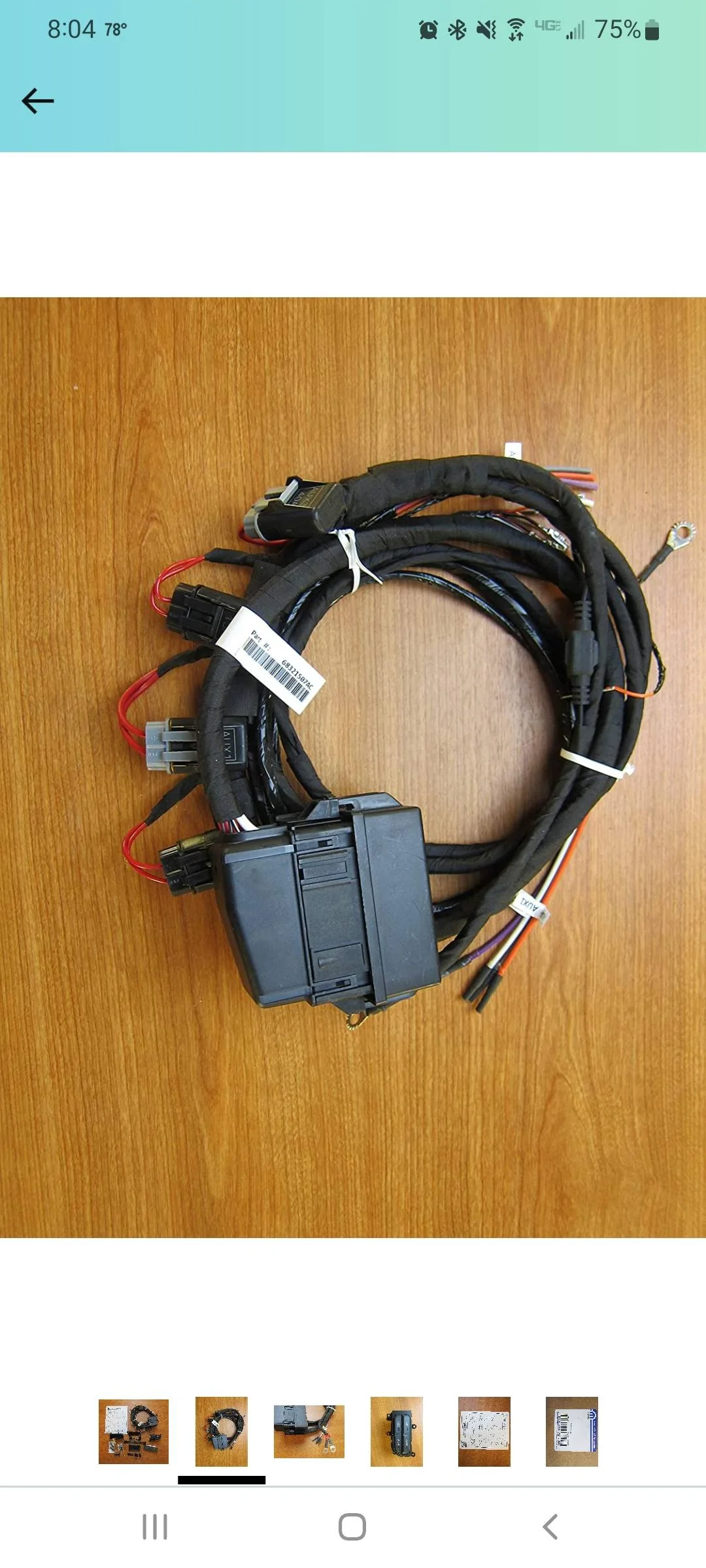

The aux switches should have come with the wiring harness, the fuses are not in the fuse box, they are in line with the harness. This shows the fuses from the full kit.
Jeep Wrangler JL Missing fuses for aux switches? Screenshot_20221101-200410_Amazon Shopping

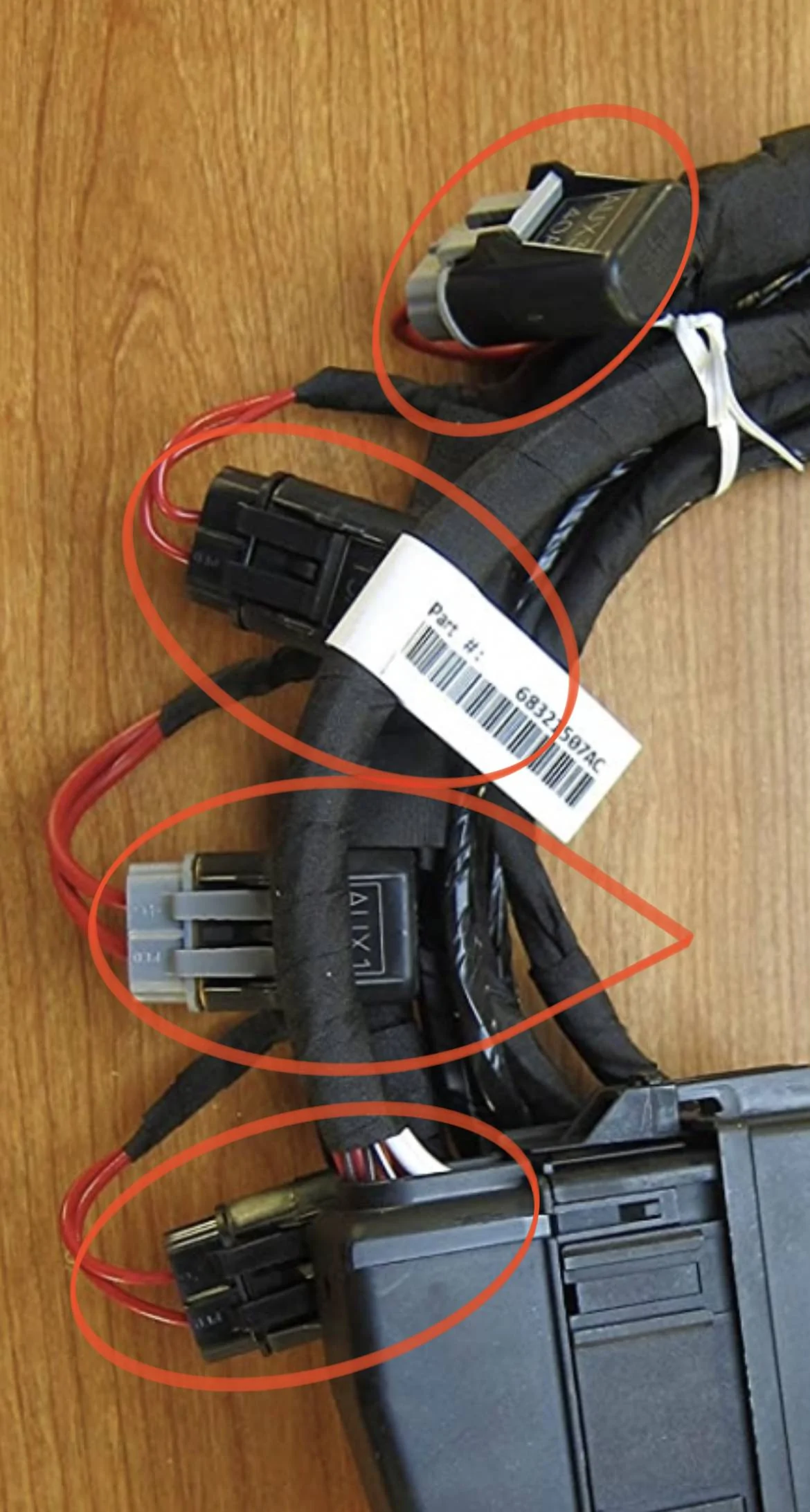

These are the fuse housings
Jeep Wrangler JL Missing fuses for aux switches? A1BE5211-E011-41EF-A5FE-D50376AB04D5
