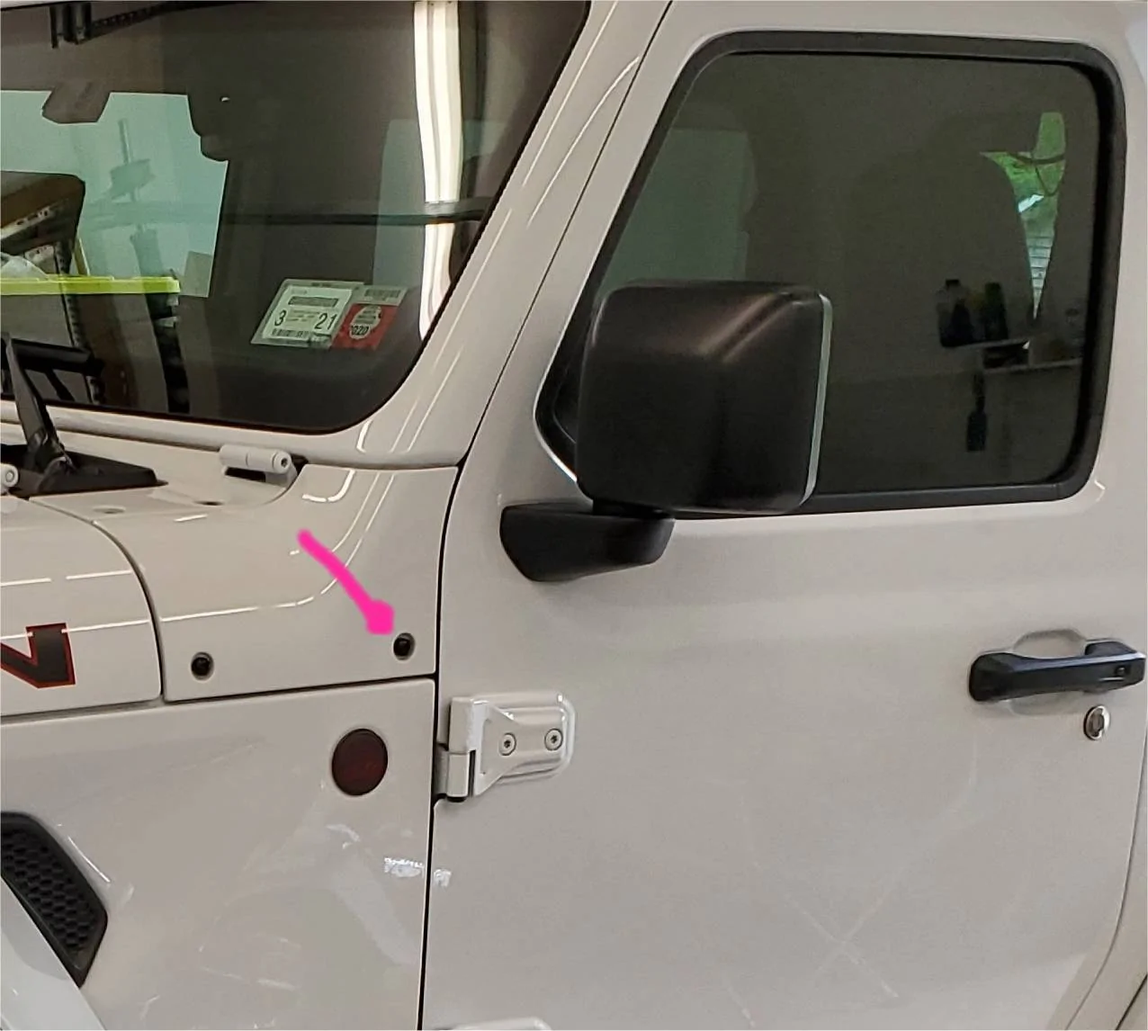

Had the doors off mirror kit on and have no idea what I did with the original bolts that hold the panel on (see pic). Anybody got a part number or know where can get a replacement bolt/washer?
Thanks!

Dealer can order them most likely. Or pull off the other and try to match it with something from Ace.

Found it! Its part # 6512430AA if anybody else ever puts there bolts in a clever location never to be found again.

For those that would consider same.... as a low cost, valid alternative for side mirrors.
Atermarket mirrors with 8 mm ( 8 mm is the size of the 6512430AA bolts for the cowl ) stems will easily screw right into the cowl bolt hole..
Harley mirrors.... and say..
"Kemimoto Universal Motorcycle Mirrors, kemimoto M8 M10 Threaded Bolt Double Take Mirror for Scooter, ATV Kawasaki, Suzuki, Honda, Victory got them on Amazon for $23.00"
