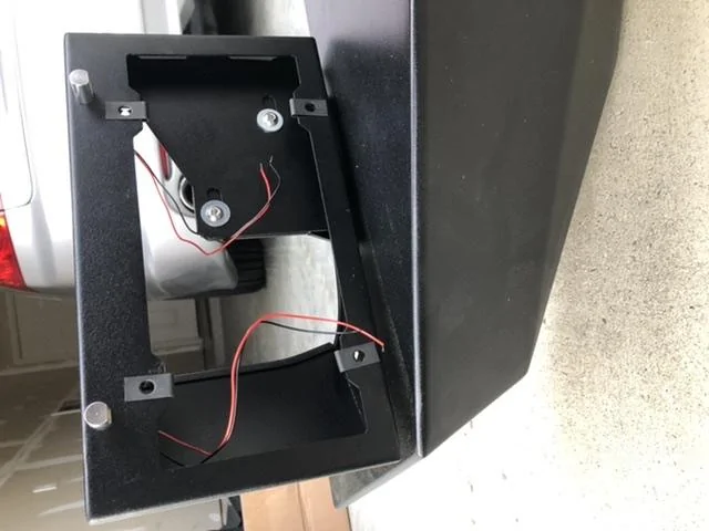

Does anyone have the LOD off-road license plate relocation to the side for the drivers side?
I am looking for an installation guide in the wiring for the lights to the license plate.
Any help or pictures would be appreciated! Thanks!

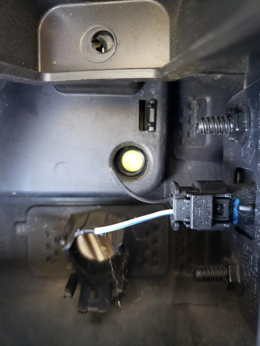

That one is easy, when you remove the stock bumper you un plug the original license plate light, Cut the plug off of the wiring harness and splice the wires from your 2 lights in. Your red wires splice to the white wire with the blue stripe from your harness. Your black wires splice to the black wire. Picture below is of the stock plug, the rest of the harness is still attached to the jeep. Hope this helps.
