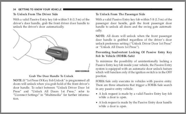

If the outside door handle has the little button to lock the door then it has passive entry or it’s supposed to.
If it’s not working, it could be a problem with the door harness connector. There have been reports that the internal pins get bent and don’t connect properly. They can usually be bent back.
With that said for the passenger side to work, you would need the key fob near the passenger door when attempting to open. Your passenger can not simply open the door before the driver door is opened/unlocked unless they also have a fob. As others have mentioned, there is a setting in UConnect that controls how the doors unlock.
Just want to make sure it’s actually not working vs. just a setting needing changed vs. trying to use it as not designed.
See owner’s manual page below.
