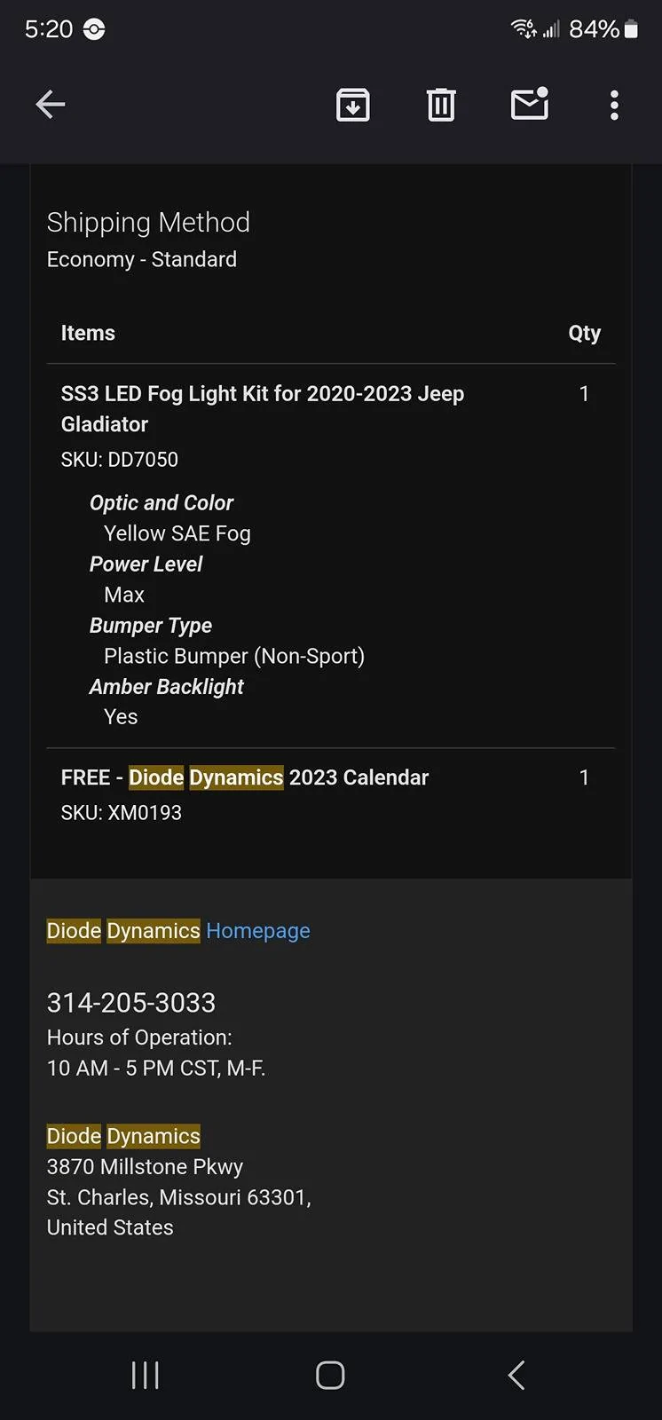

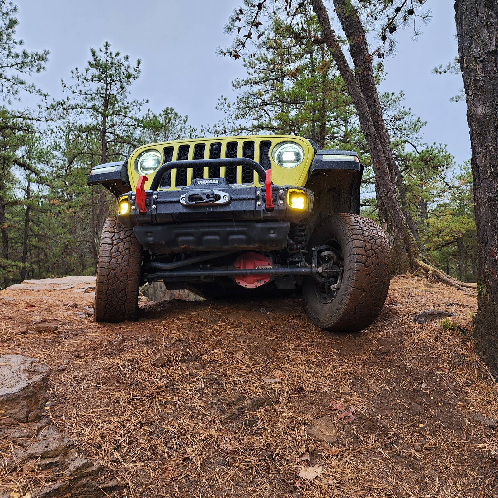

I run the SS3, and this is how they sit, which isnt ideal. Cuts the front center light dispersal. These lights are crazy bright though.
Theres some SS2's and brackets I have that I plan on mounting to the bull bar for center coverage.

too recessed right? It cuts out your side shooting.

Side spread is great on the open side. Very noticeable with the yellow. You just dont get any center front cross over from the two lights beam patterns being blocked in that direction.
If you pull the lights all the way forward, they look awkward, but will give you a slightly better fog beam overlap.
The design of the bumper just seems to suck in that regard. Not much to be done about it unless you feel like chopping and welding it into a different fog light area.
