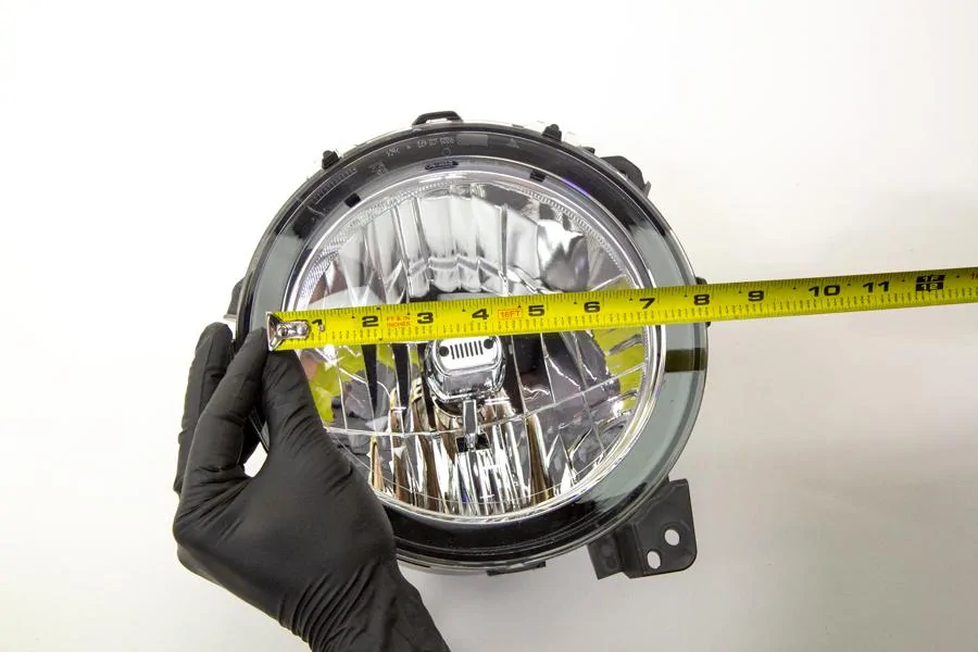

If you measure the actual light reflector, the JL only has a 7" headlight....

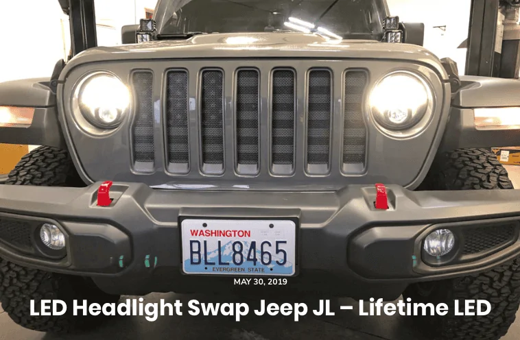

Here's a set of JW Speaker J2s in a JLUR using Lifetime LED brackets and H-13 pigtail:

@Grimace-912: We carry the Lifetime LED JL brackets and H-13 wiring pigtails in stock. They're what we used in the above pics to install the JWS J2 8700s in Malo's 2018 JLUR (Northridge4x4's marketing director) and will work with the J3 beautifully.
We did just get an email from JW Speaker last week that they are releasing their own JL conversion bracket, we just don't have a set ETA for when those will be arriving.

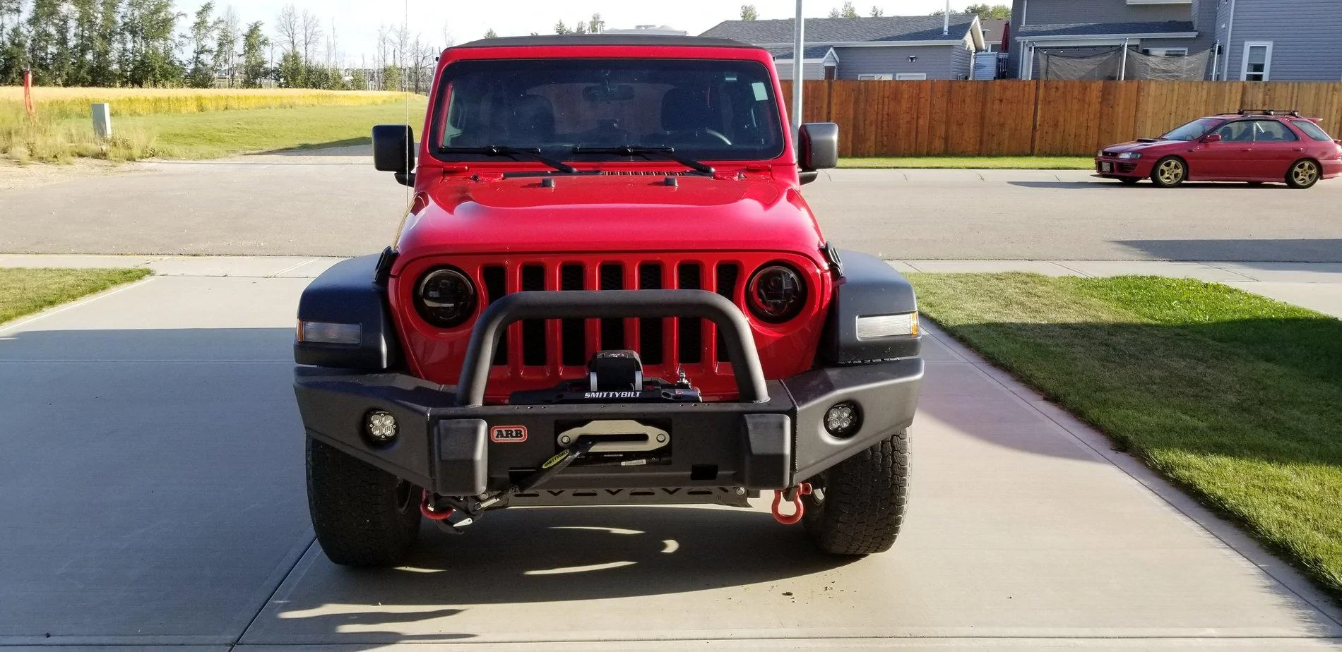

I just Installed my J2 lights and followed your DIY write up, ordered the parts you mentioned from Northridge4x4 Ponoka Alberta. and everything went just perfect. Thank you for you write-up. I recommend this to anyone with Halogen lights, all in it only cost about $800 CAD for 100X better light.
sidenote: the DRL work as well.
