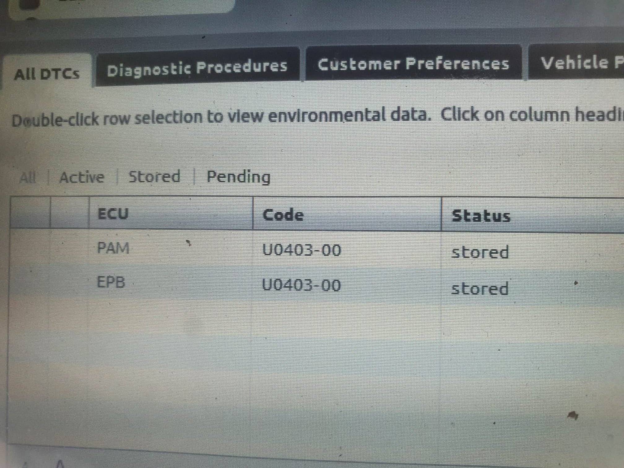

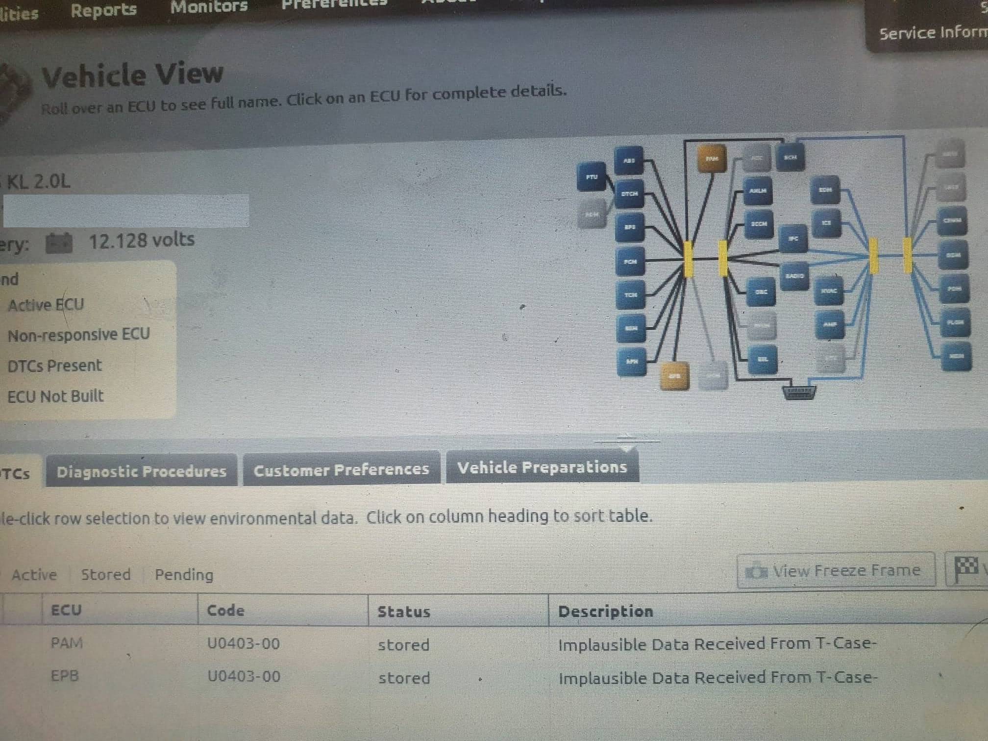

If I give the actuators a re-learning of the fork position, I get the following error code U0403-00 (Implausible data received from T-case) on two modules PAM (park assist manager) and EPB (electric parking brake) and no longer wants to do re-learning, the wheel spins but only nothing moves.

I also replaced the DTCM computer with a new one, exactly the same symptoms, if I reset it on the computer I get the error code U0403-00 (Implausible data received from T-case) on two modules PAM (park assist manager) and EPB (electric parking brake),

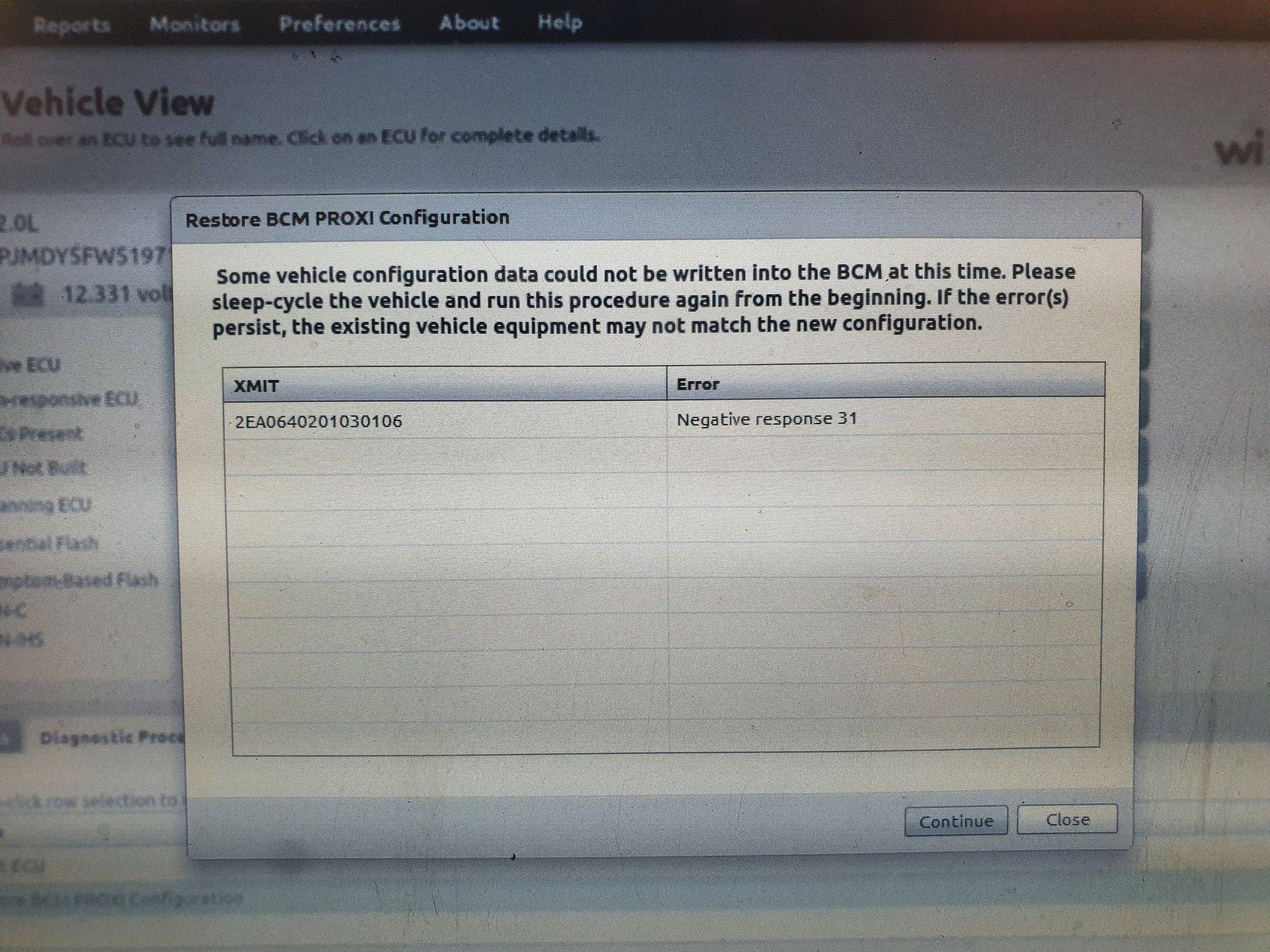

I tried to make BCM restore proxies after the chassis series, the operation starts and then it takes me out and the following error code appears Negative response 31.
