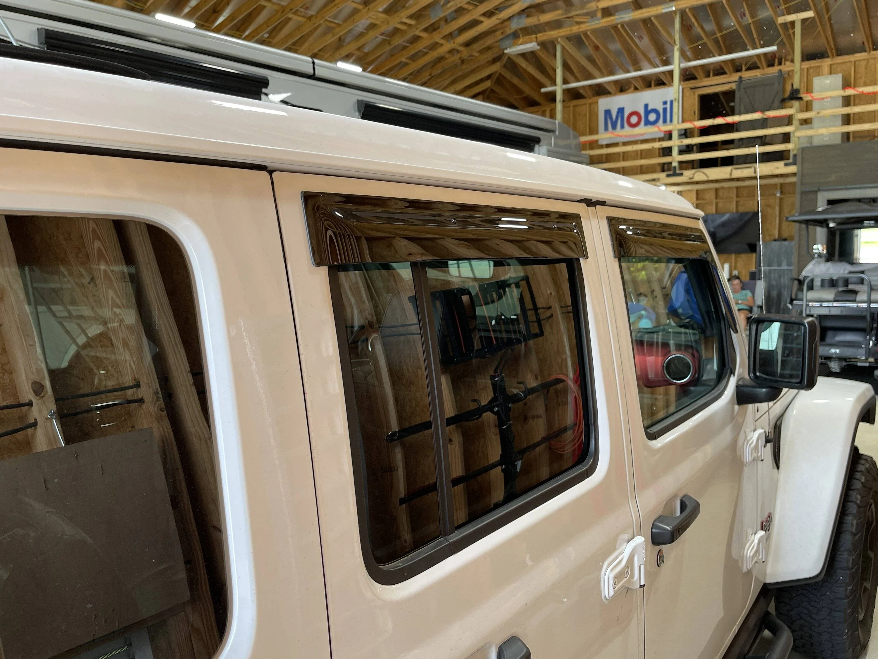

If you plan on installing the Jeep OEM window vent visors, invest in a millimeter tape measure as everything was in mm.
It was a 2 hour job measuring, marking with non permanent marker, pulling down window seals. After the 1st side all went smoothly. Between the 3M tape and clips under window seals these window vents are not going anywhere.
