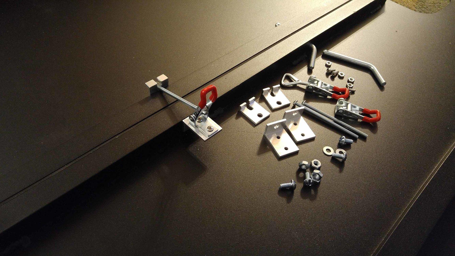

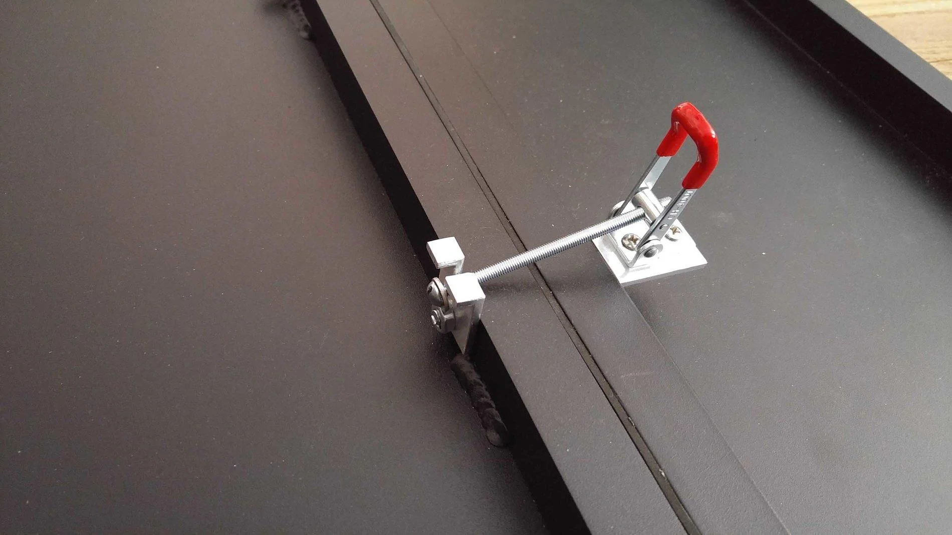

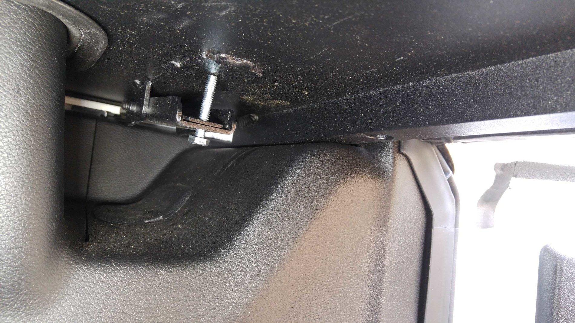

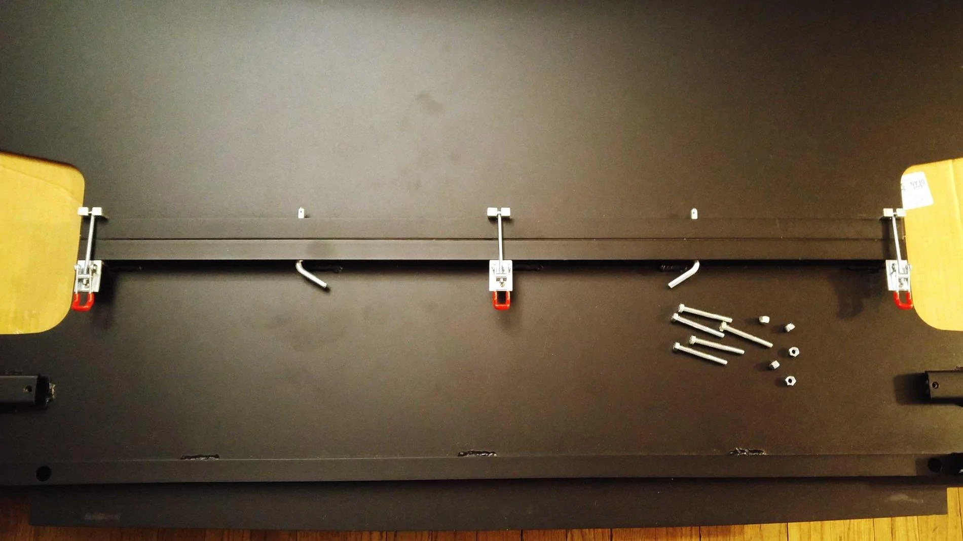

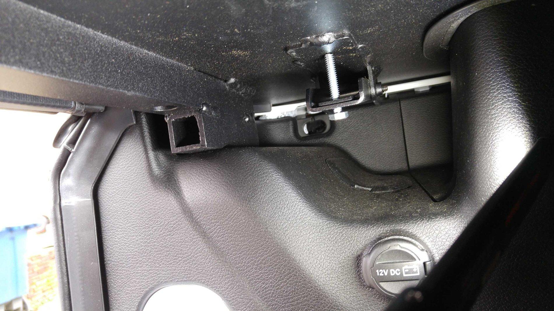

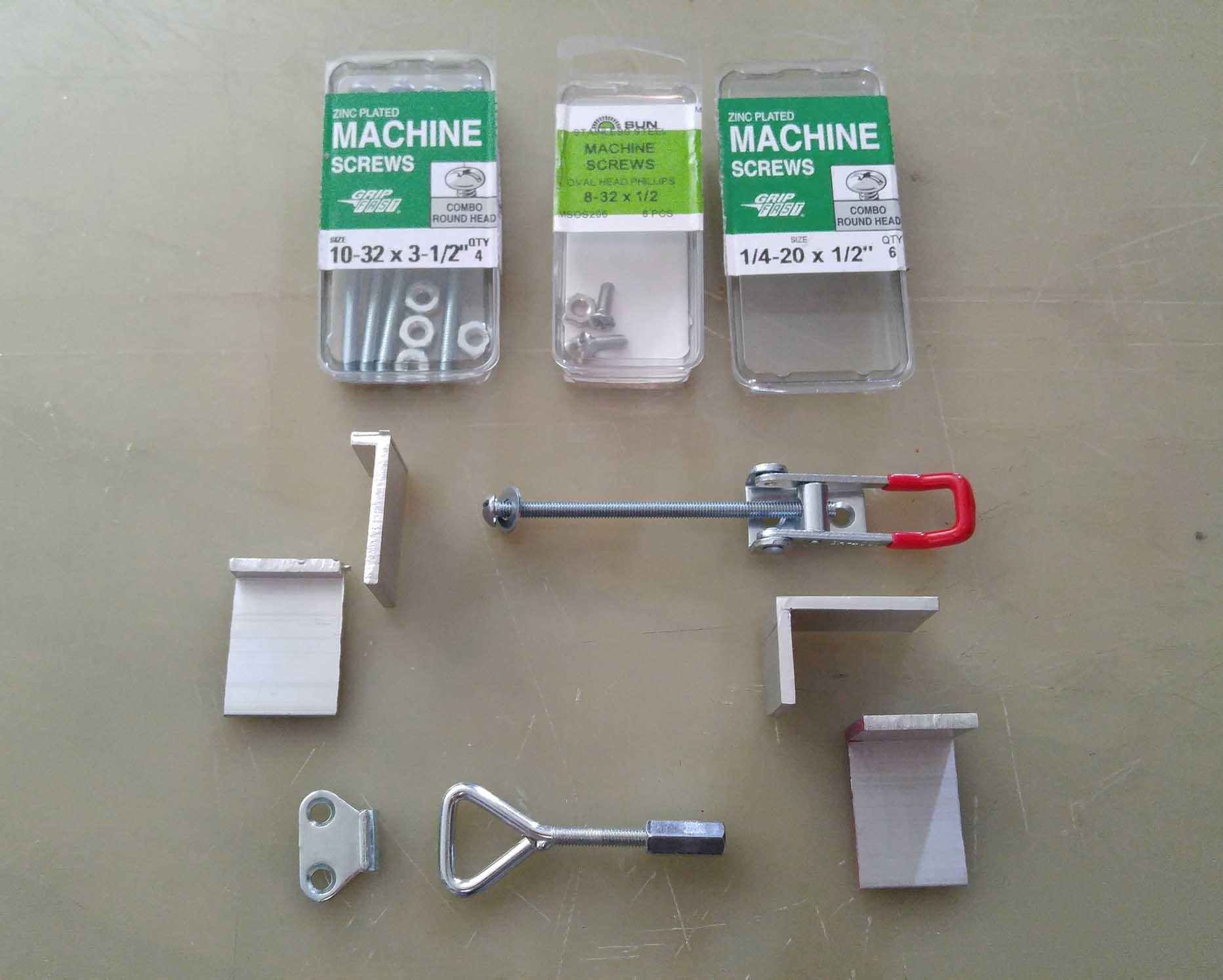

Here's my latest modification. I've had it in and out a few times and the latches work great. I am concerned about damaging the paint if I accidentally bump it with an edge during installation/removal so I put some door edge trim on the edges.
