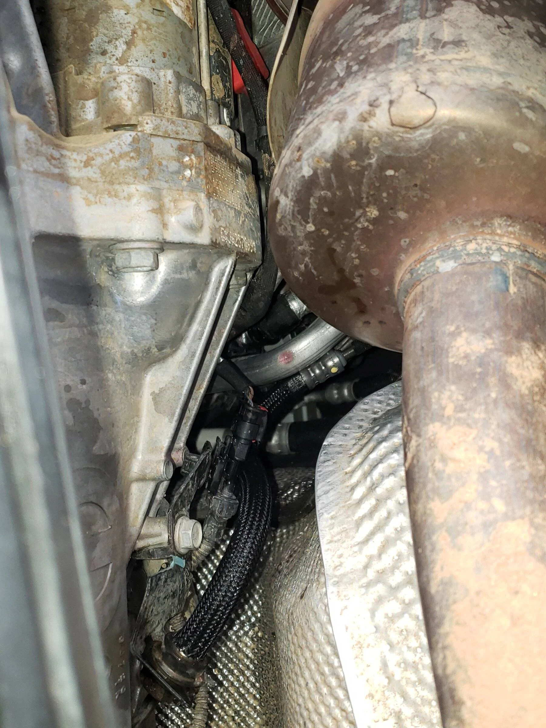

If you have a manual transmission (possible auto but lines might be ran different) check to see if the (2) lines are rubbing like mine are. (can't visually see how bad it is you need to feel between them on the aluminum pipe) the metal collar has rubbed through the aluminum line on mine causing the coolant leak. The picture is from the driver side between transmission and exhaust. I'm going to reach out to jeep but want to see if yours are the same or if there is supposed to be spacer I maybe missing somehow. If not jeep needs to add a spacer and do a recall before more come up. Thank you. 2018 JLUR 3.6L M/T.
