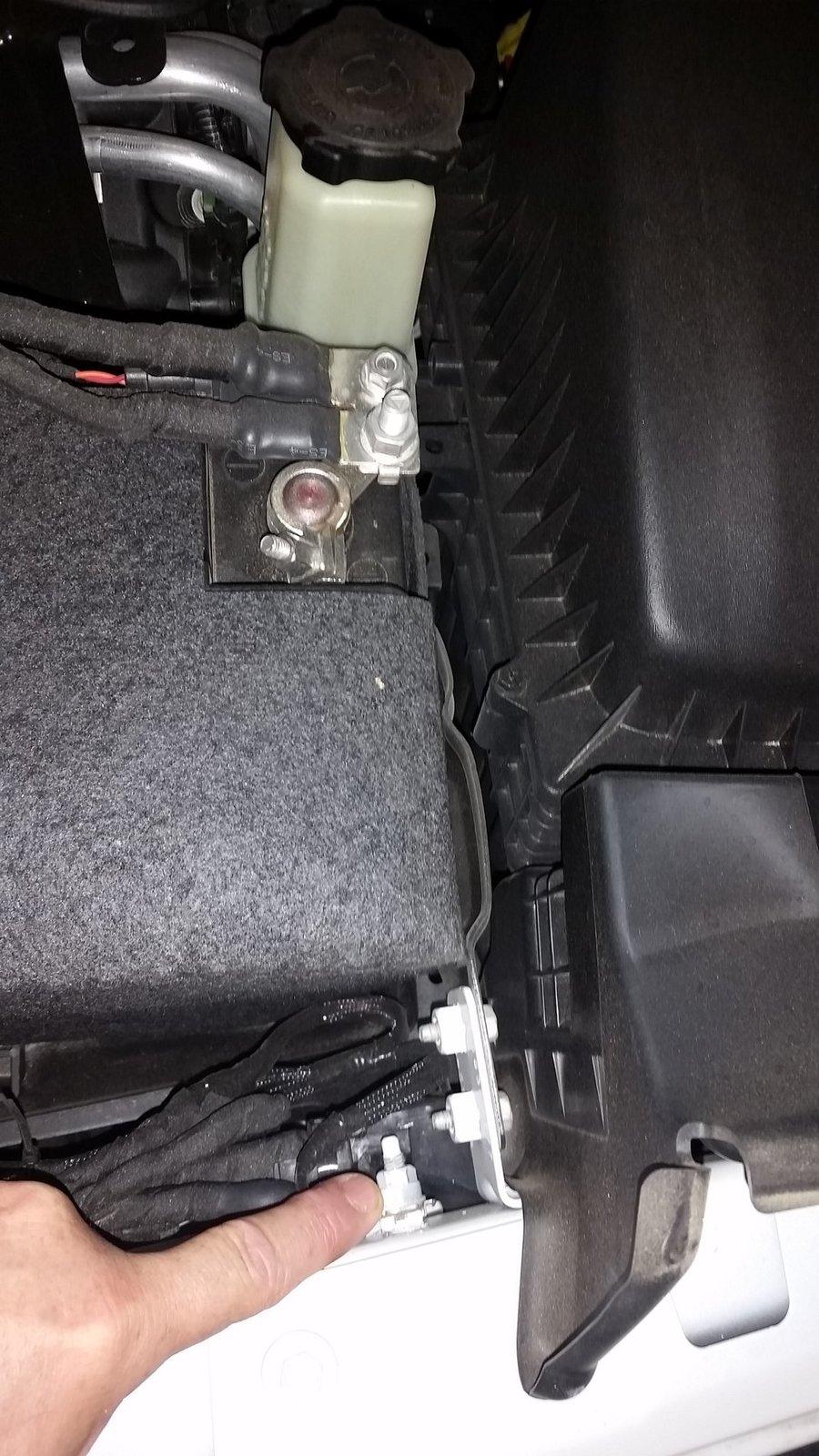

Why are you going to ground to the battery? Just attach your black wire from the light to a grounding point. Leave the battery alone...
Here is a grounding point by your Aux wires:
See finger pointing to attachment point...

I will do this. Thank you my friend! I didn't get to wire them up tonight but I will at some point this week. Thanks again!
