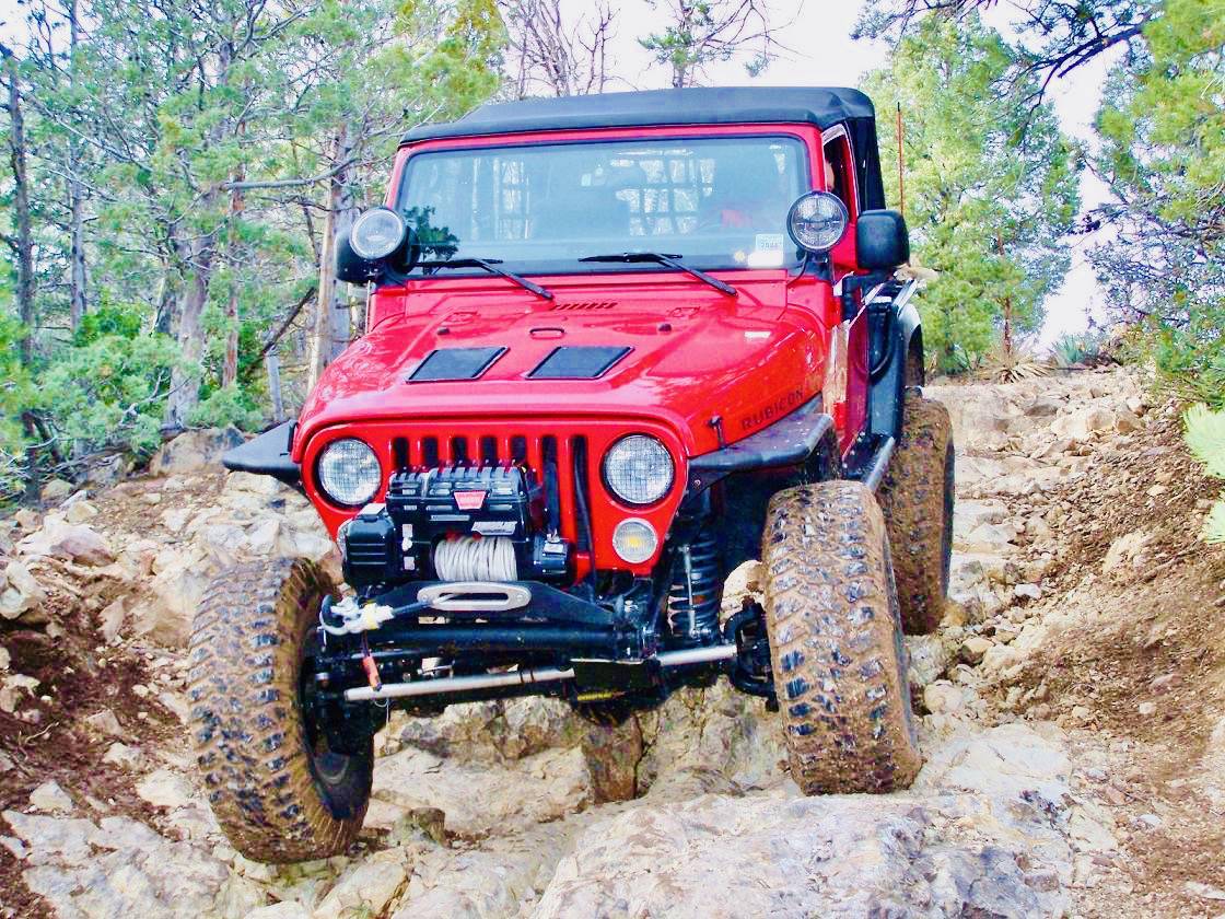

I had REAL issues when I lived in Scottsdale, AZ with overheating and I installed these, which come off of a Turbocharged Chryslers car of some kind. They are located just above the radiator at the front and extend back to the front of the engine. Solved my problems...
Jeep Wrangler JL Hood Upgrade Hood vents
