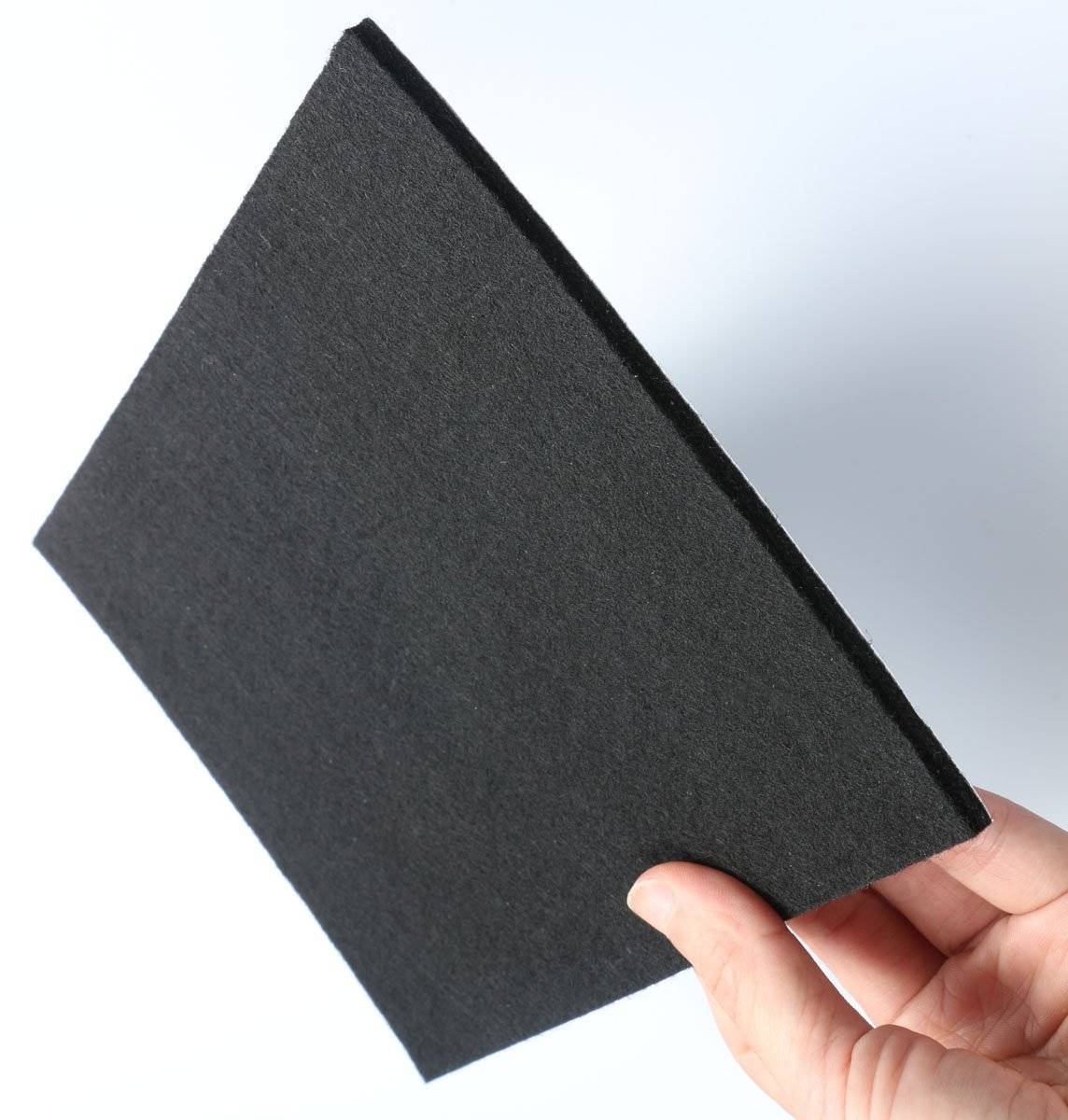

For those with damage / holes, etc. in the Mopar Hood Silencer Pad
This product offering sticks to the silencer pad really well and looks very similar to the pad.... Works great for patching/coverup ...
I used for a patch 3+ years ago and the patch is still in place and has never let loose...
https://www.amazon.com/gp/product/B0140K7N00/ref=ppx_yo_dt_b_asin_title_o01_s00?ie=UTF8&psc=1
RERIVER 6" X 8" X 1/5" Thick Heavy Duty Felt Sheets
  • Fabric- Black matches the JL's interior really well... blends right in
  • Heavy Duty Felt Pads 1/5" thick
  • 8 sheets- approx. 6" x 8 " (150mm x 200mm). You can easily cut to desired size with scissors
  • Self-adhesive, just peel and stick
  • Reduce noise and friction
