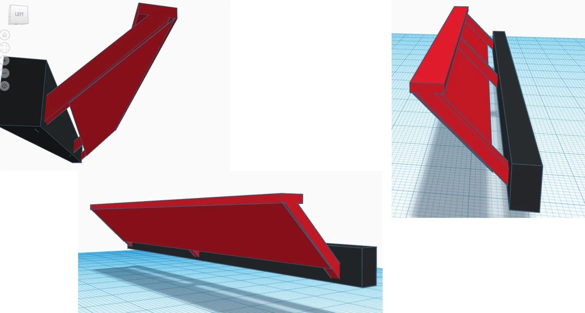

Been looking for a rocker and step combo since the 37s and metalcloak 6pak GC go on next week, but the only designs I liked were LoD and Ace. I also wanted 100% made in USA. Luckily I'm in the panhandle area with a lot of military bases so there's a lot of talented metal fabricators. Here's the design I shared with him and I've got a follow up with him soon after he finishes the current project. Looking to keep as simple and functional as possible. Looking at 5 pieces. 3 will be 2x2x.180 that weld to the frame, then 3x1x.120-.180 for the step, and a 1/8" plate that will be removable in case it takes too much damage and needs to be replaced. Leaving a gap at the bottom for water/debris can drain. Let me know if you guys have any great ideas that would make this thing awesome.
