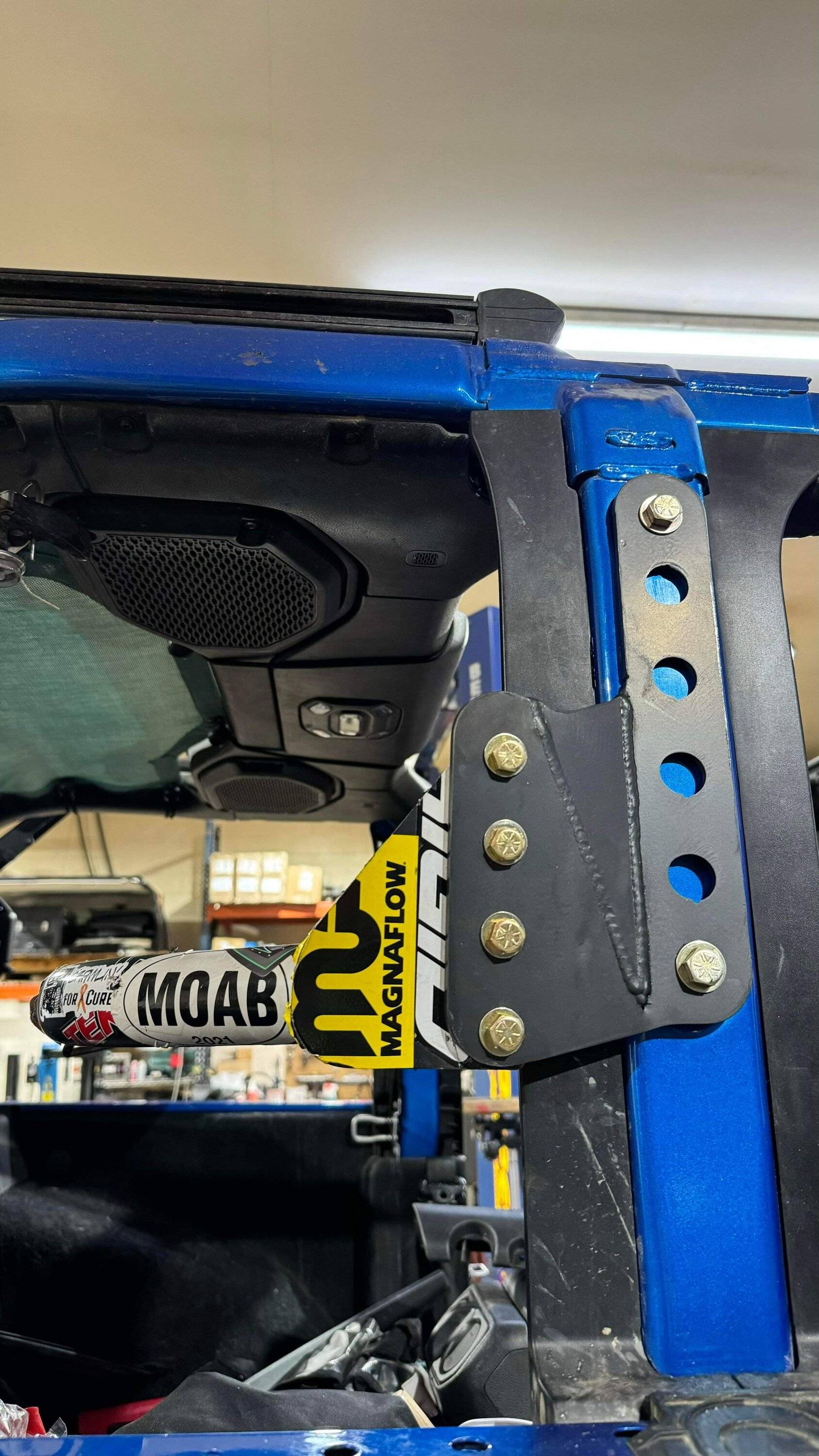

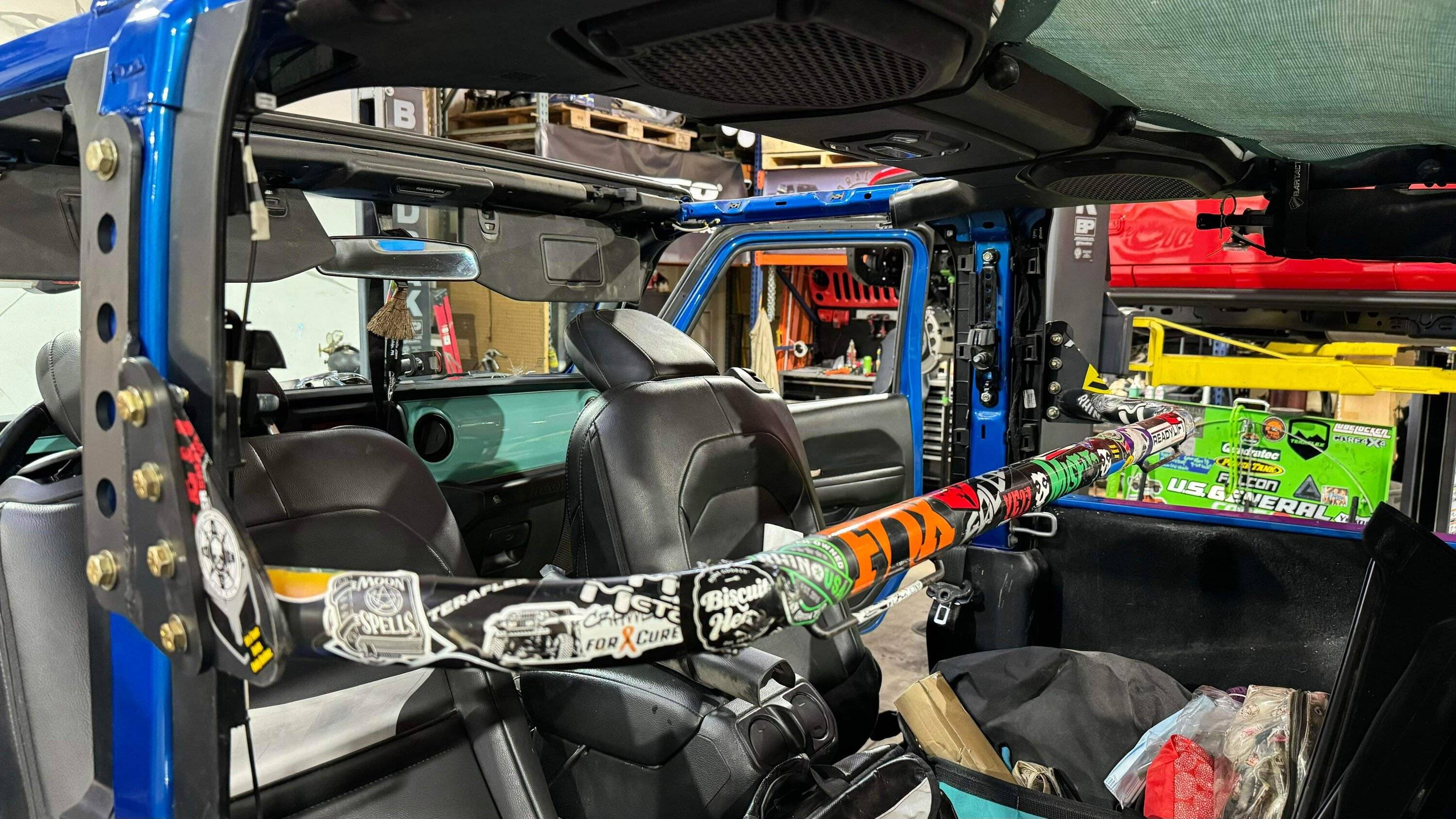

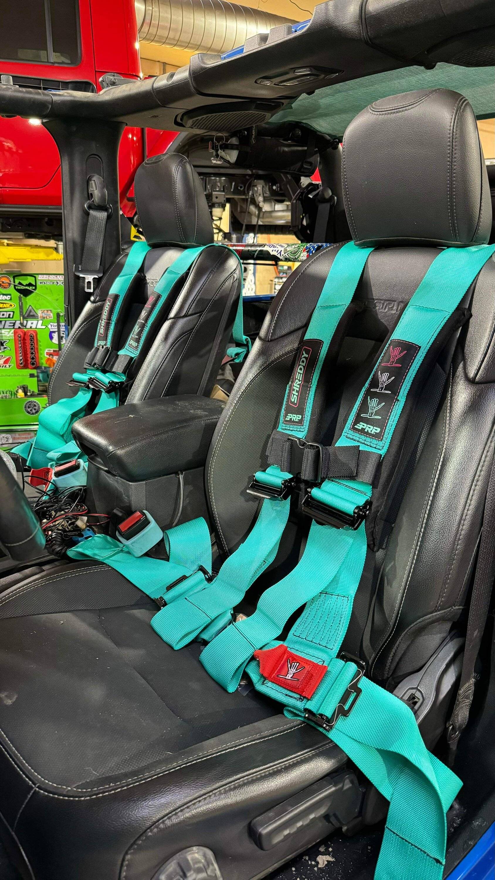

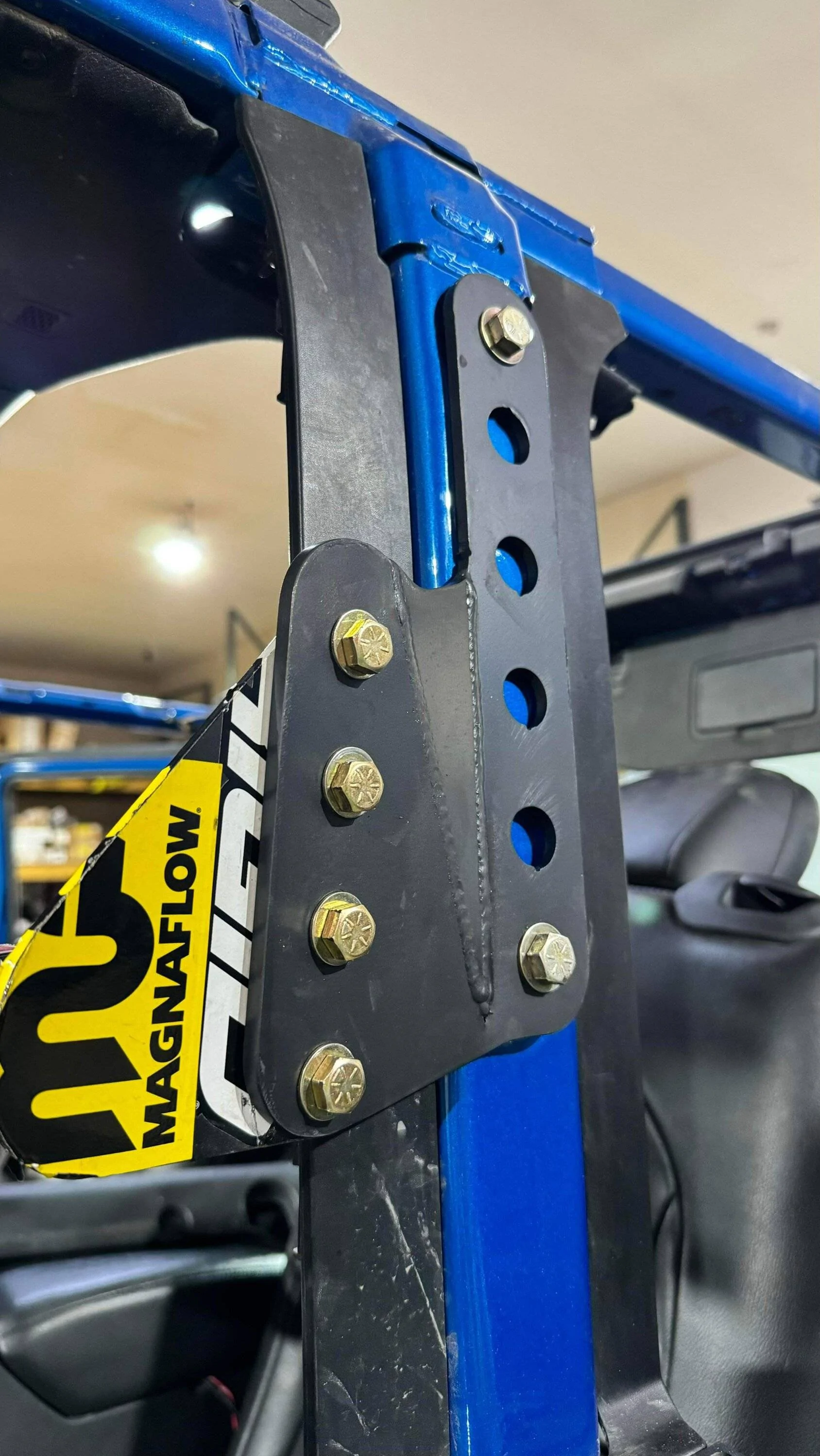

Got custom brackets made for a JKU harness bar to be custom fit. It’s AWESOME. just get a JKU harness bar from Rock Hard 4x4 and then call Liquid Iron Industries in Berlin, NJ to buy a set of their custom brackets.
