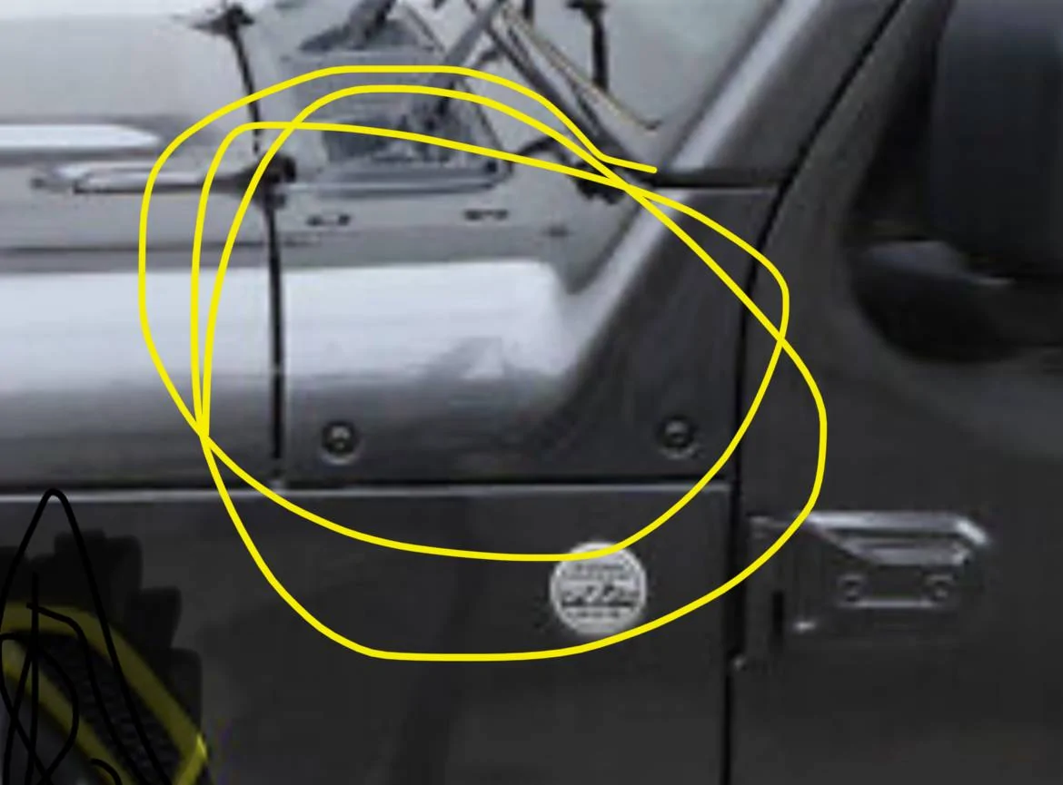

Hi! I recently bought a 2021 4door Sahara with the one touch top. When I bought it, it had a full roof rack installed. We removed it because we don’t need it but the holes that it was installed with are now empty and I was wondering what screws go back in those spots. I’ll attach a picture of the holes I’m talking about.

You’ll want to use the stock fasteners. You can go to the parts counter at your local dealership, or just ask Benny @AllMoparParts.com to mail them to you.

I second getting with Benny @AllMoparParts.com He got me fixed up and delivered within a week, same bolts. Been a while and don't have the part numbers with me.

Thank y’all! I’ll reach out and see if I can get them from him!

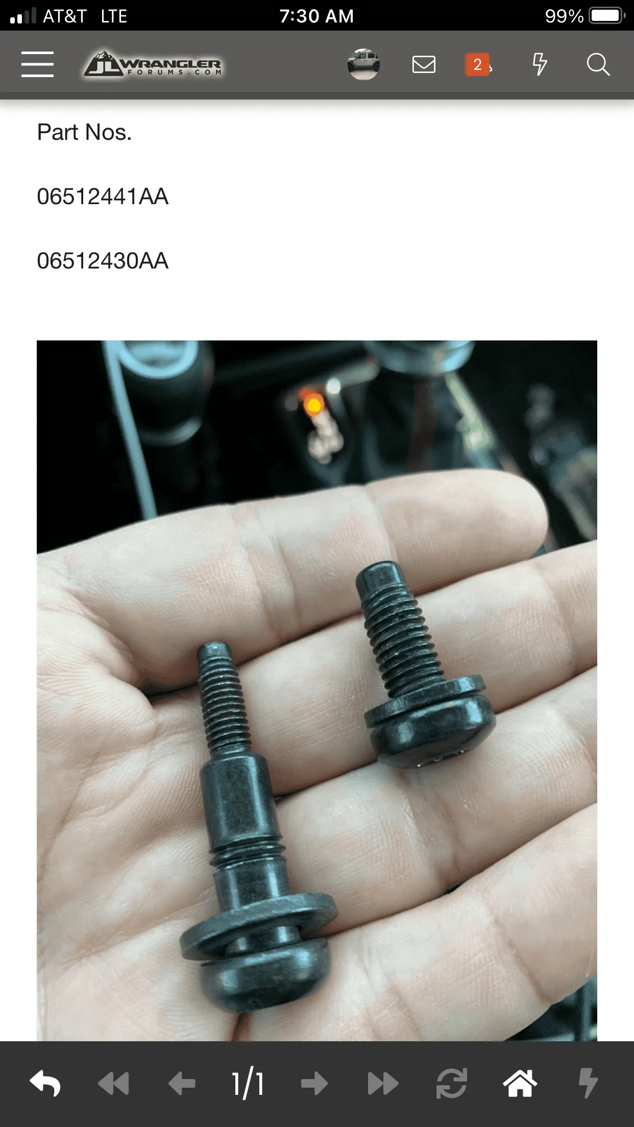

☝☝☝ These are correct thanks @Terry R
If you need any assistance please let us know!
- Benny
