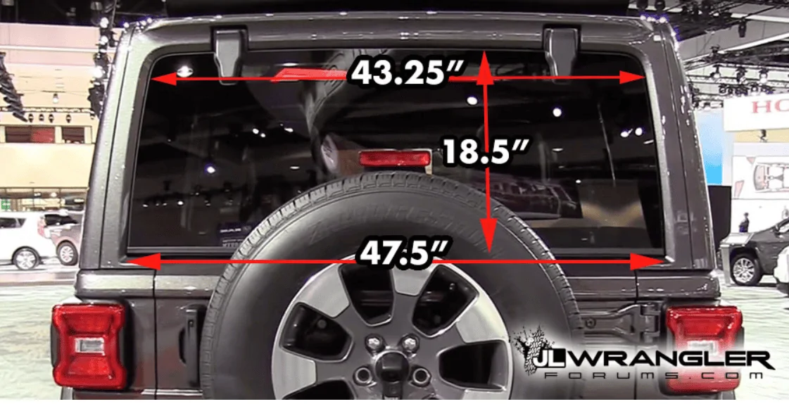

Hey! Ive got a random ask... can anyone tell me the width of the opening on the back of the hardtop? (the inside part where the glass hatch is). Preferably on a 2018 jlu, because apparently that matters according to the dealership... I'll spare y'all the story:facepalm:. Thanks in advance!

https://www.jlwranglerforums.com/fo...ons-measurements-cargo-trunk-rear-seats.2258/
Perfect, thank you for this! I got a replacement top from mopar (According to the dealership) due to my original top have a crack from the factory. They used my old windows, sides and back from my first top, and I have had lots of noise issues since the replacement. (Sounds like a case of bottled waters) They’ve replaced seals, shocks, told me my spare is too heavy, etc. I’ve put silicone on all weather striping/rubber after reading some posts, still the noise is there. After pinpointing the noise to the back glass area we thought maybe we should measure mine against a hardtop from the factory. We measured a 2020 and there was a 1/2 inch difference...mine being wider. Maybe that seal is not fitting right creating the noise? That’s the only thing we can come up with.
