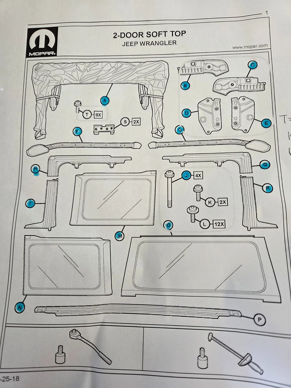

Hello! New to the Jeep world and looking for help. I bought a soft top off Facebook marketplace. I have watched several you tube videos on how to do and feel confident. What I'm not sure about is if I got all the necessary bolts to install correctly. I have called Mopar and several dealerships, and not getting any luck. I think on this forum, I found a parts list page and that is why I am questioning the quantities and types. How can I be sure, first that I have the right diagram, and two, if Mopar can't help me with the bolts, then who can?
It is a 2023 Wrangler 2 door JL. I have 4 of the J bolt, I have 8 of what I think is the L bolt and 6 of either K or T. So I'm thinking I need 4 of the L bolt. Just need help with the K and T ones/sizes?
i have attached the diagram i believe to be the correct one, so PLEASE help if you believe to be incorrect. Thanks in advance for any and all help.

Are the door surrounds (H,I & Q,R) already joined together? That would explain some missing bolts...

the "T" bolts should be smaller than the "K" bolts. the "K" bolts are the same or very similar to the bolts that are used to secure the hardtop. if you have any of each of these the smaller ones should be T and the larger ones would be K. hope this helps. and yes you'll need 4 more L bolts. and if you dont have a torque wrench just hand tighten to snug. dont want to crack any plastics.

this also. if they are already assembled then you will be "missing" those 8 T bolts since they are already installed. if you dont have the K bolts and you had a hard top then see if you can use two of the hard top bolts for the K bolts on the corner brackets.

i figured out that those are already connected with the S bracket. So good on that. Thanks

yes they are, figured that out after my post, but thank you
