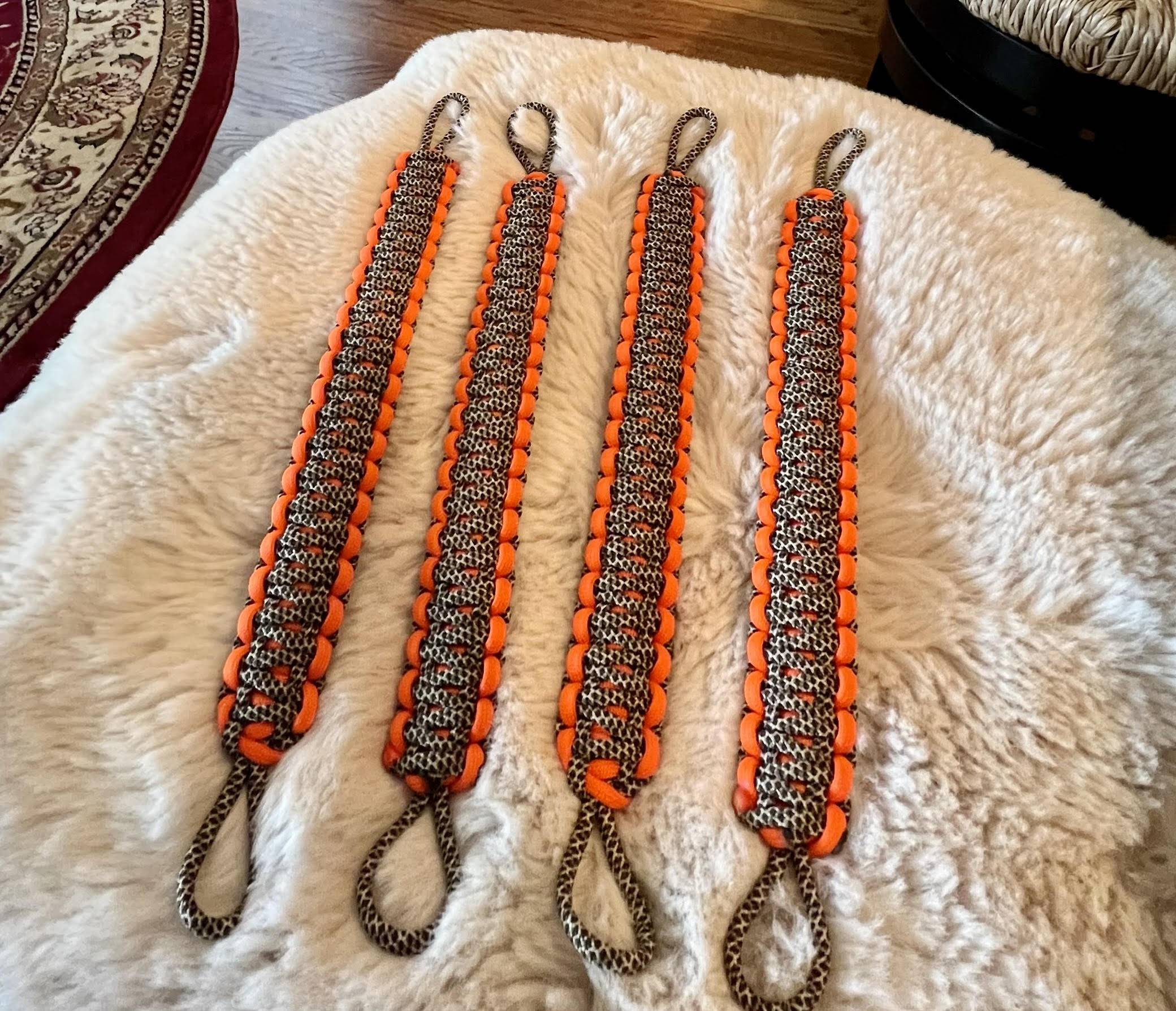

One option I’ve found is a small seller on Facebook that the JEEP 4XE Fans group frequently share is Tieri Paracord Innovations. You join the group then PM the owners, telling them what you need and what color. They’re very responsive and help guide you to pick out exactly what’s needed. I haven’t bought mine yet, but I’m thinking of doing it as soon as I figure out which screws/bolts I want to mount it to in order to choose the right length.

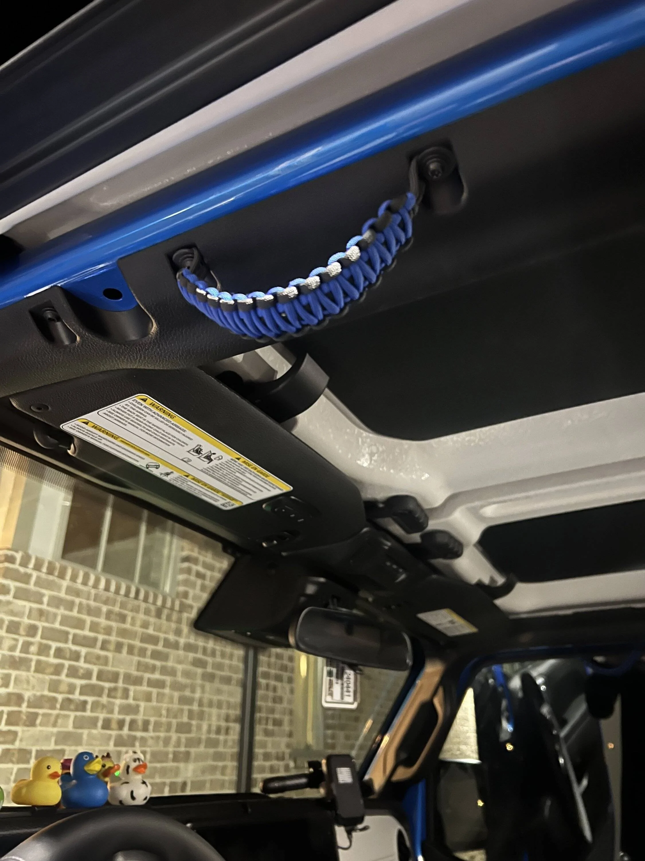

Mine come today, but they definitely are useable. I never found any solution to bolt into the empty holes that the soft top uses, so I got shorter ones that fit into the two screws. That shouldn’t cause any issue, and they’d just get pushed outward to the window if the airbags deployed. The problem is with the old ones that wrap around the bar. The Mopar ones actually wrap around only the outside and over the top, fitting into a couple screws but they have to be placed under the plastic, which means the airbag cover needs to be removed making it a professional install. I’d think they’d be much more of a barrier for the airbags than these are, so I believe them when they say they’re fine.

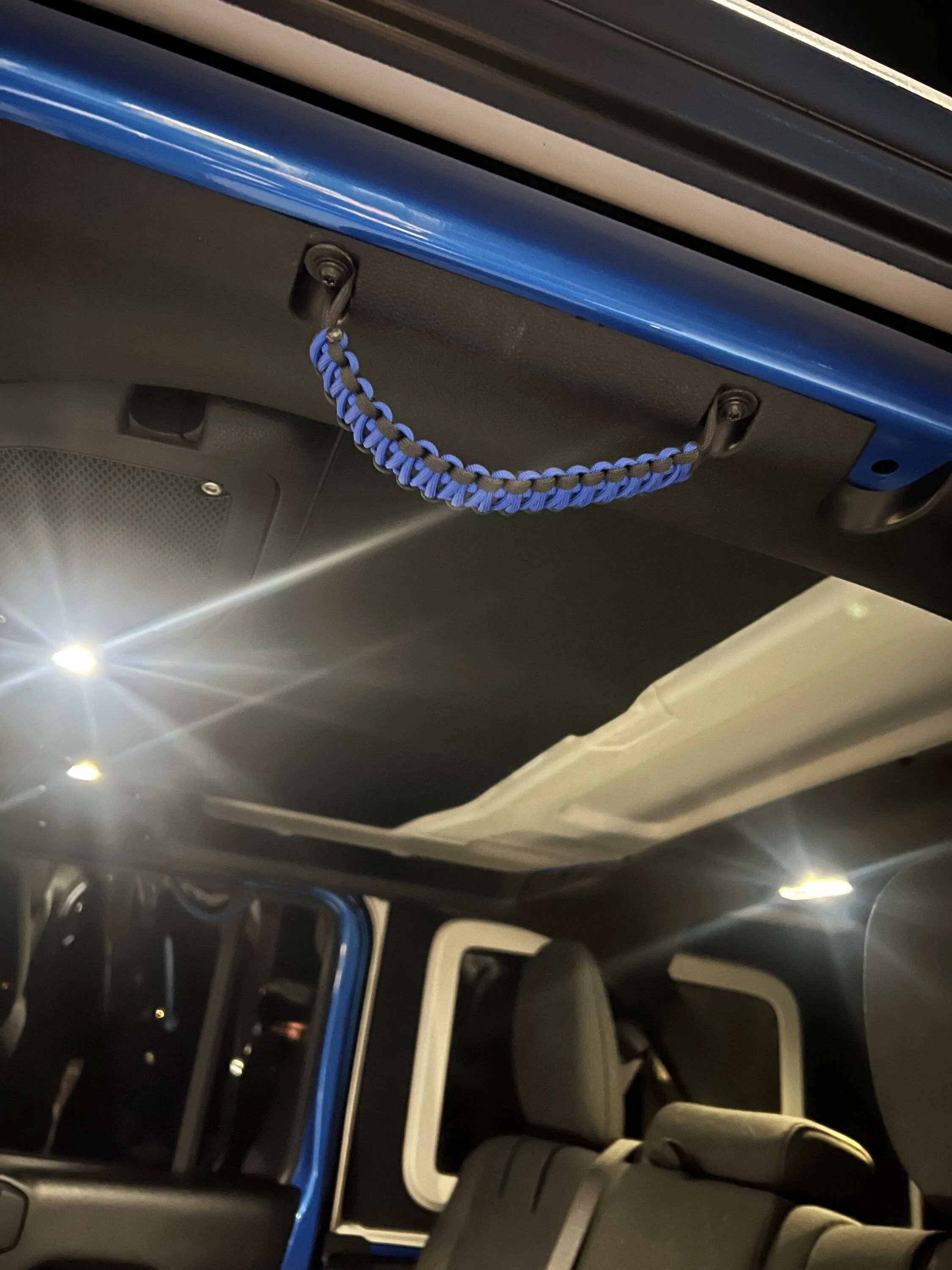

They fit fine with the 2024 with airbags. I used the screws instead of the bolts because of the lack of hardware. Here’s what they looked like once installed:
This to me has obviously seemed like the no Brainer with the 24, use those two bolts on the airbag assembly. If it is the easy though (as in by using only those two bolts the airbags remain fully functional) then why haven't all the grab handle makers made them like that? They look great btw

Looking at how the Mopar ones are installed, they’re likely a lot more secure and can hold more weight. That said, these ones are pretty firm and serve their purpose if installed correctly so that the loops are completely under the washer of the screw. If you have to one touch or the soft top, use one or both of the bolt spots, and I’d imagine it’s a little stronger. I also found this solution:
This guy has a similar product he made and has suggestions on the mounting listed in his comments. I’d probably use black hardware though.
