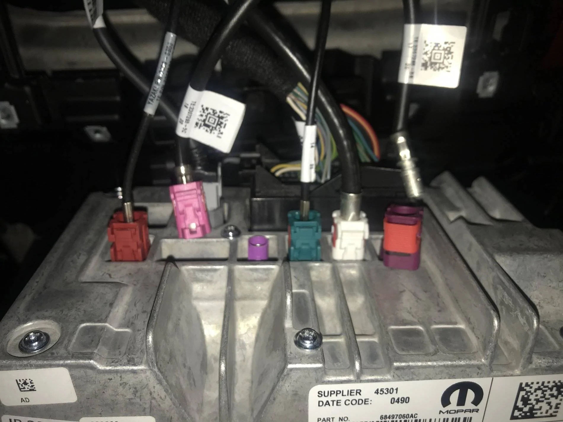

Those pink and purple connectors are fakra D , GSM cellular connections, the JL has two inputs, 'we want robust communications' but disconnecting them only degrades the signal, it will still communicate. So into the head unit....
Jeep Wrangler JL Anyone enjoy a level of privacy from U connect? 1617404729901

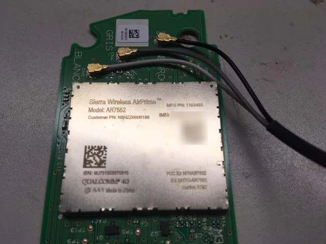

The Qualcomm 4G Sierra Wireless AirPrime card, FCA's little tattle teller....
Removing this card will not allow a GPS signal to feed the nav, so they have embedded the 4G with the GPS thru the card, ok let's disconnect the antenna feed lines and see what one is only GPS....
Leave 'blanco' installed and remove the other two.....Wa-La, no more connection to mothership...

Needs more testing, I'll have to disconnect the antenna leads again, maybe with both internal and external antennas disconnected it might not communicate, it caught a weak signal in town.....
Sorry to wake the dead thread, but do you have any update on your experiments?
Would love to be able to take my jeep off the grid if SHTF. Would it be possible to put the non-blanco wires on switches so they could be disabled more easily and/or routinely, or would there be too much signal loss?
